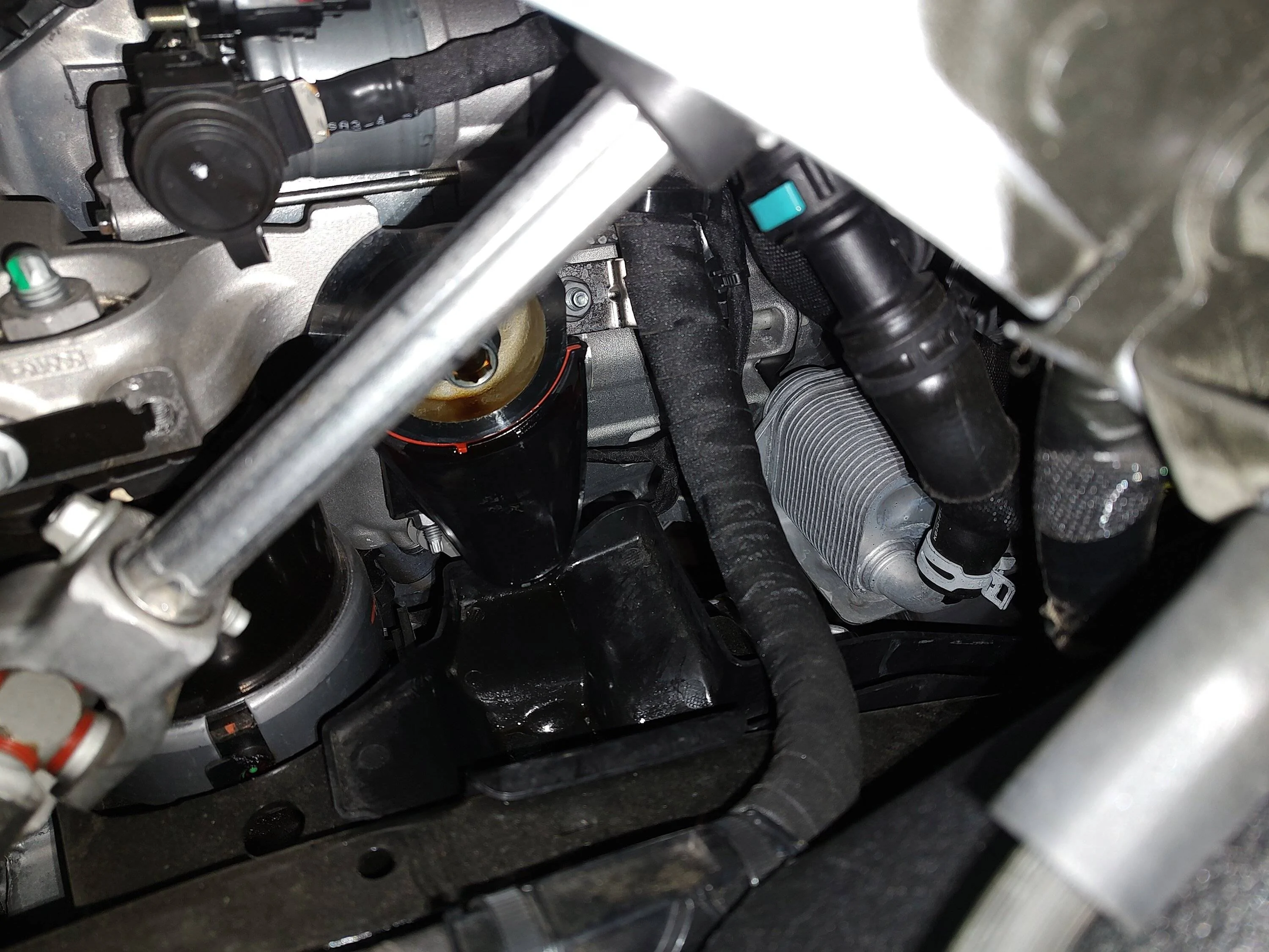

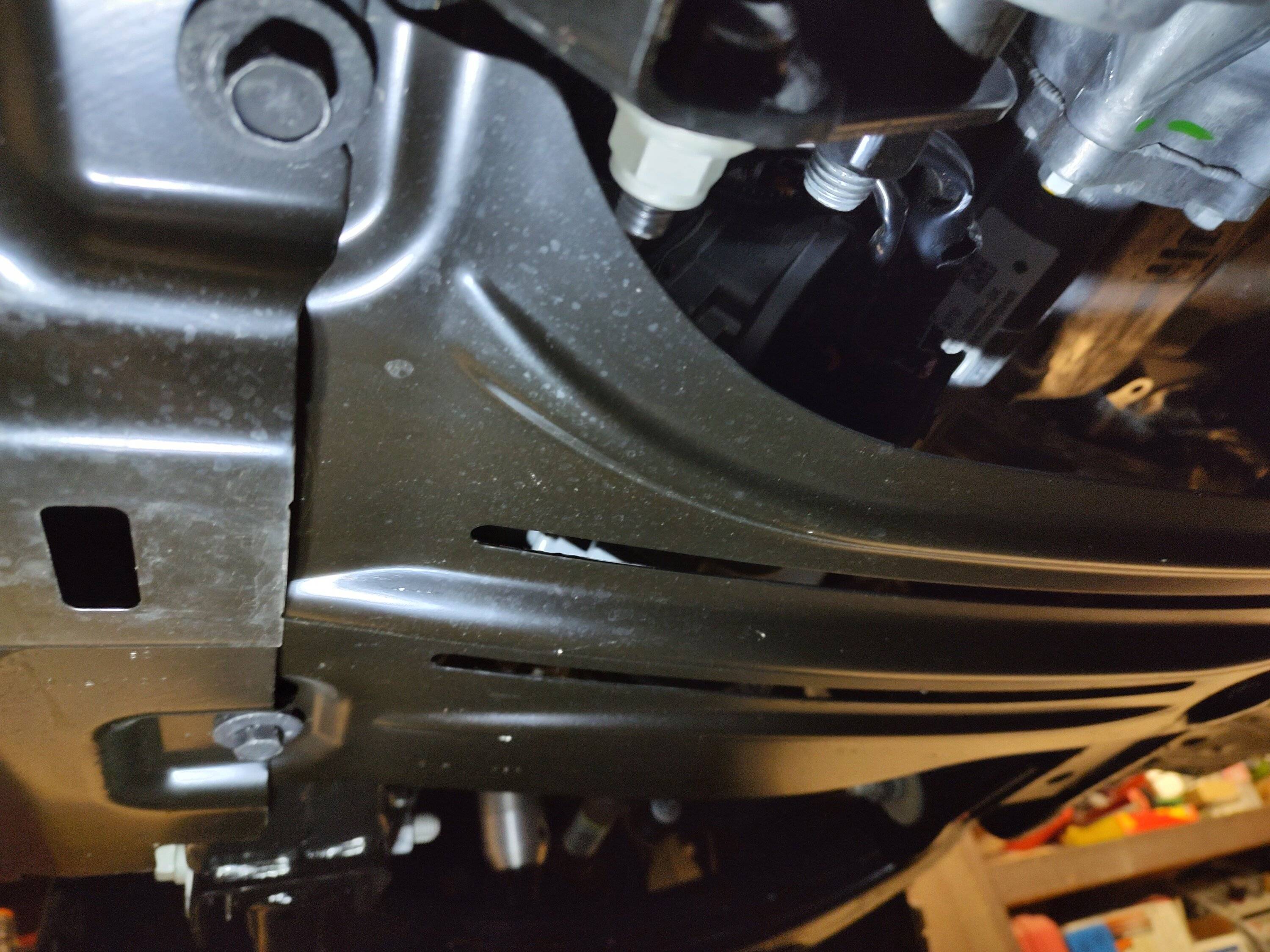

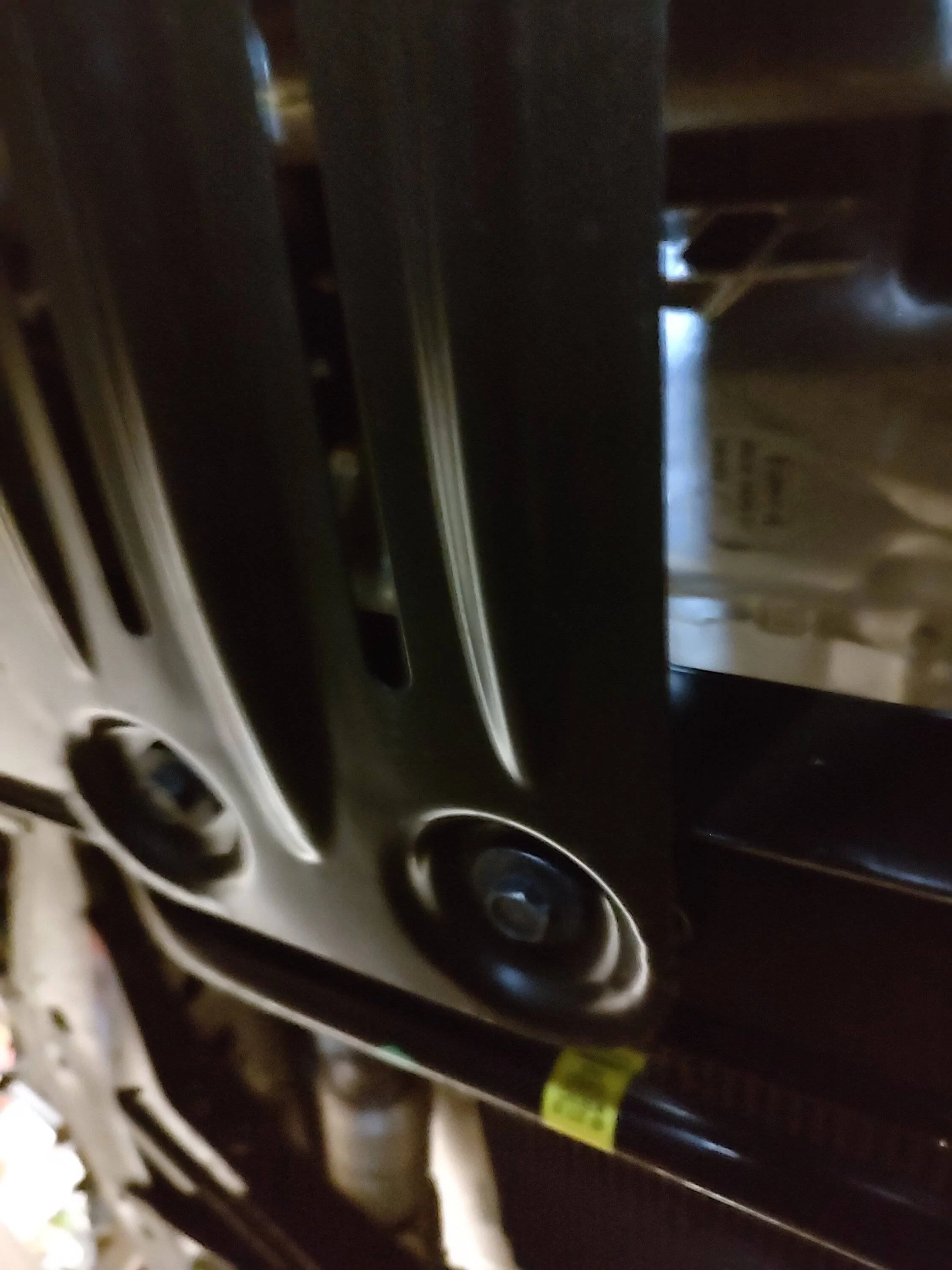

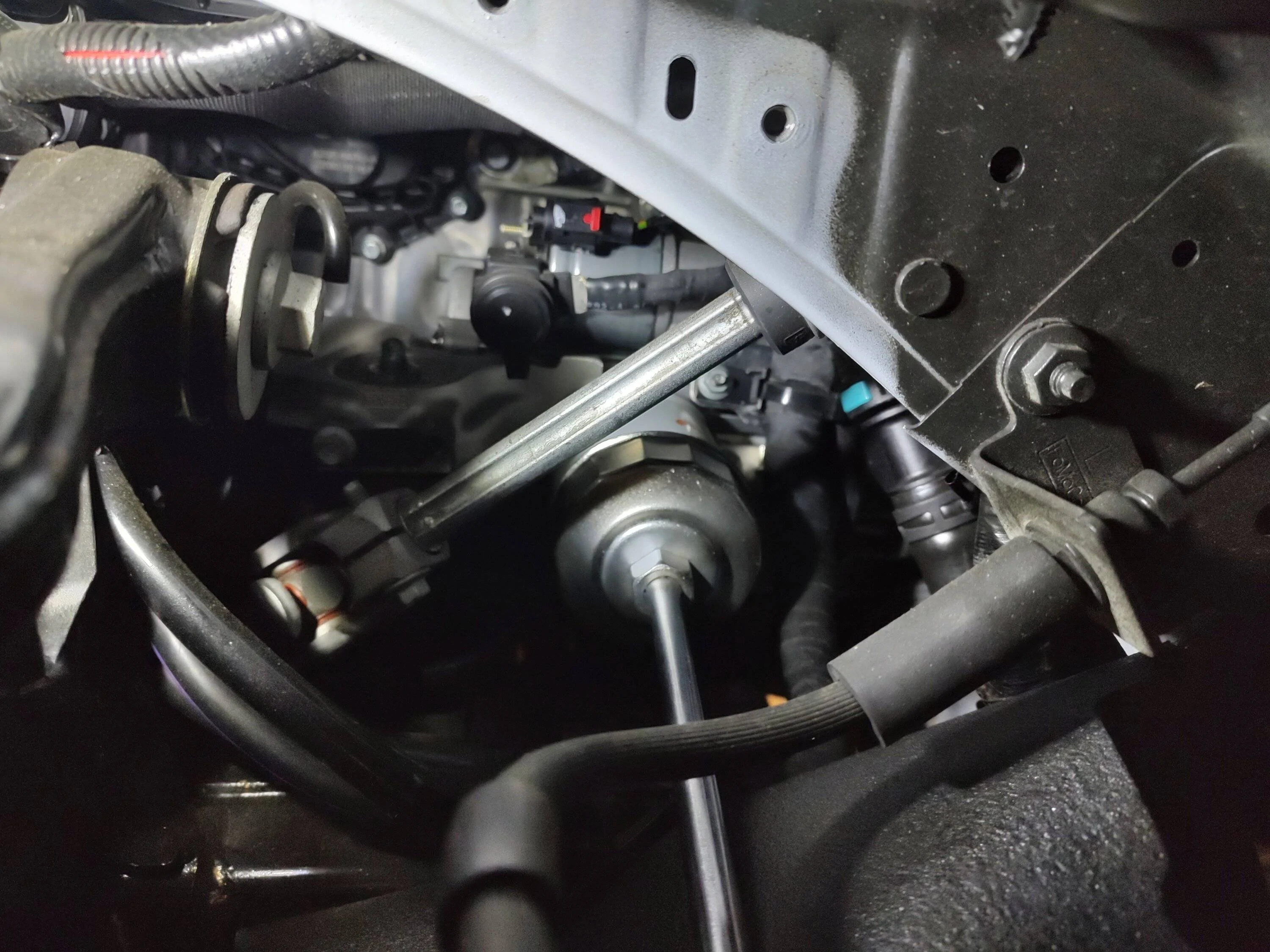

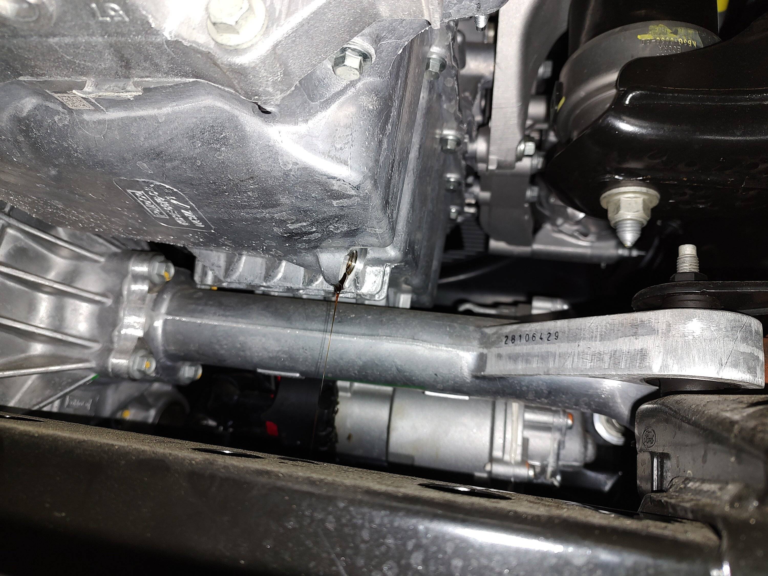

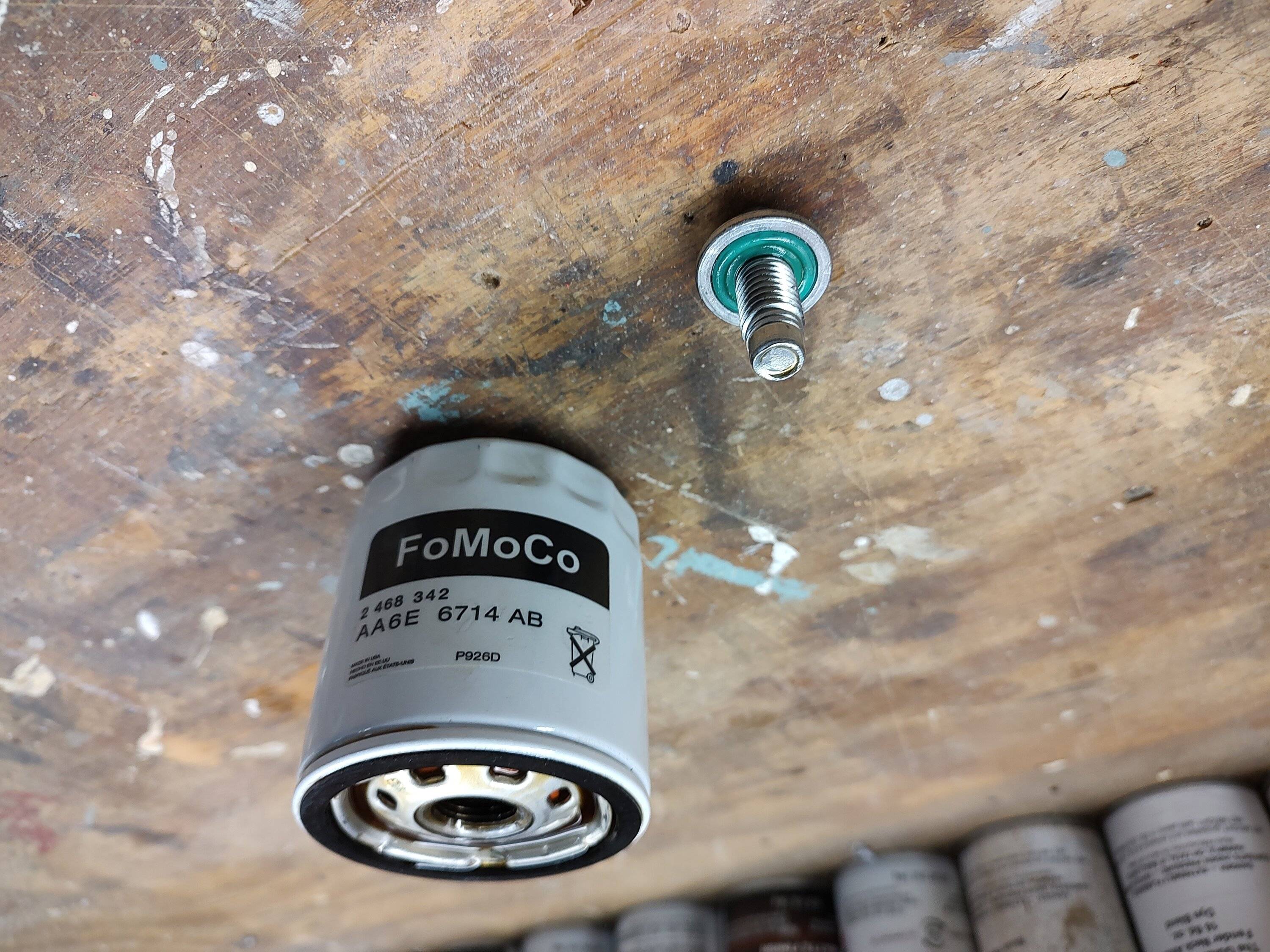

Oh the joy of the oil change.
Well doing it right anyway.

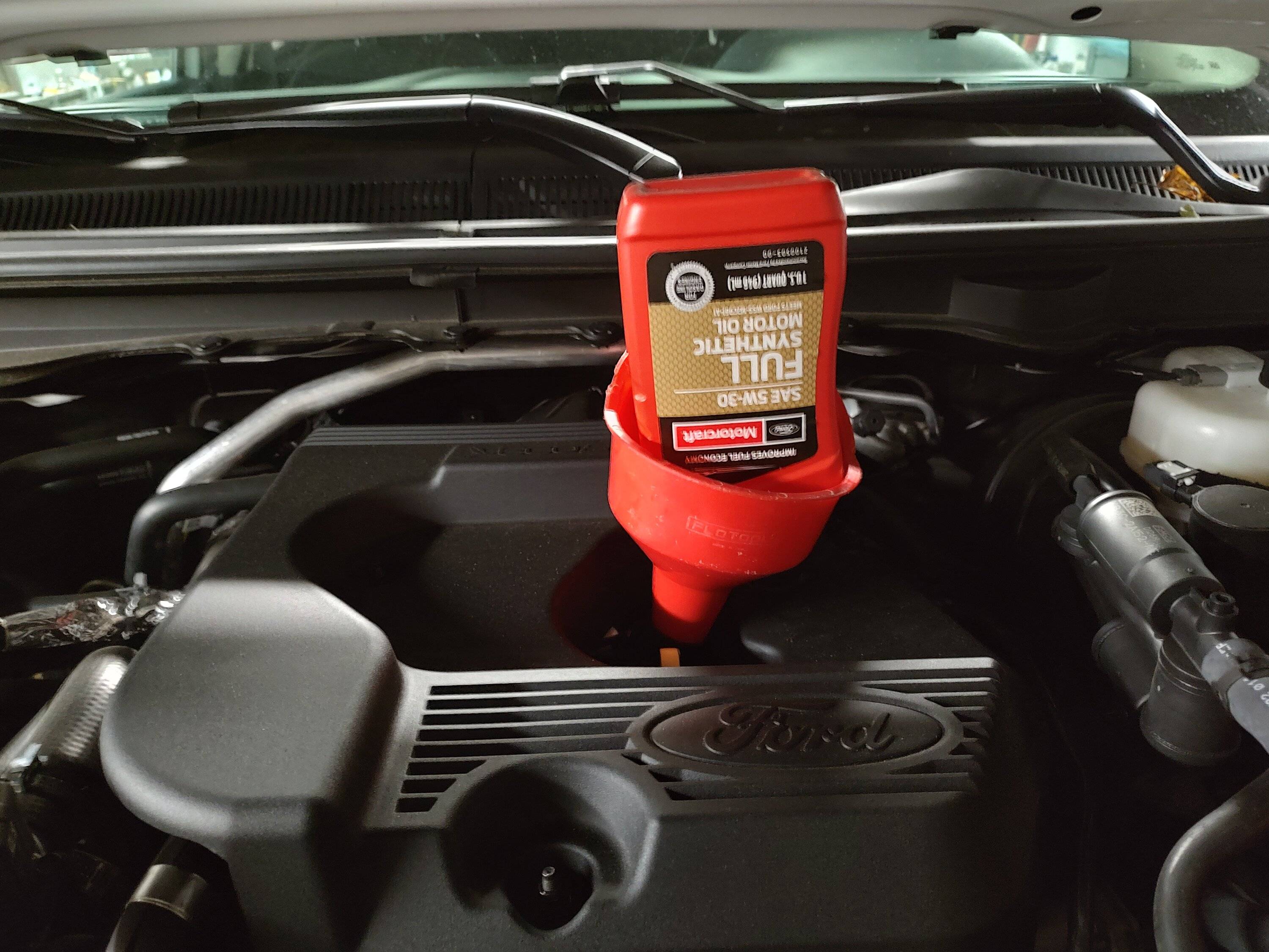

Just changed oil on my 2021 Lariat and was a pleasure this morning. Reasonable weather temp.

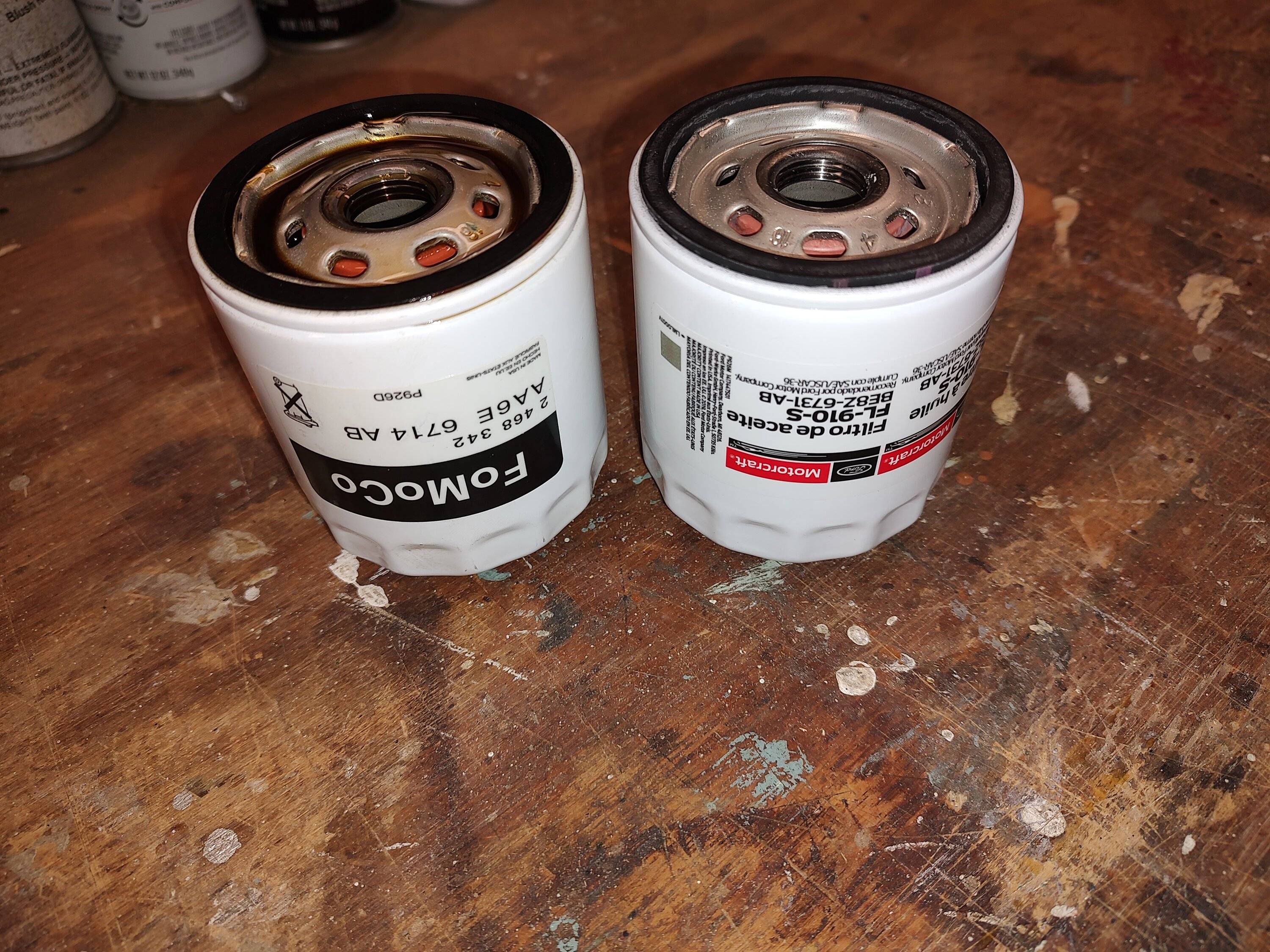

No rush and had everything I needed: Motorcraft Full Synth 5W30 and an Motorcraft FL-910-S filter.

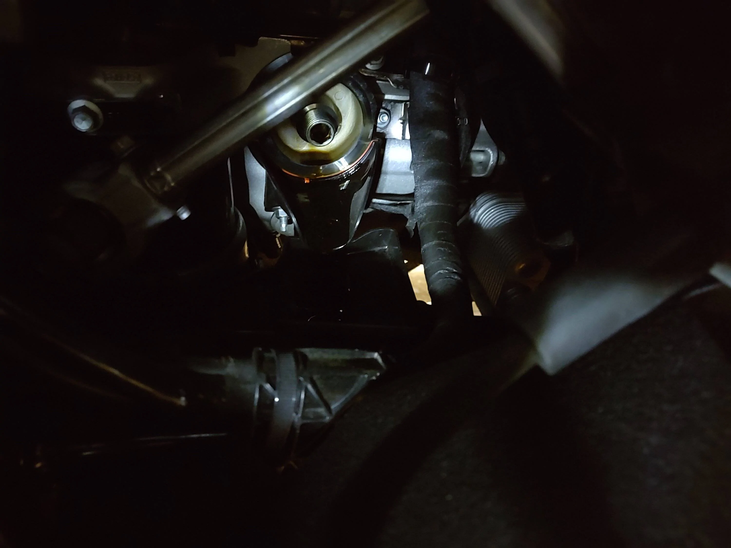

Still find it a trip that Ford made a catch and channel for the oil filter spillage to keep oil off of components when changing the filter. It works quite well and keeps things tidy as long as you have a catch basin under it. Even if you fully drain engine until no dripping; when you pull your filter you will get some spillage - hence the catch basin channel.
Full synth oil...overkill....maybe but I feel better using it.
