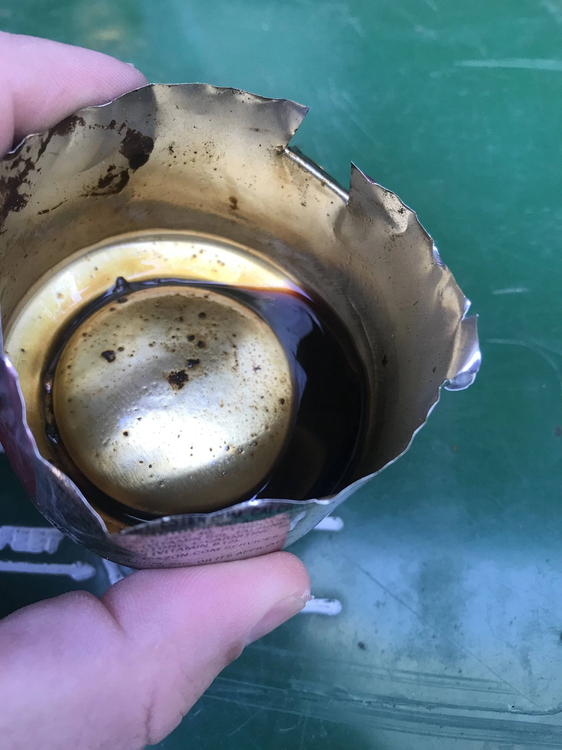

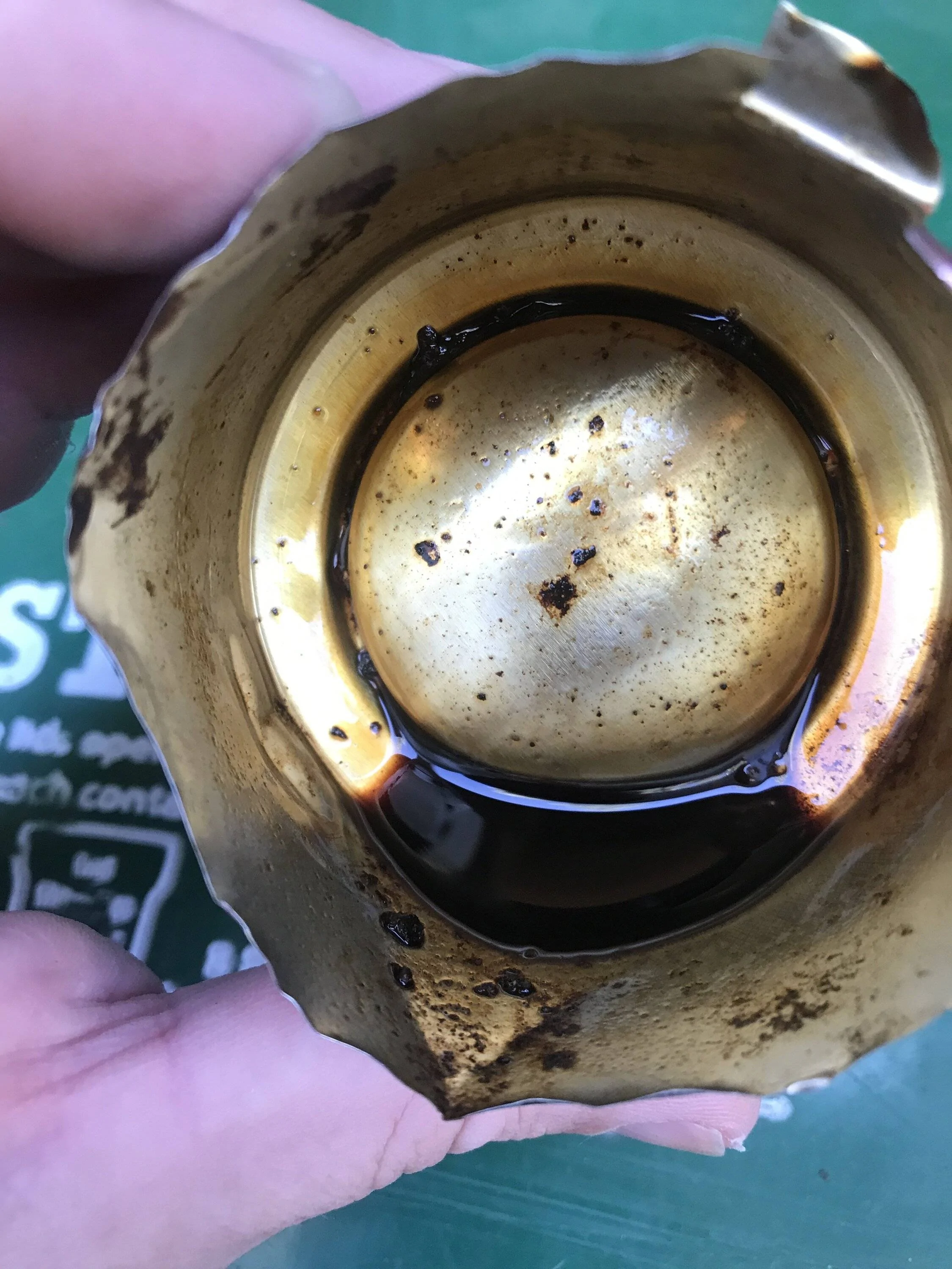

New update. Hadn’t cleaned out the can in a few thousand miles (67k total now) the stuff I pulled out today I swear was like oil. First time it hasn’t been diluted with condensation. See attached photos:
That's what mine looked like after a few months of putting off checking it. What was strange is I dumped it in a solo cup and the next day it evaporated. I was just left with residue in the cup.
