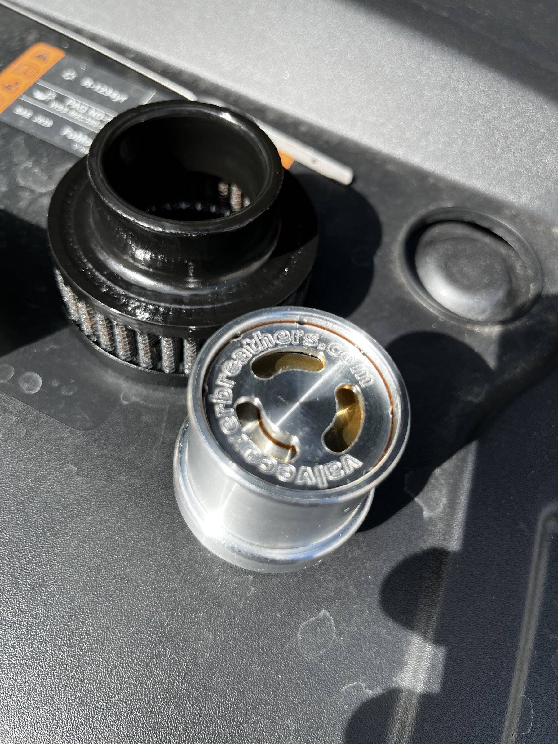

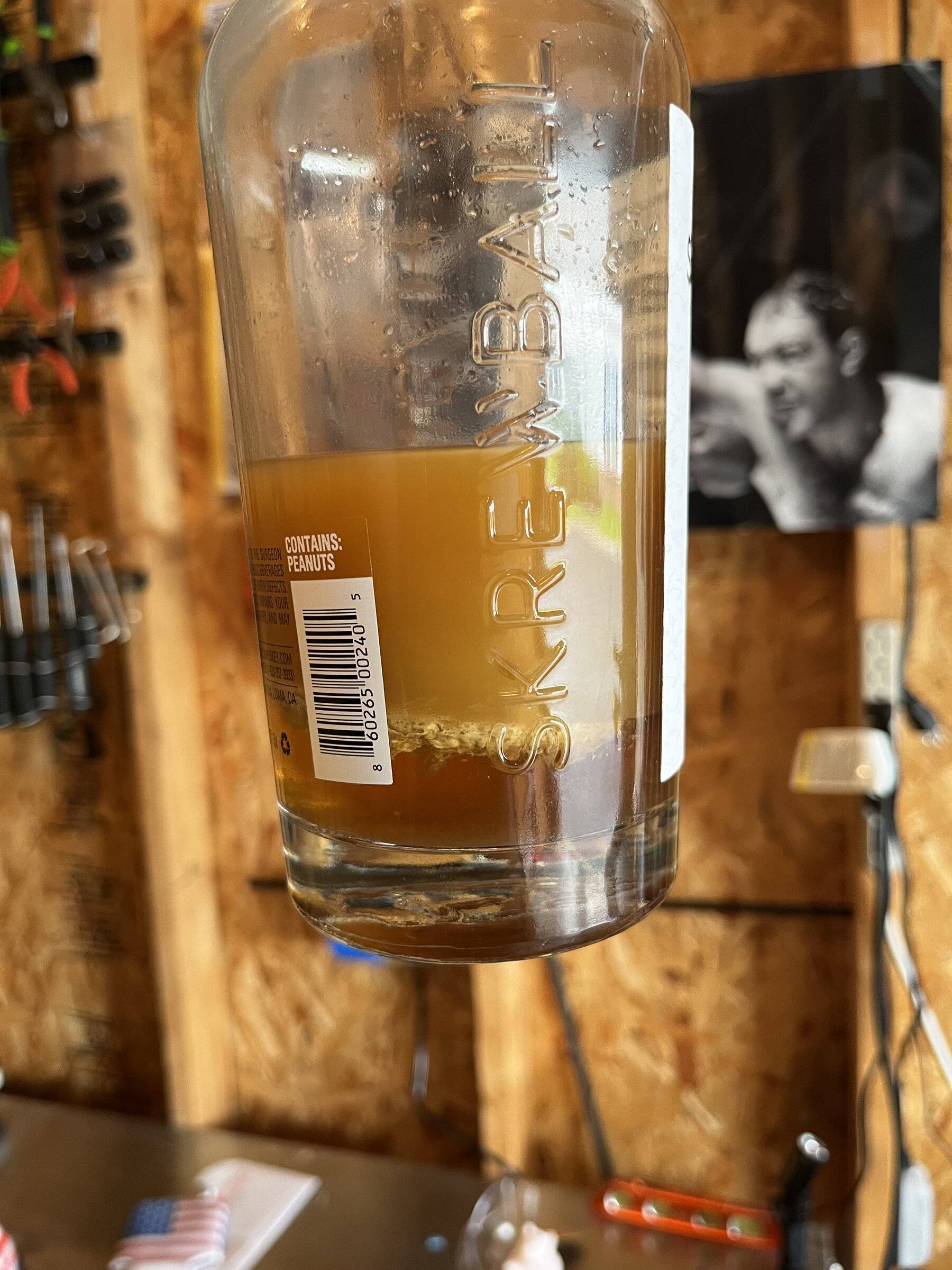

Quick update. No more fuel smell after switching the lines. Also got to dump some iced coffee looking fluid from the can today.
Dr3wDrop
Andrew
Dec 14, 2021
1,140
2,122
OHIO
2021 Lariat Tremor

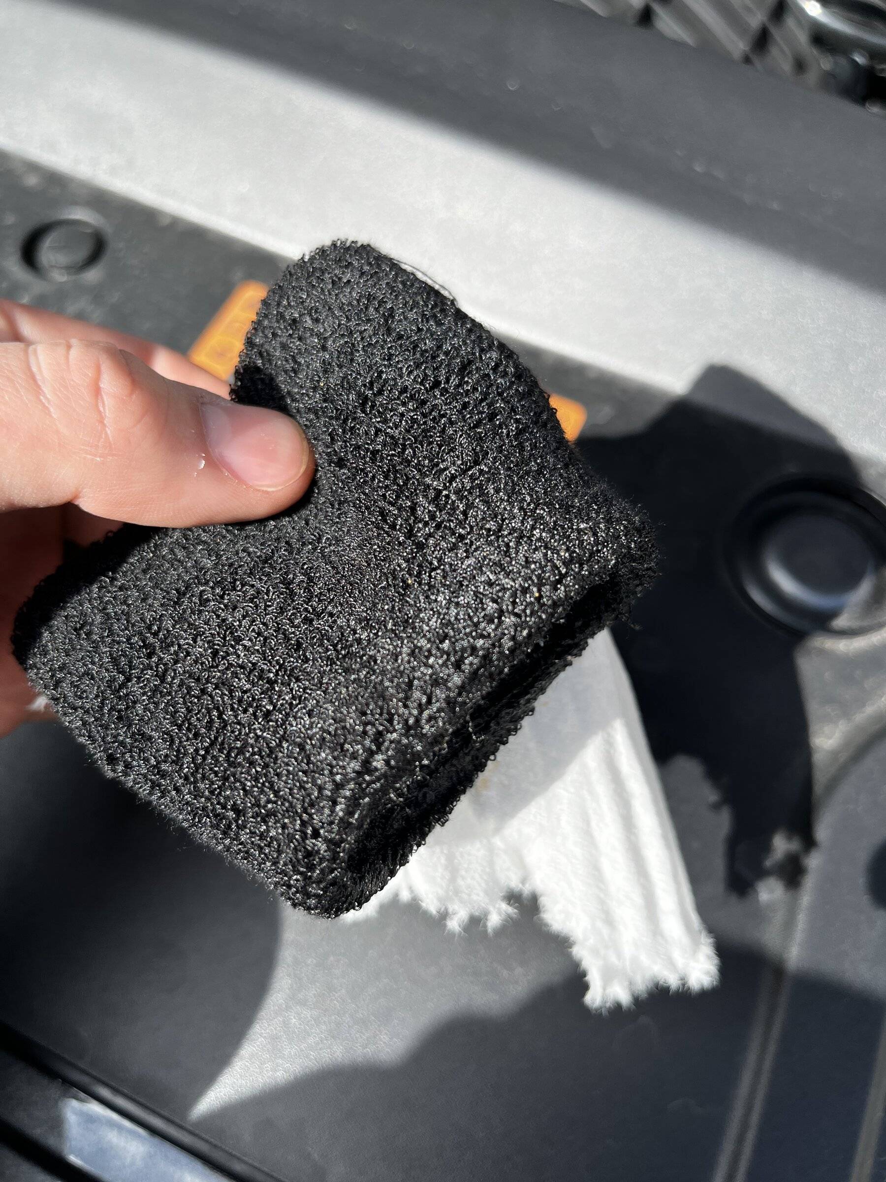

While I was checking in my CC today, I noticed the sweat band on the crank case breather was SOAKED. Wiped everything down real good and put on a new sweat band. Checked the oil and everything looked good on that end.

I just want to report on what the catch can contents look like. Since this is the catch can thread and all. Looking at oil dilution (fuel). Not gonna do any internet jockey oil analysis, etc.
Right now I have mostly moisture, but it's tainted with a little fuel. Mostly smell. Won't burn. Since going to 5w40 Pennzoil Platinum Euro I see very little dilution. But, I thought since a truck application can be comperable to a high performance application due to how the engine is worked, trying what Ford recommended for the RS would be a good experiment. The thin oil our Rangers originally call for is mostly for fuel mileage gains IMHO.
