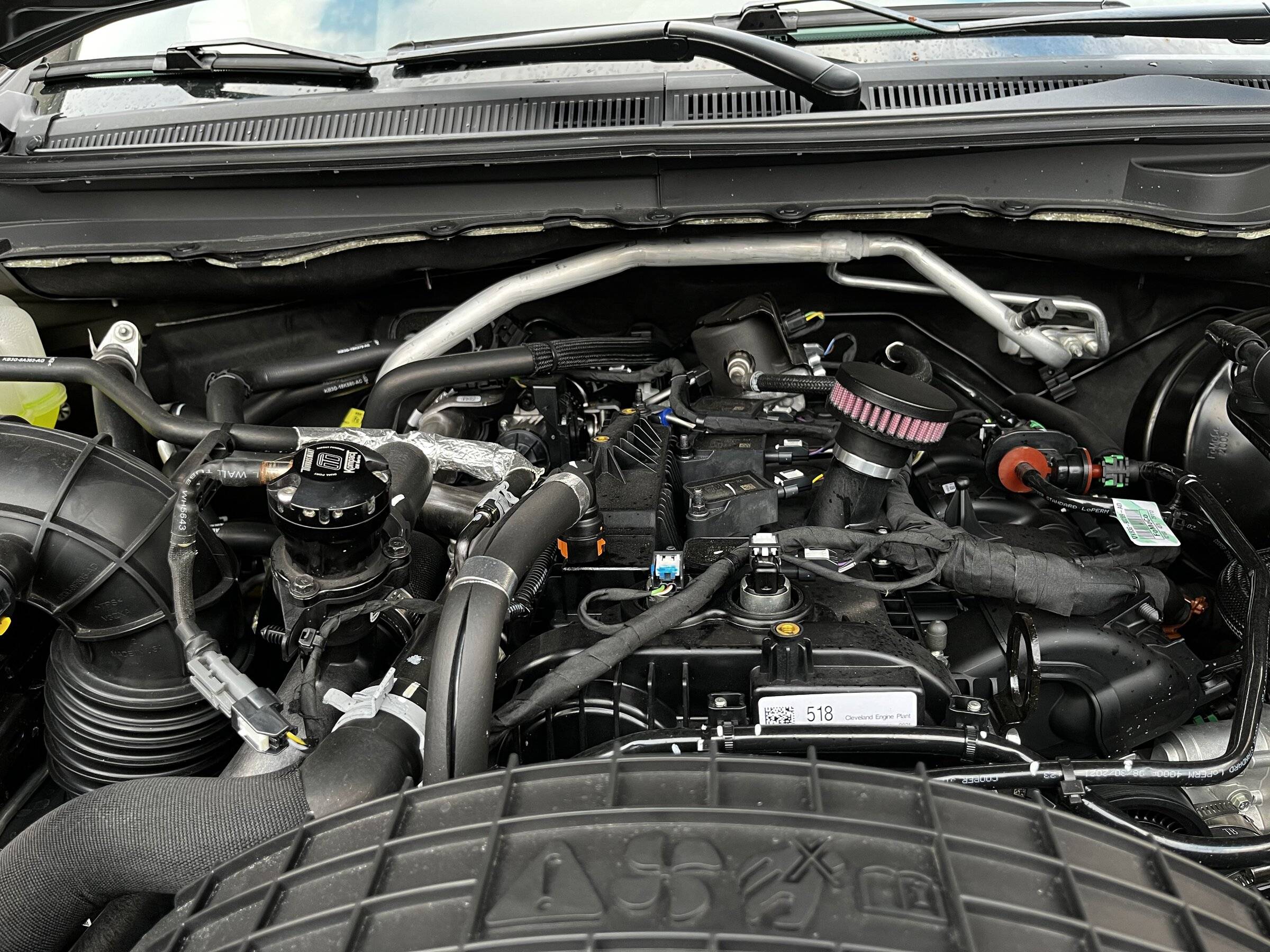

After my catch can install, if that thing fills up frequently, ill add one of these and see if there is any difference!

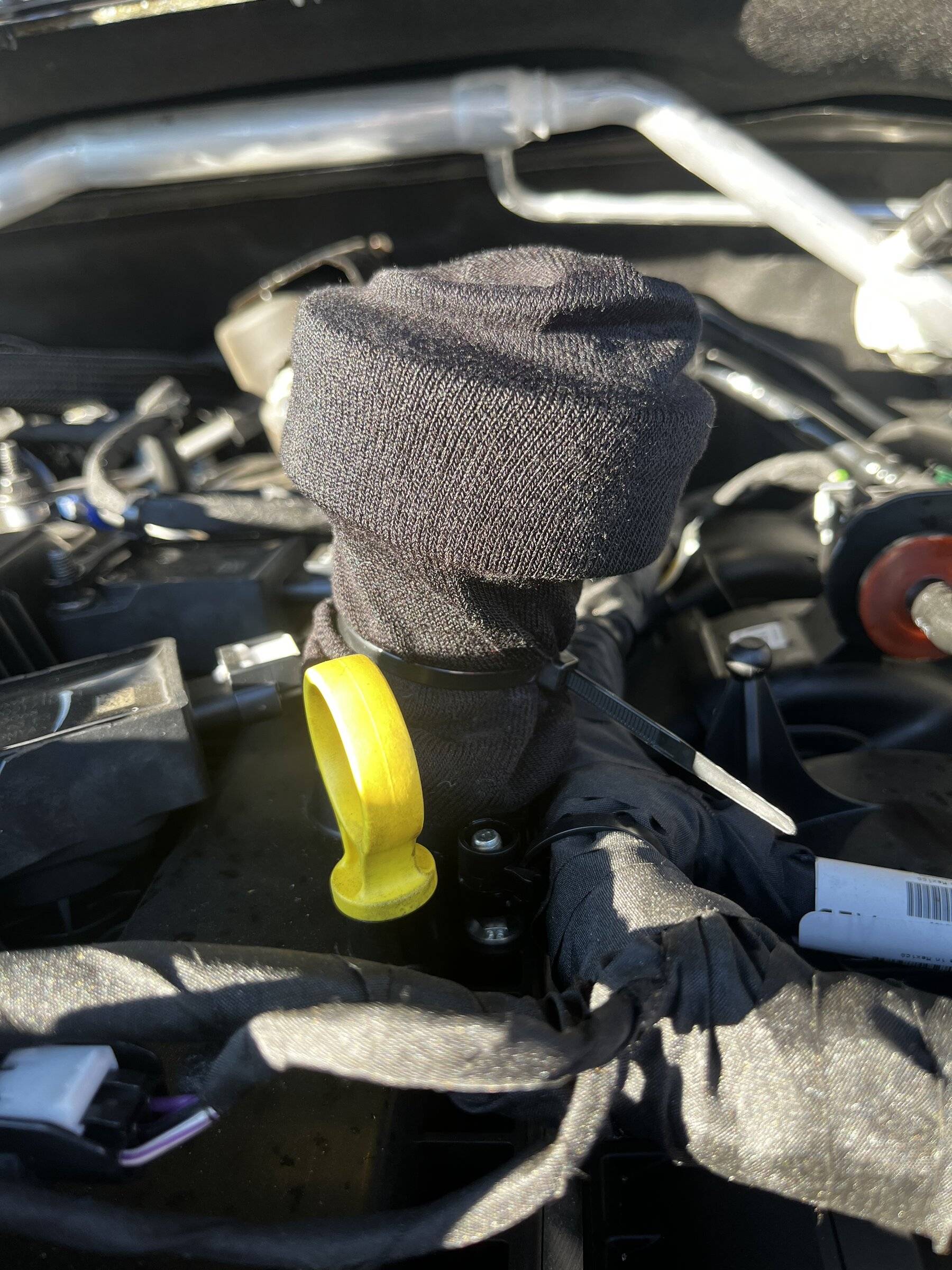

I put a sock over mine because it tends to mist a bit. I change the sock every other oil change, beats buying their new filters..:)
Anyone ever complain about a feet smell inside the truck ?

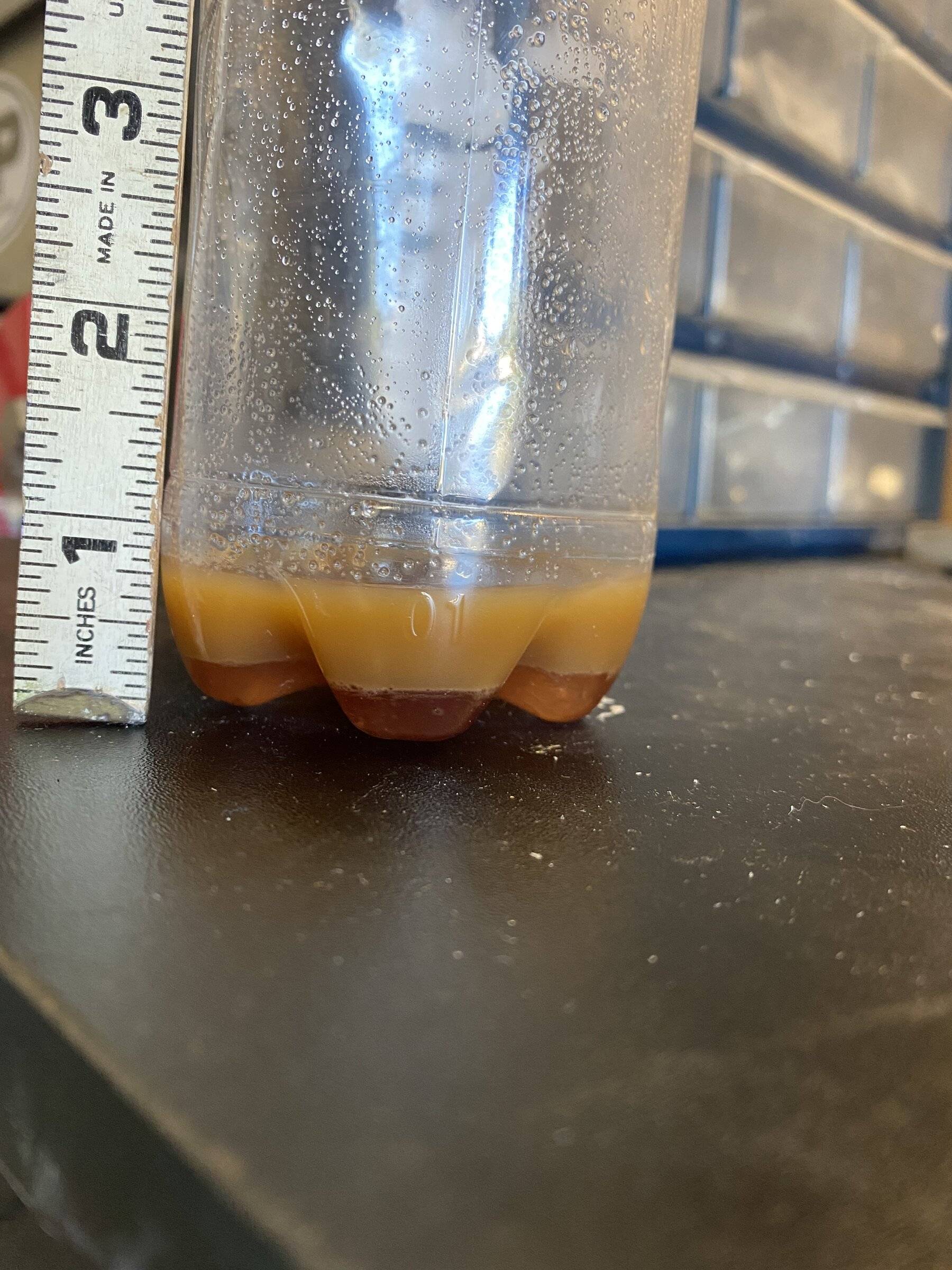

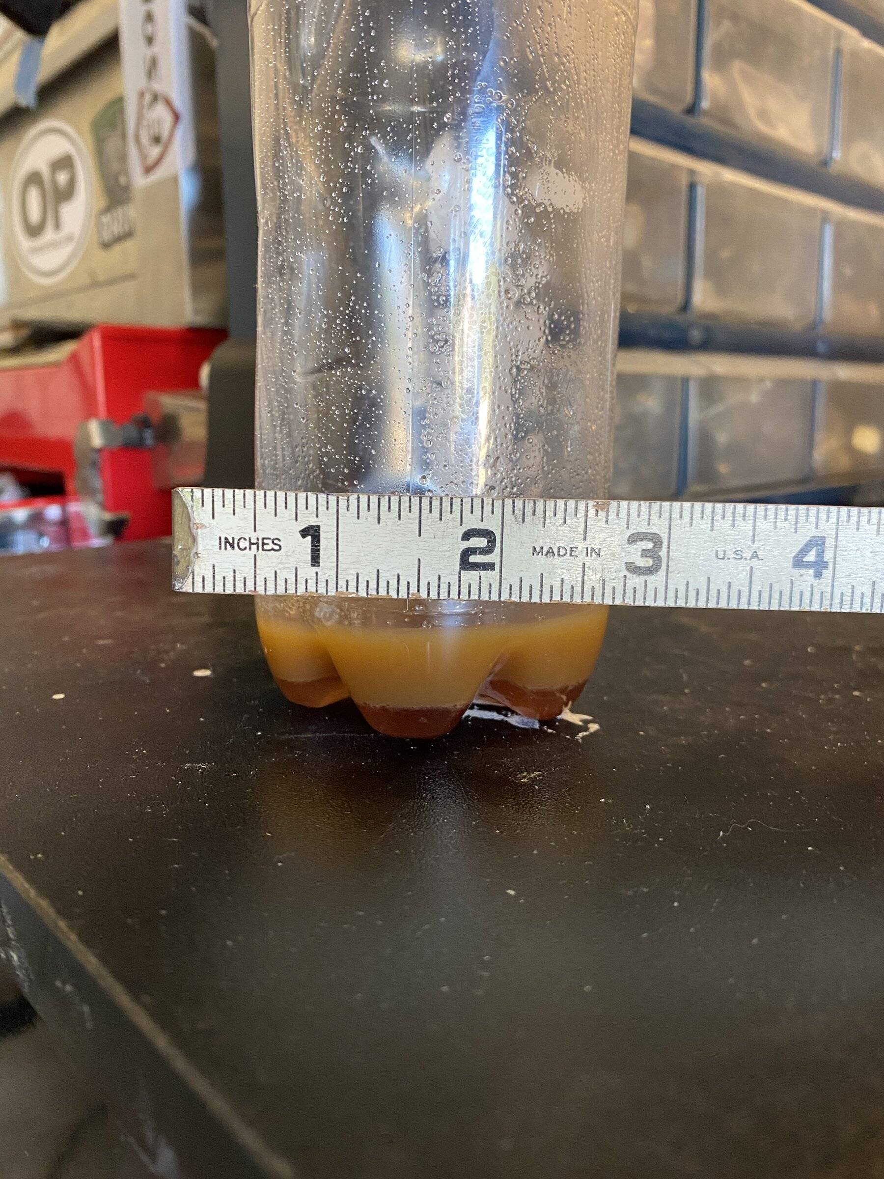

After roughly two full years, I have filled my 750ml bottle with the crap from my catch can. Obviously most of it is water. So… now what lol
Get a new bottle????
I put a catch can on last week. 400 miles later and I poured this out. Only 400 miles.

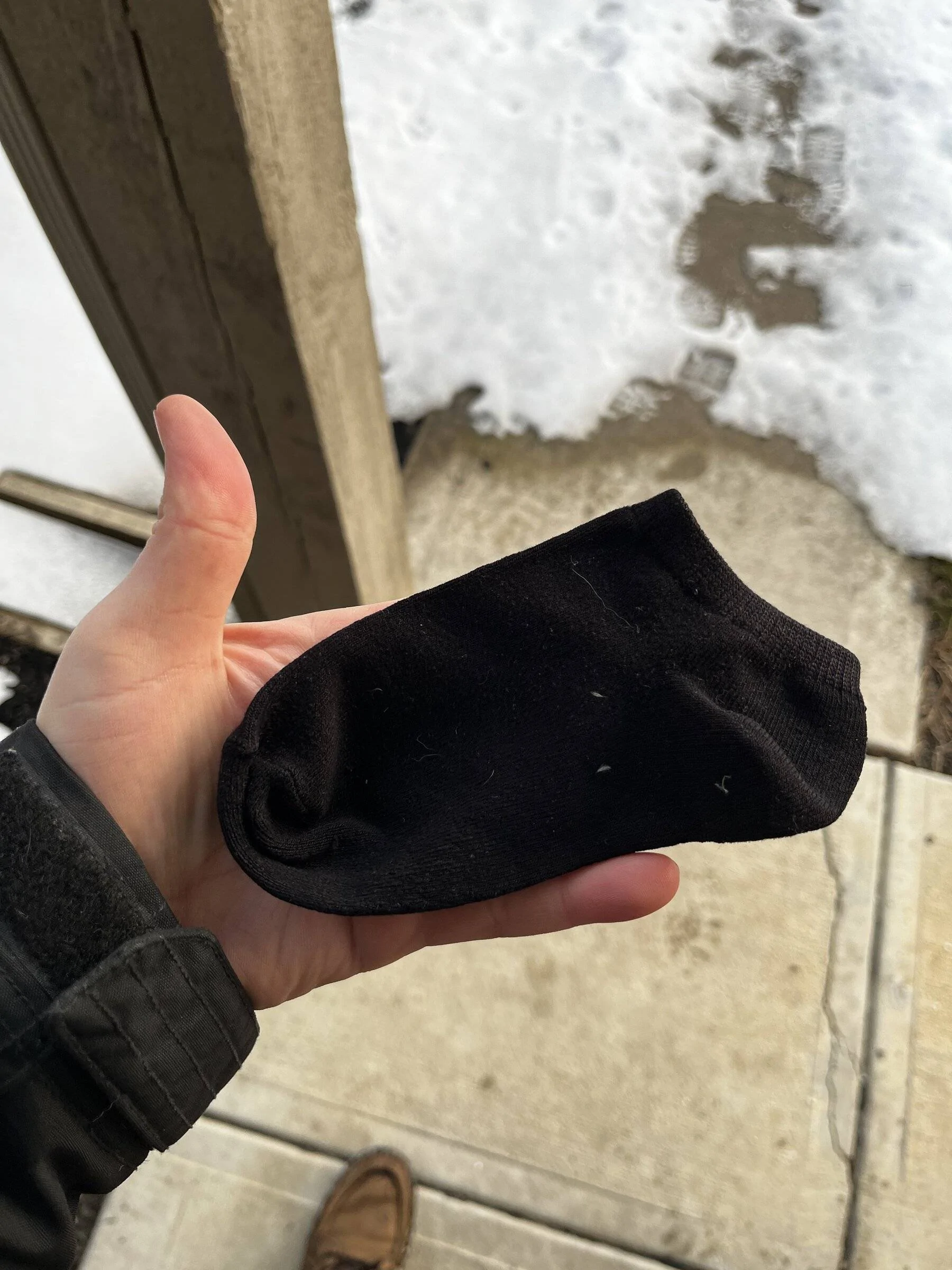

Got this guy installed. It will be interesting to see how it works. There is a little plastic ball inside the housing that seats flat when the valve is straight up and down. The ranger cap is at a very very slight angle so hopefully the ball will stay seated correctly. Stole one of my wife’s socks to cover the filter from other comments on here.

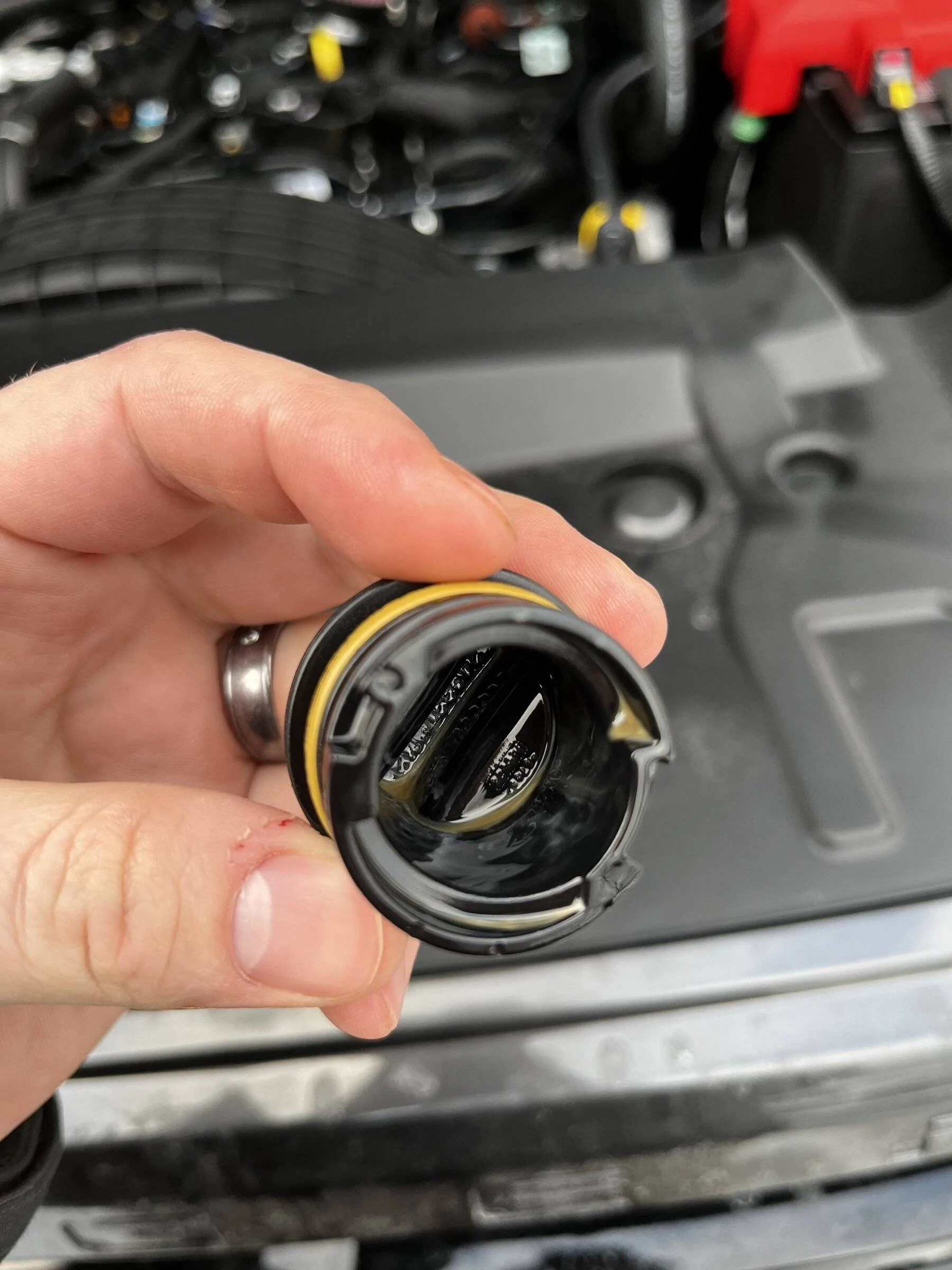

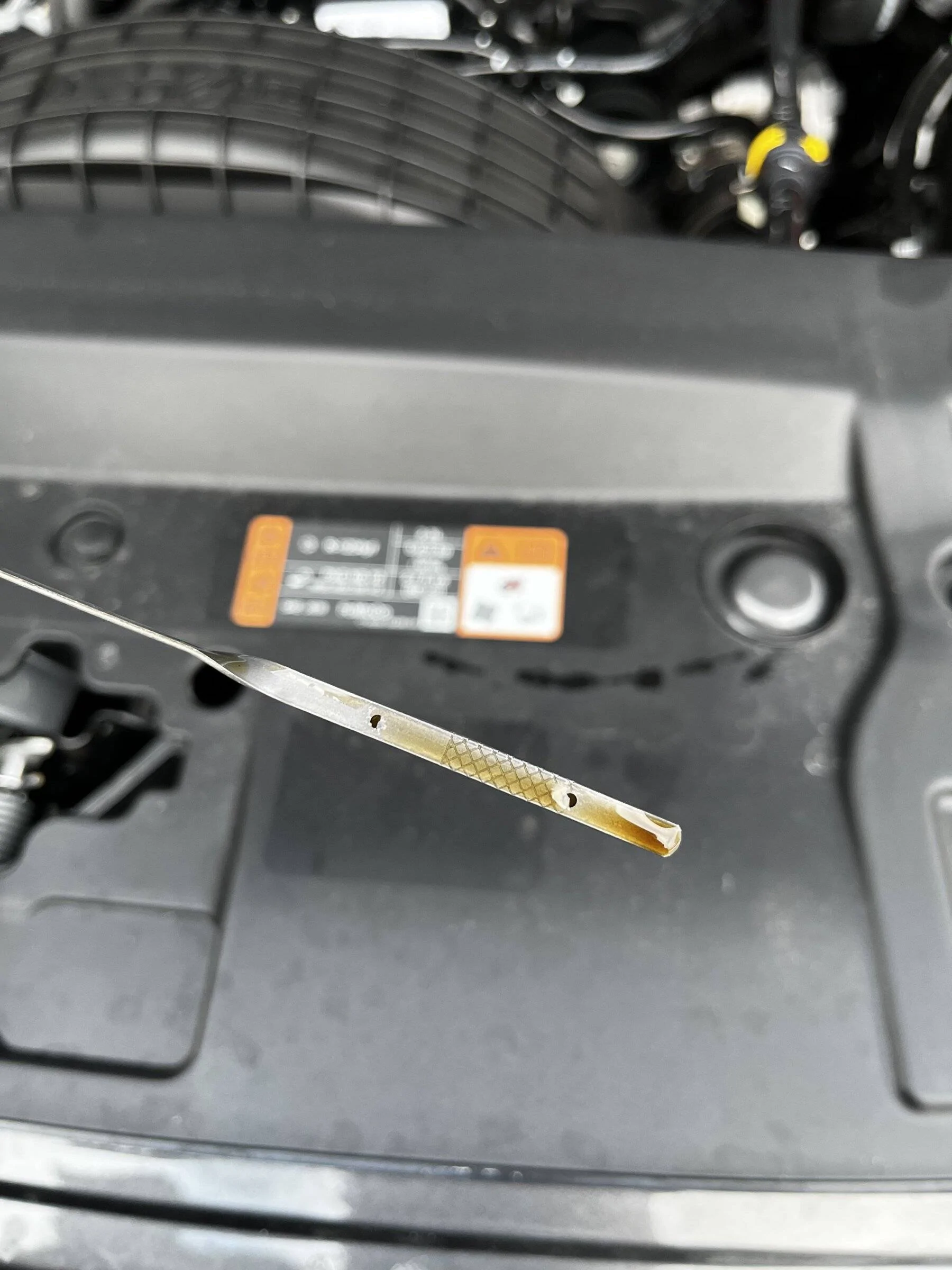

Side note, checked the oil and it was past the hatch marks to the top hole. Smelled like fuel still and the inside of the oem cap had a little milky residue. Oil change was done 600 miles ago and it was at the halfway point in the hash area right after the oil change.
Figured I would re-post this here. Ended up ordering the crank case breather and stuck it on. Still plan on installing my UPR CC when the weather warms up.
