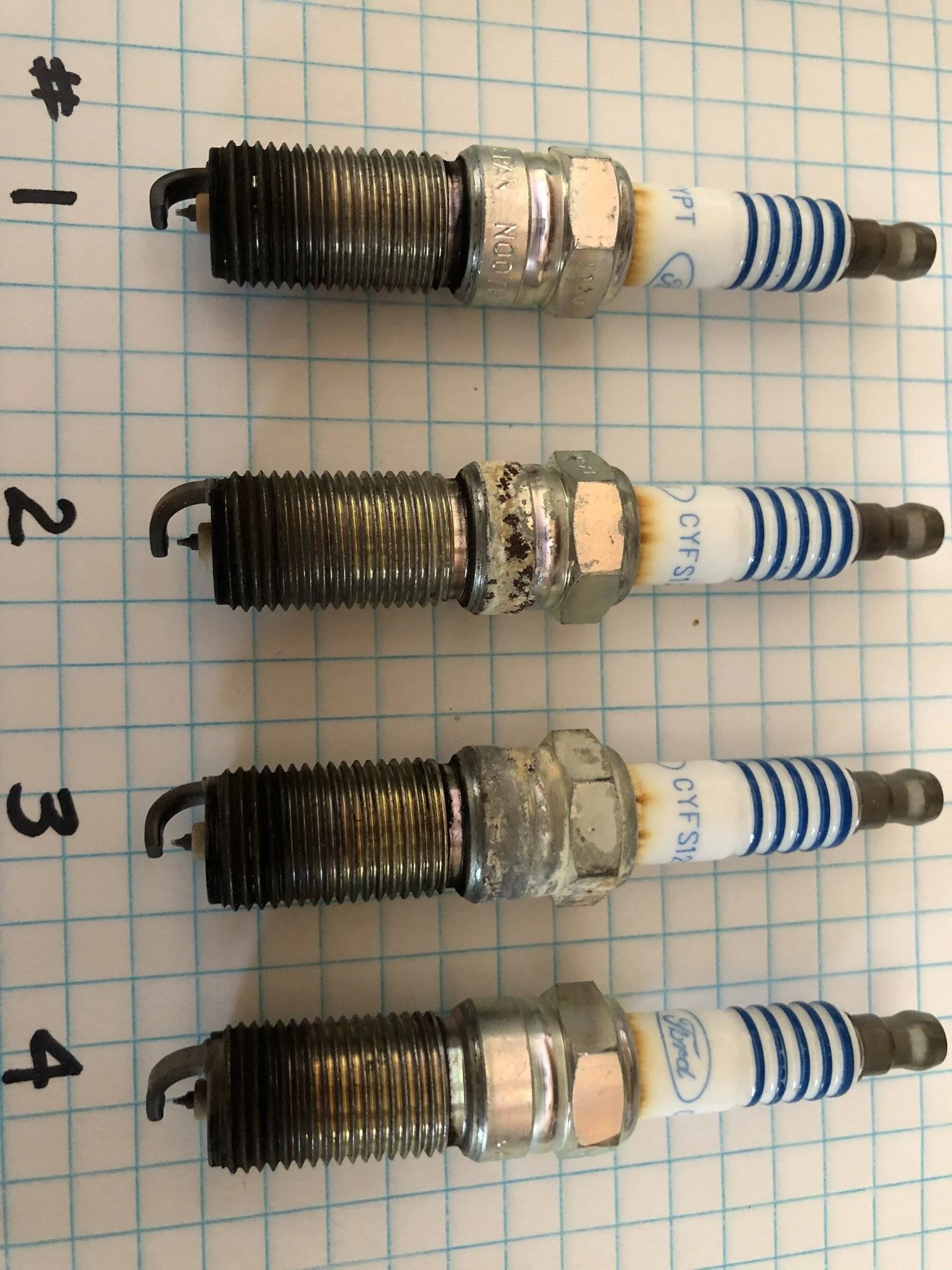

Probably like this:

I've searched the Forums and haven't ran across any discussions. I'm experiencing an extremely intermittent issue when passing traffic and kicking down the transmission to pass. The engine is falling on it's face with no power to pass. It's only happened three times (with me) since I got it new in May. No CEL or codes when I pull the OBD. Has to be fuel or spark related but it's not throwing any codes. I've pulled the plugs all are perfect, cleaned the mass air, changed the air filter, cleaned throttle body, no water in fuel. I've bore scoped each piston, no signs of excessive carbon and no indication of detonation. Loss of boost, I'm unsure? Today my wife was driving and she said that it happened a couple of times with her even accelerating hard off of stop light's ( Haaa, proved my point with her that I'm not the only one with a lead foot).
