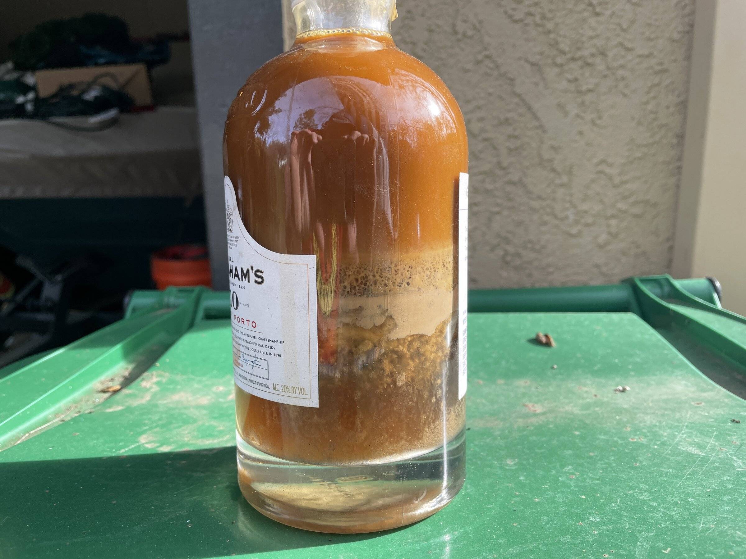

He’s actually correct. In winter my can catches a lot of water mixed in with the carbon build up. Summer I could go 3k miles and it only has a little bit of fluid. Winter requires a dumping every 1k miles. My bottle is almost filled after two years of the can. I’ll post a pic of it so you can see the actual carbon and petrol fluid separated from the water.
And that 'water' isn't going to be pure H2O.

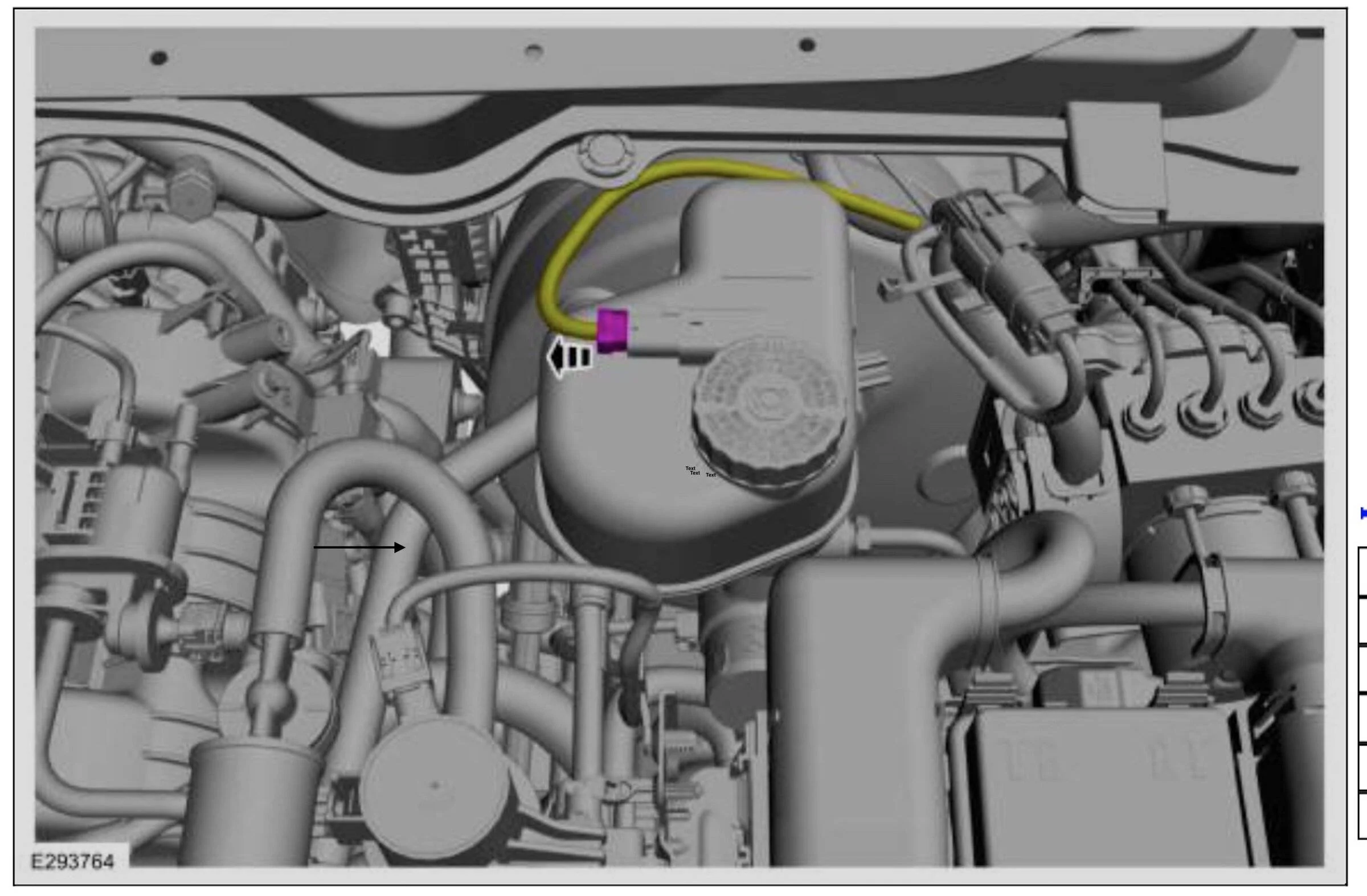

I did a search to find where the vacuum line was located -- do you have a photo or link of where you attached it?
You have a 21 XLT so you have a brake booster, I inserted the T fitting between the last valve and the booster itself. I used something like THIS with the small 1/4 nipple facing the fender and just a short 2" piece of line with a slip on cap, as its a vacuum source it won't come off. Easy to pull the cap and insert the straw from the CRC can and inject the cleaner. I cut the booster line at the arrow in the photo for the T fitting.
edit... NOT the arrow on the electrical plug LOL.
Ah, awesome -- thank you :)
