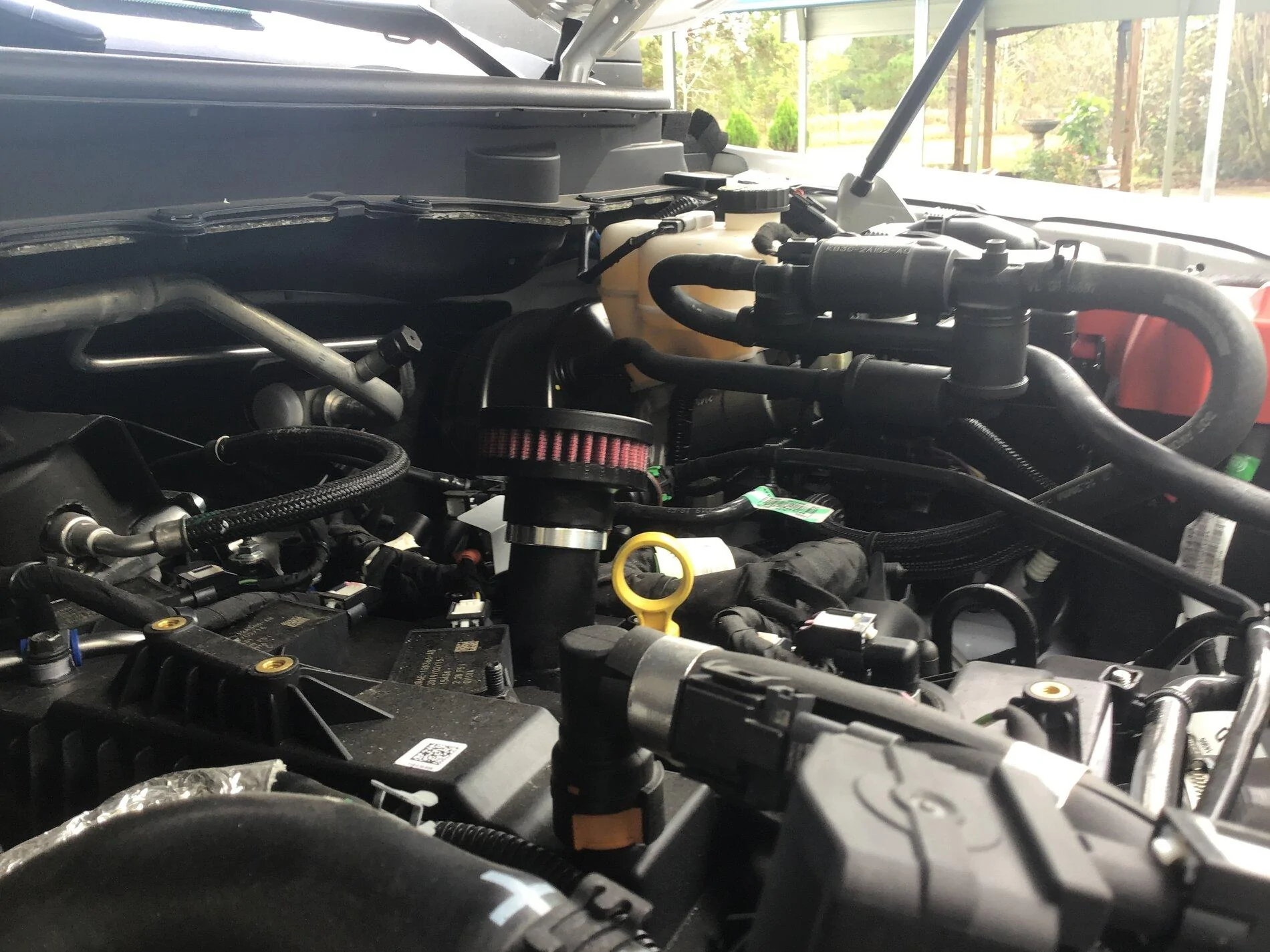

After being involved in discussions about the intercooler system and considering upgrades I would add that a catch can keeps oil/moisture out of the charge pipes where it has been an issue in similar vehicles and I presume the long term performance of the intercooler itself.
True, the return line is the pvc inlet
Catch can cleans that vapor
Every time I empty mine I imagine that stuff DIDN'T get to the intake so I feel validated.
