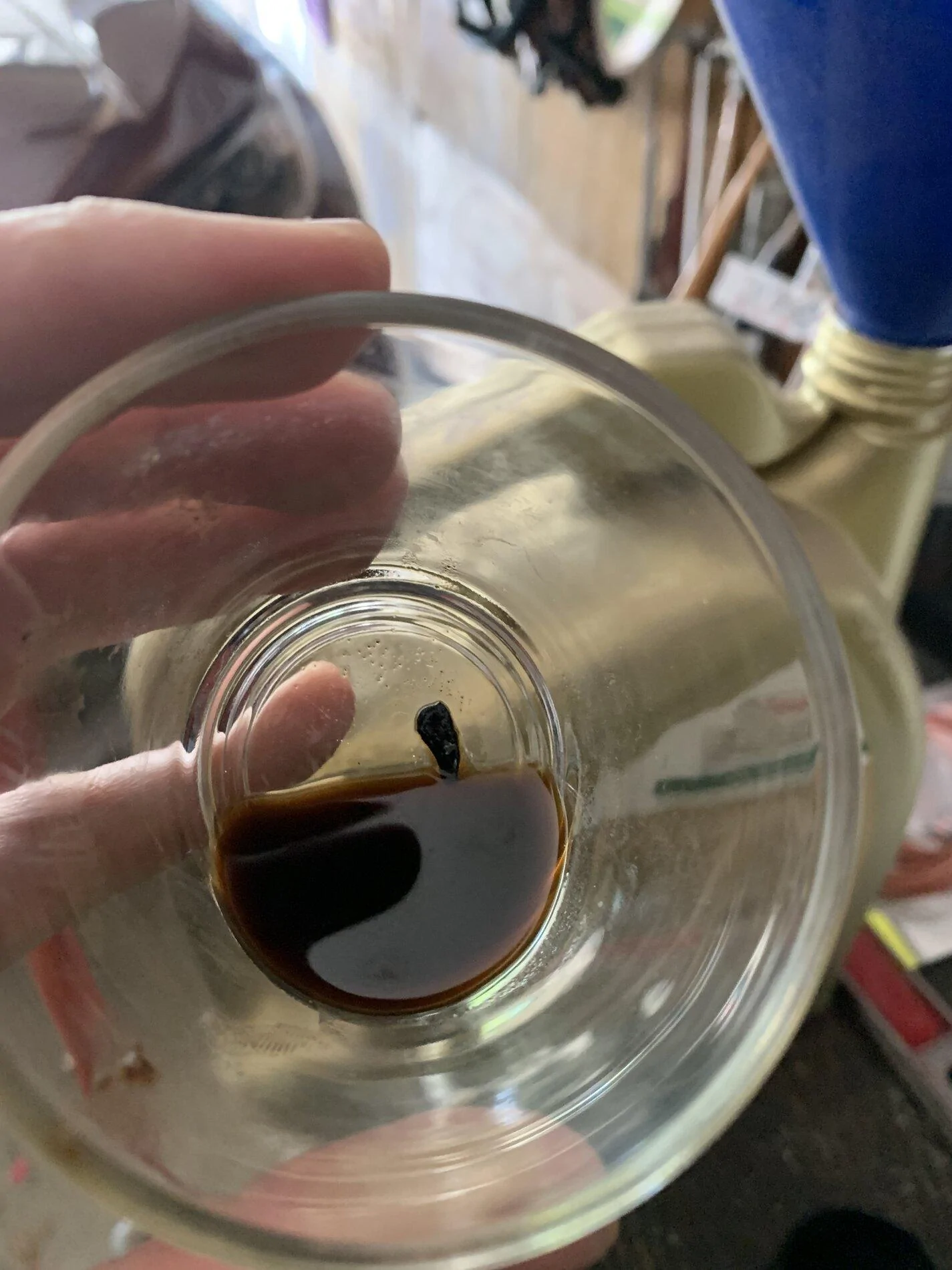

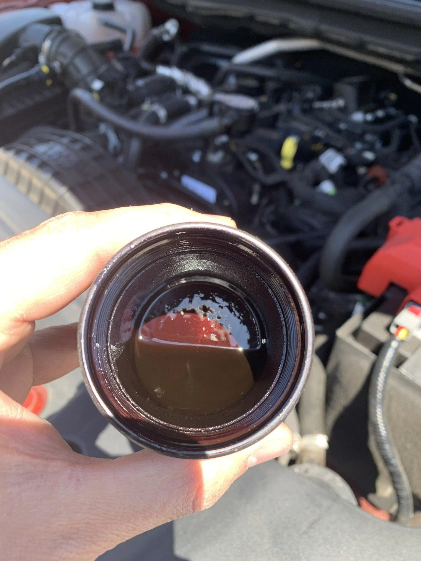

I have both PCV and CCV side catch cans.
My PCV side has 4k on it and my CCV side (turbo side), has about 3k miles. Ive done multiple road trips (lots of cruise control) and did some local towing.
PCV side: oil and gas, that would be a lot of crap on the valves.
Here is the CCV side. A little bit less but NOT anything I want passing through my turbo and intercooler. This was strictly oil.

how are you installing it on the CCV side? are you using the same style can?

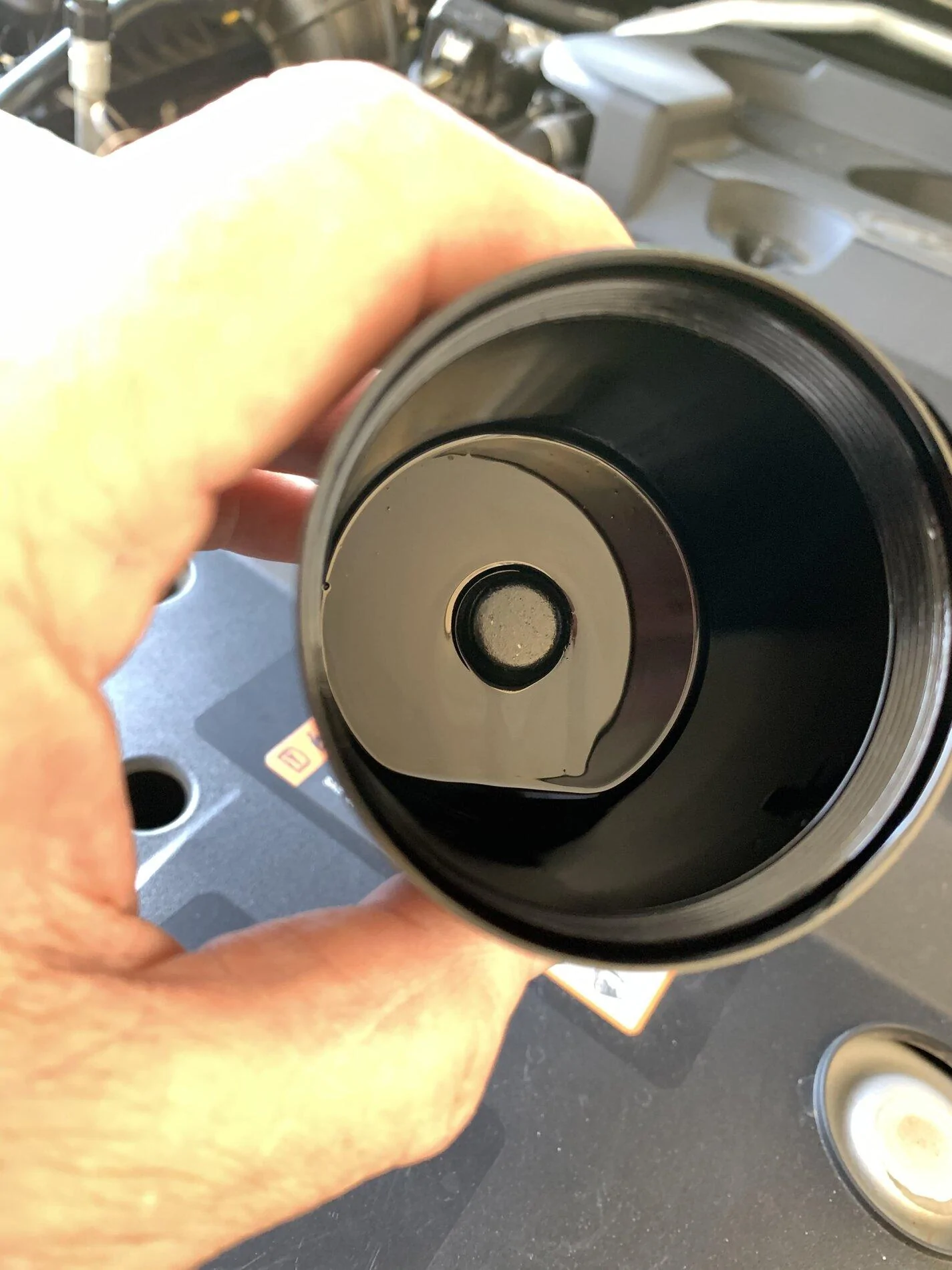

I had the Mishimoto Catch Can installed a couple of weeks ago. There was nothing but a very thin coating of oil on the inside of the can after 650 miles. I am going to monitor it by checking every 500 miles or so for awhile. I would expect there to be very little blow-by in an engine with only 4,650 miles on it. The can is more of a long term insurance thing.

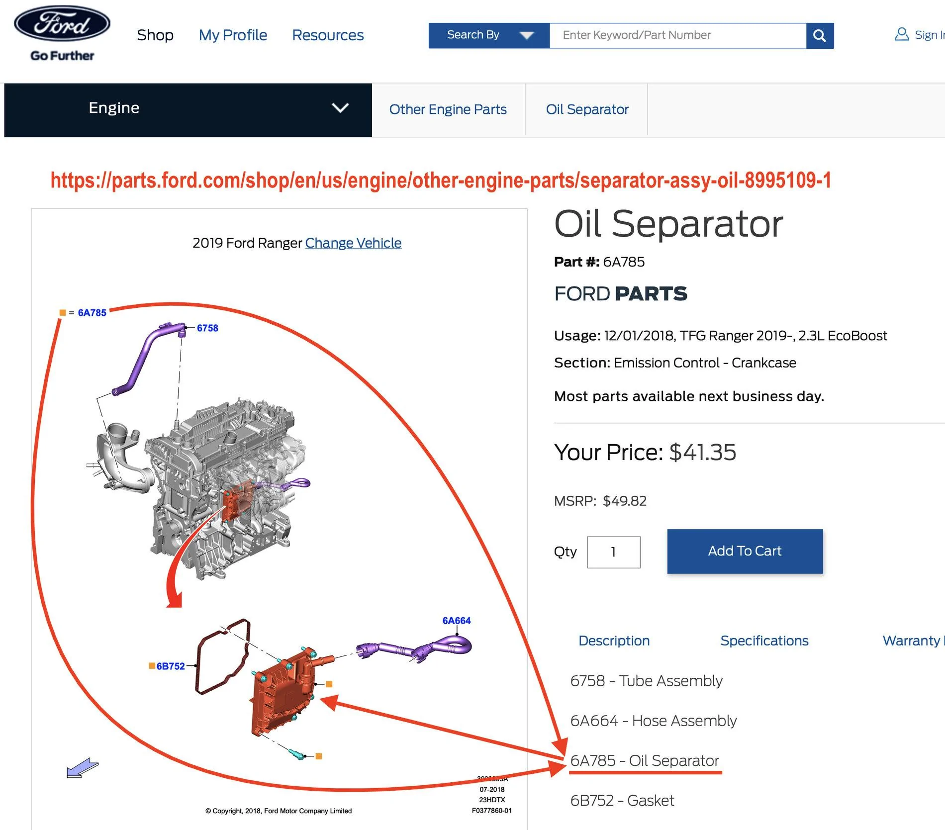

Ranger 2.3L comes with an Oil Separator under the intake manifold. For now I'm sticking with that and changing my oil every 5000 with good synthetic oil.
Locating a catch can much higher in the engine compartment than where the supply or pick up line is located concerns me. Oil might eventually build up at the lowest point in the line running up to the catch can and form a pool of oil in the hose. I would think this would reduce the effectiveness of the catch can. See the attachment.
Just my thoughts.

@SAZ Ranger
Pretty much every engine ever made has an oil separator/baffle on the pvc line. An added catch can works in addition to the existing oil separator. Oil catch cans do work, but are an added maintenance item.
The difference with the oil separator is any contaminants and oil that don't get pulled through the intake go back to the pan (evaporated then condensed water/fuel etc) only to be evaporated again then eventually pulled through the intake, until you change the oil.
Where the catch can would contain those contaminants.
The real issue though is the valve deposits. Which is caused by the oil that makes it past the oil separator and is then pulled through intake. The evaporated water/fuel does not contribute much to valve deposits.
Do you NEED a catch can? No
Does a catch can work? Yes
Does a catch can 100% protect against deposits? no
I don't plan on using a catch can. I also have yet to find intake valve pictures of a DI engine that has used a catch can for 100k+ miles to provide me estimation of the effectiveness of the catch can against valve deposits. I want to see how much better it actually is.

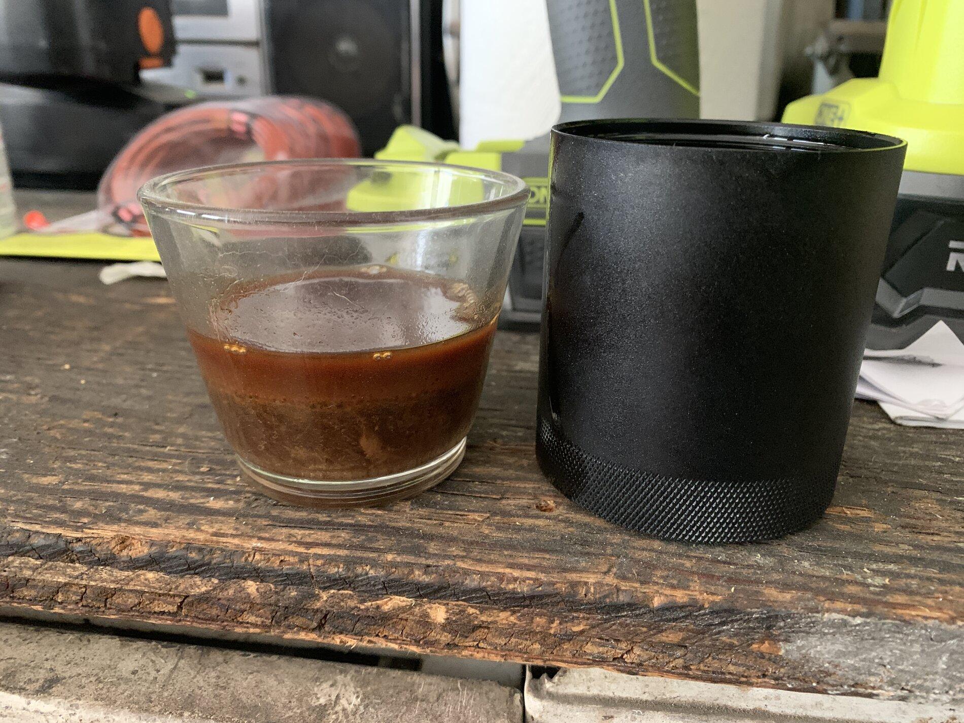

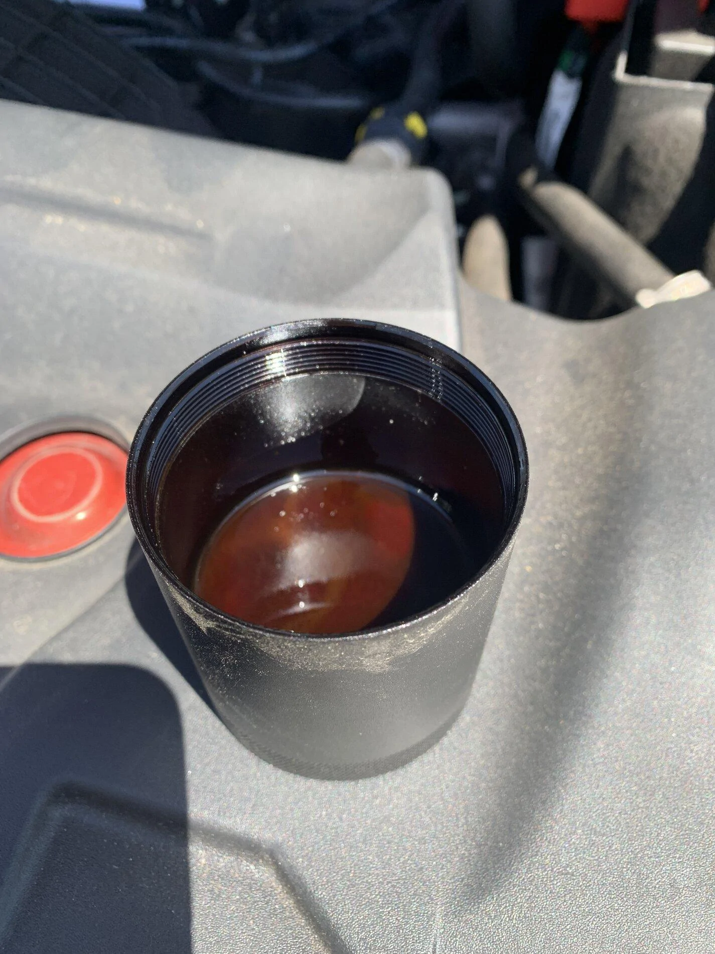

This is why I have a catch can. This is after 1000 miles that included a 500 mile freeway road trip. I would rather have this stuff here than baked on the valves.
2019 Super Crew with 5500 miles on the odometer. Livernois Motorsports 91/93 Performance tune.

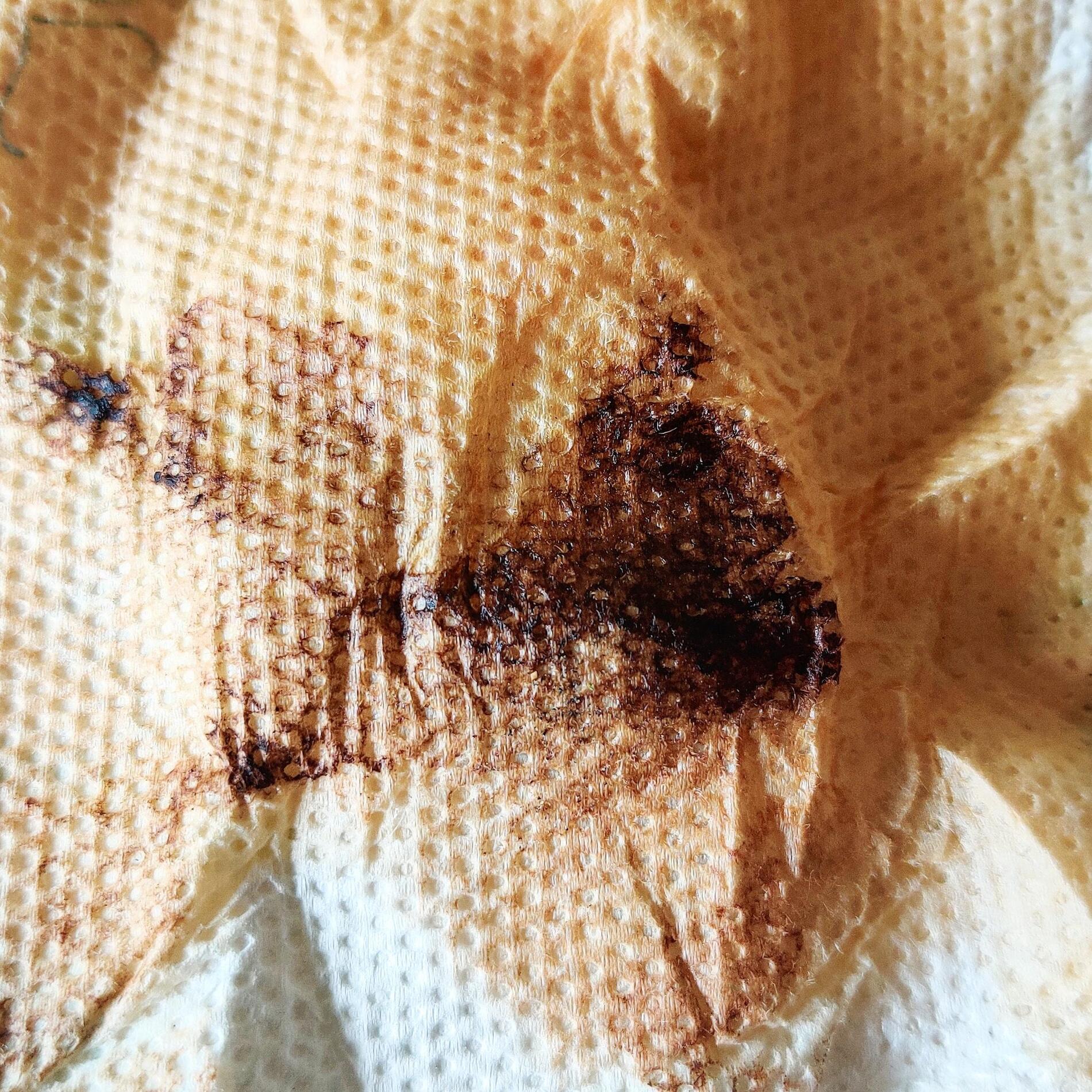

After about 3500 miles, lots of fuel mix but also sludge on the bottom of the mishimoto can.
