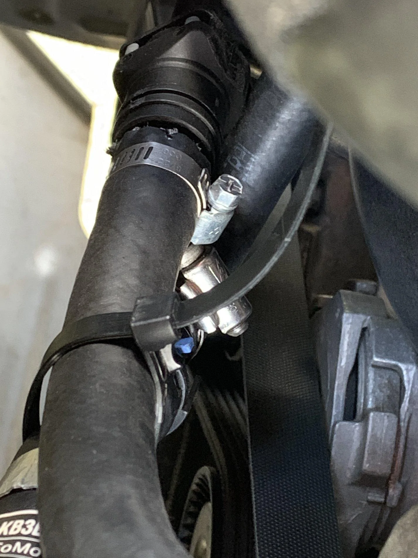

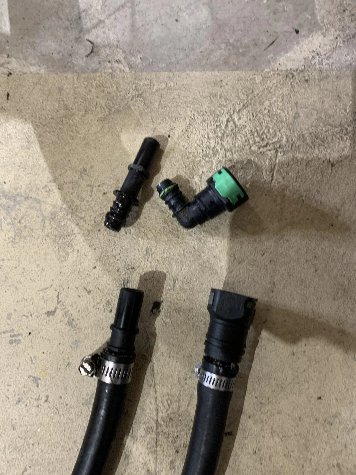

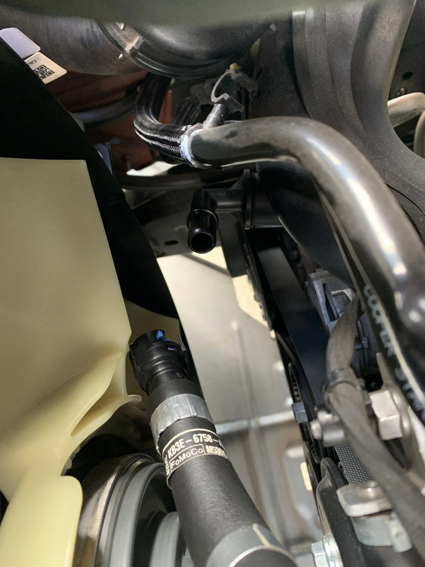

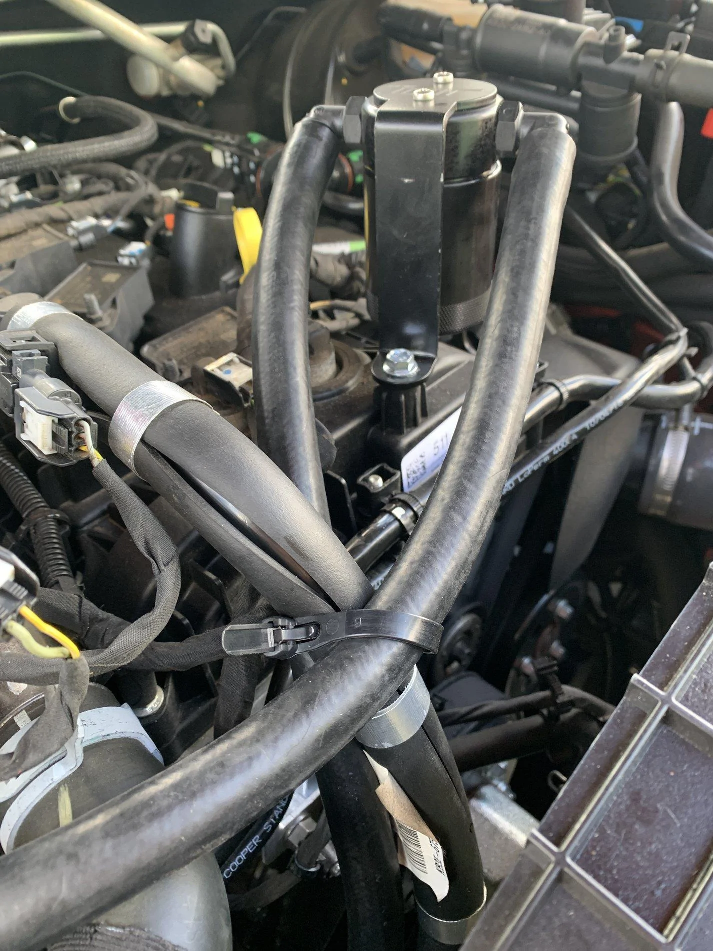

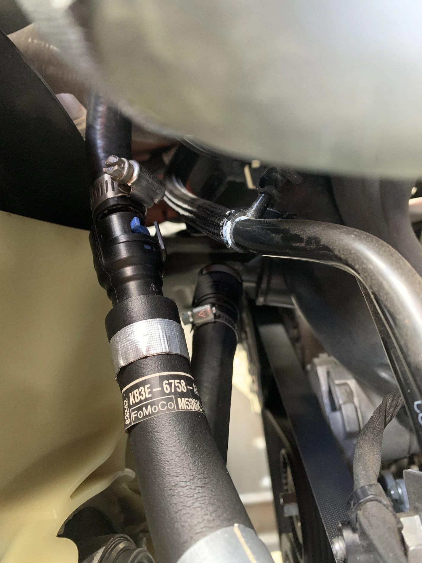

CCV side using the JLT can setup.
The lines provided with the JLT can are 1/2" bundy connectors because they're intended to be used for the PCV side fittings. The CCV side uses 5/8th Bundy connectors so I had to get 5/8th Bundy fittings (with 1/2" barb) at FIttings.space or Amazon:
Fittings.Space LINK
I used some effort to remove the existing fitting and installed the new.
Then I disconnect the OEM fittings:
Then Attached new hoses and start figuring out routing
All Done
I may swap out a fitting. The MALE bunding fitting that goes to the Female CCV line would serve me better if it was a 90degree elbow fitting instead. So if you're doing this: get the MALE fitting that's 1/2" barb to 5/8th" BUNDY.

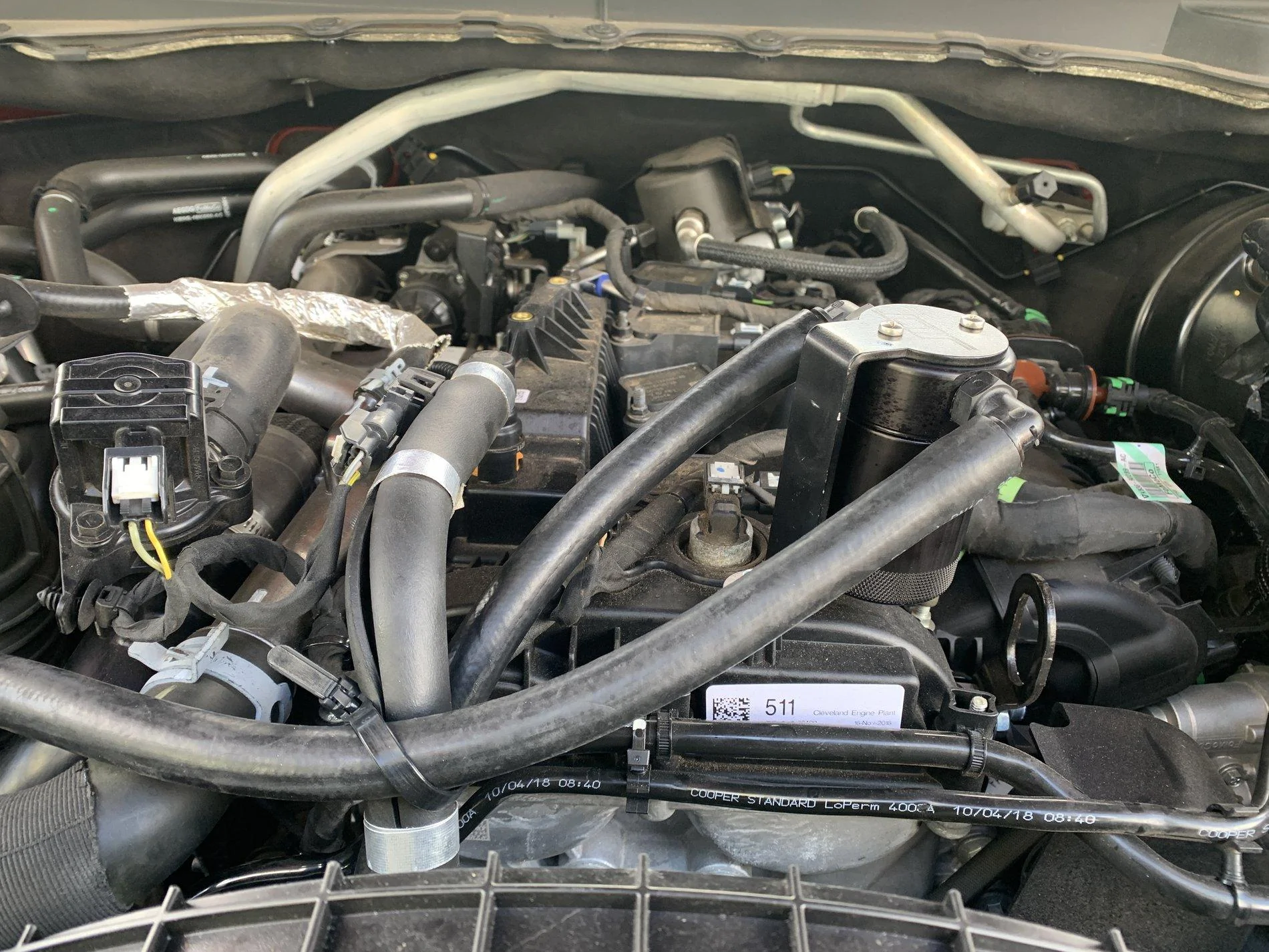

I installed the UPR catch can (original version) today. I got a great deal on it on eBay. I believe the seller gave up on removing the OEM pcv line or something. This one isn't tapped for the 2nd port so the upgrade kit isn't an option for me.
The install went better than expected and I only cut my hand once :frown:. People are not kidding about how cramped that area is and having to remove oem pcv line by feel. Getting the factory pcv line out is the only bad part, installing the mount, catch can, and hoses went smoothly.
The Mishimoto install video was extremely helpful. If all I had to go on was the UPR instructions I might have given up and listed it on eBay myself.
Wow... that location for the can looks horrible.

I have one of the first UPR catch cans (before the second vacuum line was developed) and there should be a cap on the opposite side of your existing one that looks like a square-top threaded plug. When I upgraded mine, they sold me the parts and called it the 'WOT accessory'. It is not as hard to put in as the basic kit.
The install was very, very tight and I still have scars to prove it.

I know we're talking vapors here but it looks to be a mighty step incline for oil to travel. Even with vacuum...

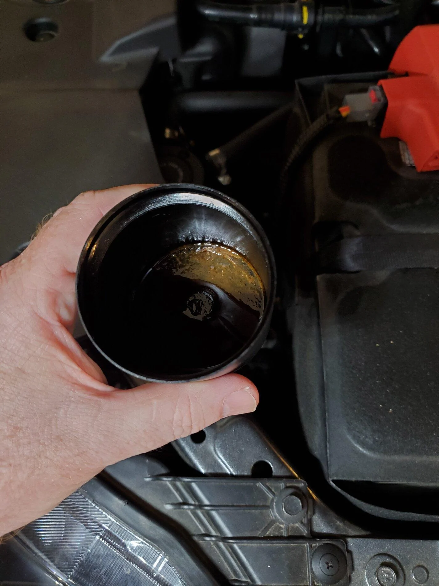

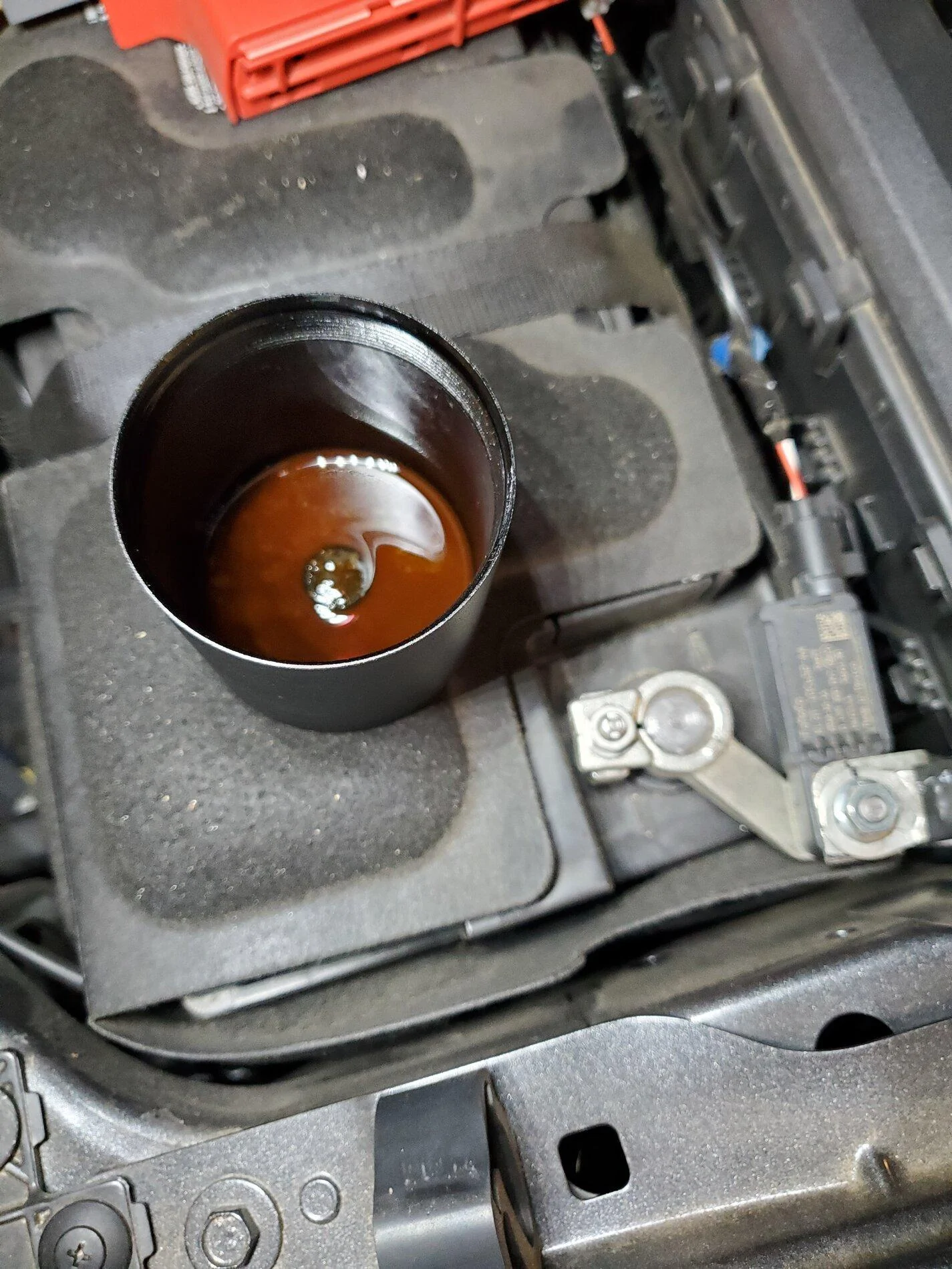

Installed the Mishimoto catch can earlier in the summer. this is what I got in the can after 3K. I have a mix of driving. Some short trips, but some long ones as well (400+ miles in a single trip). I'm at 25K on my '19 Ranger Lariat 4x4. For the engine, this is the only mod I have so far. Plan on a CAI later as money/time allows.
