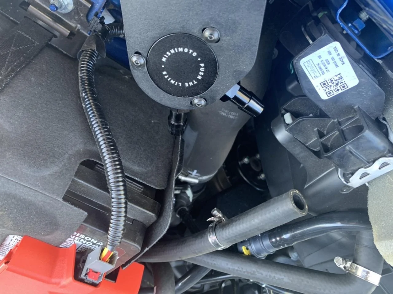

don’t know why it shows up upside down, either way here’s another update:
So the valve idea is a double edged sword. Mine seized shut on me when I tried to clean it this time. My dumbass forgot to lube up the o-ring. A mistake I won’t make again. Anyways this required me to removed the can itself and when I checked the actual baffle, wow it was caked in carbon and brown petrol mixture. So I cleaned the crap out of that. Followed by the ritual of dumping out the contents of the can.
alright so reason I called it a double edged sword. I now see the simplicity of the valve. Would have made a 20 min job into a 5. On the other side, I’m glad I looked at the baffles, as I said they were caked. Anyways take it as you will. I’ll continue updating as time goes on so those on the fence know what to expect.

Eh definitely a worth it in my books. Seeing all the carbon deposits and the fluid mixture that it catches, it’s worth it. 1000 easier to clean the can then to clean the valves. I’m actually thinking about installing a valve and feeding it into a bigger container underneath the catch can. I’d like to go clear so I can see what’s in it.

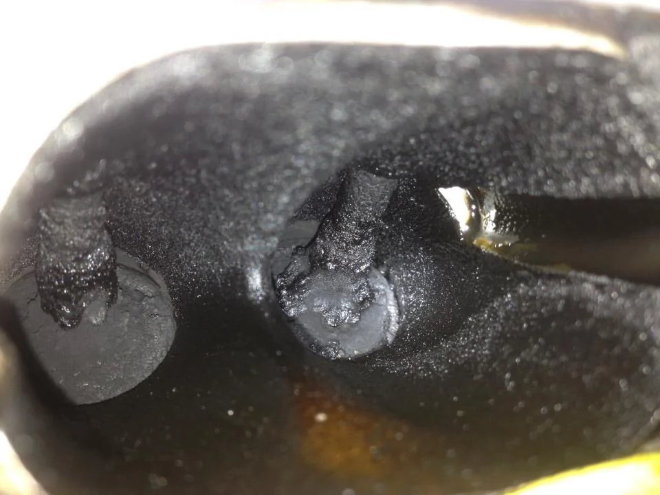

I'm new here, and just bought my Ranger on Saturday and was looking at various mods and this one caught my eye. Having owned a car with a DI engine that is notorious for the intake valves getting caked up with deposits. (2008 VW GTI) I can say that in most cases the addition of a catch can is not necessarily a requirement. I put 150K miles on the GTI with a 148K of those having an APR stage II tune on it. As a part of regular preventative maintenance I would perform a SeaFoam treatment on the intake valves every 20K miles. Using a garden sprayer, a fine mist of SeaFoam in 5 second pulses would be injected into the intake. Once 2/3 of the can was run through, a heavy shot to use up the remaining was sprayed in and the engine shut off and left to sit for about 15 min. After that it would be started let idle for about 5 min then taken out and a couple hard runs done on it.
At 120K miles I ran a bore scope down to the valves and was surprised to see there was very minimal buildup on the valves. So as long as you do some regular maintenance like this, valve deposits on a DI engine should not be a major issue.
