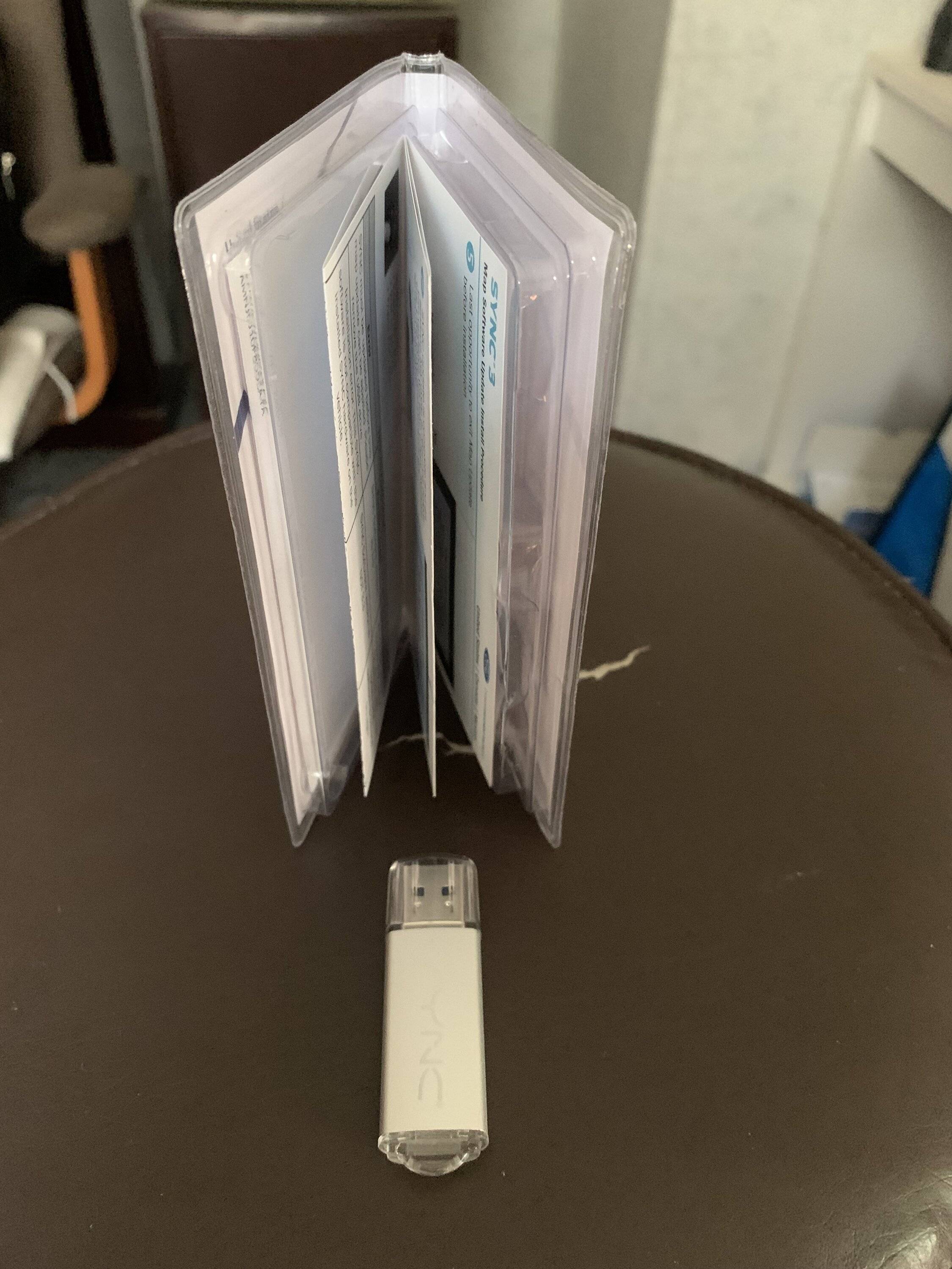

I clicked on the link to download the map update, the webpage changed and there was no longer a link to download the license file. I had to pay for the USB stick. Do they need to make this process so convoluted ?
Install worked.
Anyone know how to format and reuse the Sync Map USB stick they send out by mail ?
Windows doesn't seem to recognize it.
I'm thinking the same thing but haven't tried it. Mac OS/Intel at home. Have accumulated two Ford Map Update USB update sticks so far - the 'blue light' is too cool!?!?
Install worked.
I'm not sure what you mean that Windows 'doesn't recognize it'.
Yes, it's formatted exFat, which is special, but it should still 'recognize it'.
To turn it into a 'normal' USB, format it Fat32.
Is that what you mean?

Figarou
Mar 22, 2019
2,408
13,794
Blue light comes on, but the stick does not appear in File Explorer or Disk Management.
Would that be "not recognized" ?
If Windoze can't find it, then how to format ?
Use Diskpart
Windows 10
Open a command prompt as administrator
Windows 11
Open Terminal (Admin)
Type diskpart
In diskpart.... rescan
in diskpart... list disk
You should see a list of disks and drives on your PC. The USB stick is usually the smallest in size.
in diskpart... select disk and the number of the usb drive in the list. It could be 3 {select disk 3} Again look for the small size in the list. Don't confuse it with your recovery portion
In diskpart.... list partition
here you should see the partitions on that USB stick. If there's more than 1, then you have to delete it one by one. Let's say you have just one.
in diskpart.... select partition 1
in diskpart.... delete partition override.
Do that to each partition. You must select the partition 1st, then delete.
Finally
in diskpart..... create partition primary
USB should work in windows after that. Format it to your liking.

Well, I'll be darned!
MY computer was fooling me.
I also wanted to use one of my old $40 MAP update usbs for this update.
Everything looked good in file manager, BUT it just wouldn't write to the usb!
(It gave an error saying the device didn't exist.)
Sooo, with nothing to lose, I did as you said using diskpart.
And poof, everything now works!
THANKS for your help.
