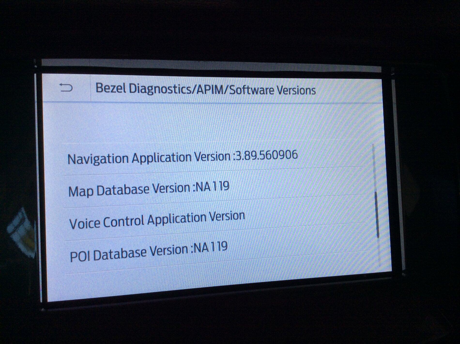

How do you know you have a partial install? You can check the installed packages via the IVSU Versions diag screen. This can be accessed on non-CD equipped vehicles by turning on the radio, then pressing and holding the seek forward/right buttons on the IP and steering wheel at the same time for ~10 seconds. You will then cancel the speaker walk around test, and select the APIM button in the upper left corner. Then, select IVSU Versions in the lower right. Check if there is a 14G422 package. If not, you have a partial install and need to re-run the map install utility. On CD equipped vehicles, the diag can be entered by pressing and holding the CD eject and seek forward/right hard keys.
For #2, if you have verified that you do have the updated 14G422, meaning the map install should have completed in full, and still do not have working navigation voice commands, you will need to run a master reset. This will erase the paired phones, favorites, etc. but should result in recovery of the nav voice commands.

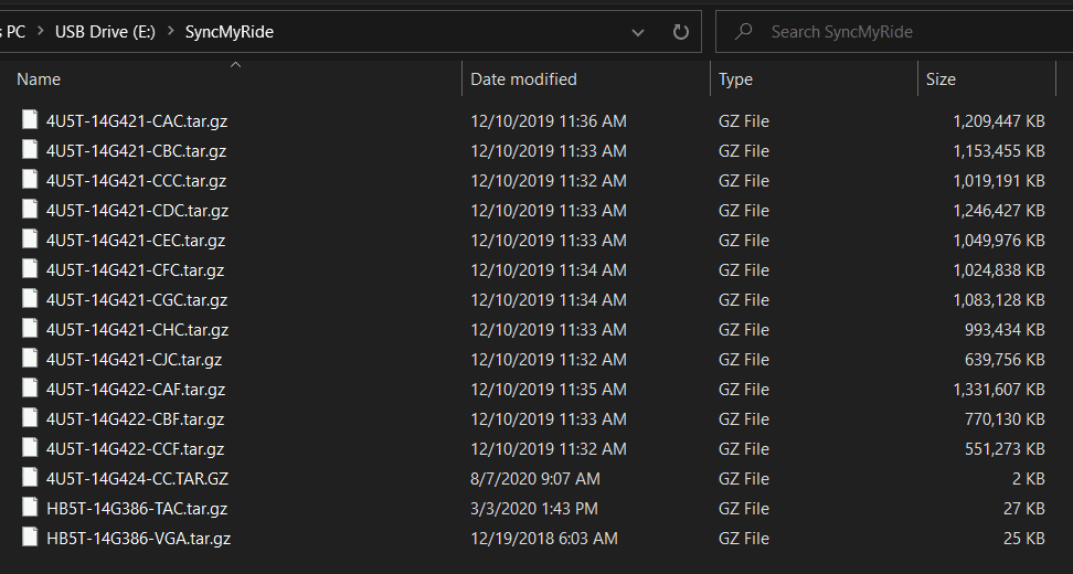

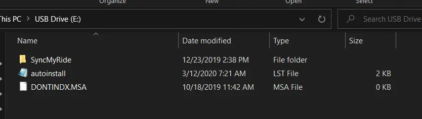

- If you see an LST_ERR05, make sure you put the license file in the /SyncMyRide folder. Then check that all other .tar.gz files are also in that folder.
- If you see nothing happen, or a drop down notification that the drive was indexed, you have the file structure on the drive incorrect. Correct the file structure and try again.

Hey @UofMEngineer - thanks for all your input and help on these issues. I've got one for you though - I downloaded the 119 map update, plugged it into the truck and got the software update prompt up top. I didn't however see the pop-up that mentions it being a large map update. I also didn't see ANY restarts of the sync system. I let it sit for roughly about two hours and there was no change. I used this same USB thumb drive with the previous map update without issue. Any suggestions?
UofMEngineer
Apr 19, 2019
516
334
20' Escape Hybrid,18' Fusion Hybrid
Hmm. Double check the files are on there in the right spots for grins. You should've seen the usual pop-up to acknowledge loss of voice and such during the update. It would seem it may have failed right away...hard to tell. Do you have v3.4 installed? You could always try to do it again, and if it does the same submit a bug report and I can go log hunting to see if I can make heads or tails of what is going on.

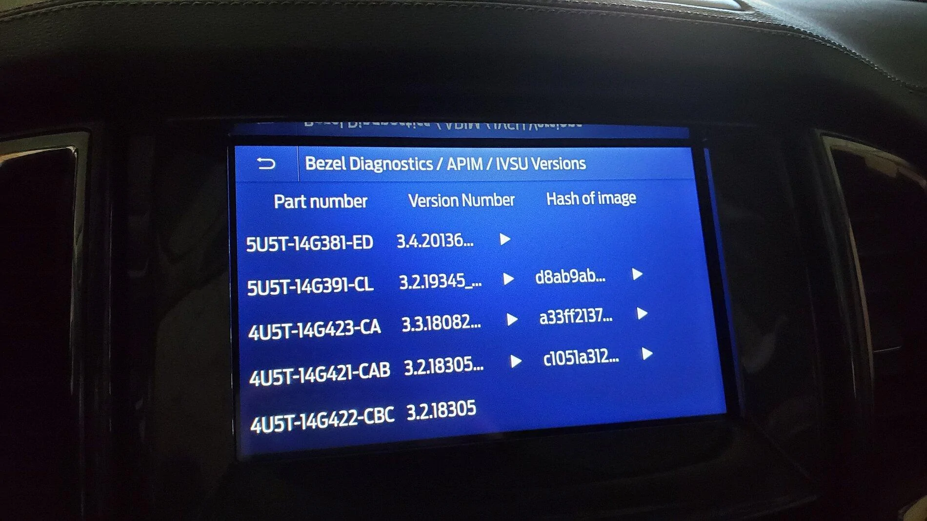

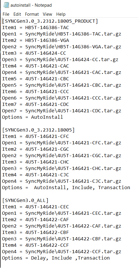

Everything is where it should be, I didn't tinker with the autoinstall.lst at all, just downloaded straight from ALOM, copied it over to the thumb drive and tried to install. I do have 3.4.43 (5u5t-14g381-ed) installed. I tried it three times, the first time I went for about a half hour, nothing, second time for about an hour, nothing and this morning for two hours and still nada. How can I submit a bug report for you?

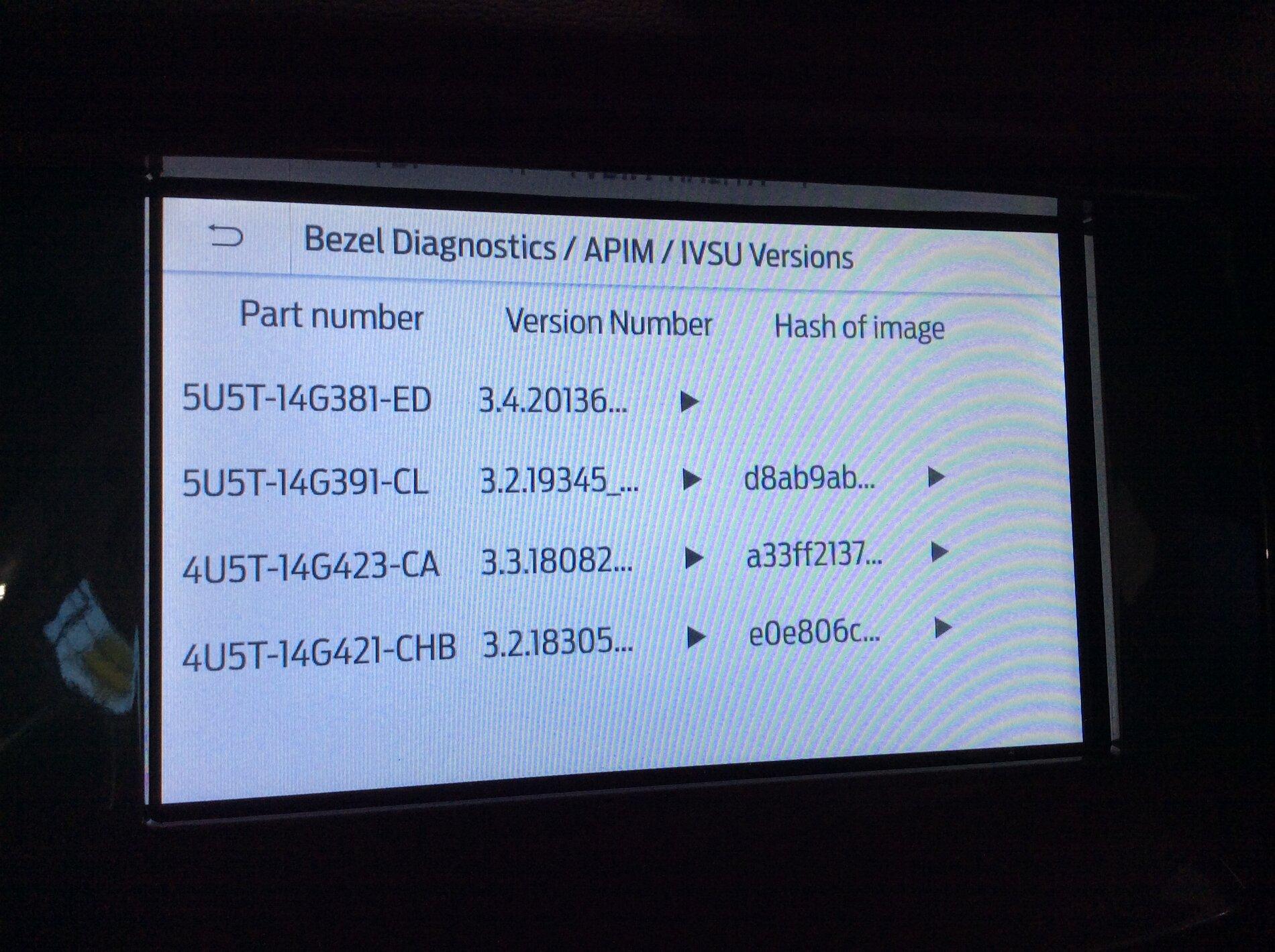

Do you still see the old map file and voice file in the IVSU Versions screen? Might help point to where it is / isn’t getting.
For bug reports, connect to WiFi. Then go to settings, general, sync analytics and diagnostics. Turn on the option for diagnostics. Then, plug in the drive and let it sit for maybe 5-10 minutes. If nothing happens, go back to that same settings menu and select the bug report option. Then you can pick map update (I think) under Nav, and submit. It should send it in then, or at the next WiFi connection.
Yeah, looks like it's still the old stuff. I submitted two bug reports, one for Navigation>Other, and one for Software Updates>Not installing from USB. Let me know if you need any info to pull the logs. Thanks!
