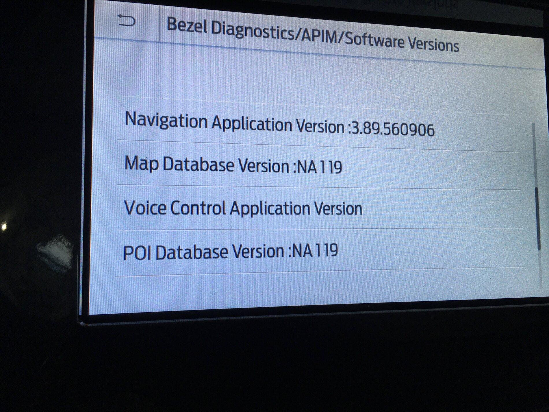

Thanks for the assistance. I got it working today. The update took much longer than I expected. The info screen still doesn't show a Voice Control app version, but I tested it and it works.

Glad it worked. Yes it does take longer than you would think and the messages flashing on the screen are confusing.
