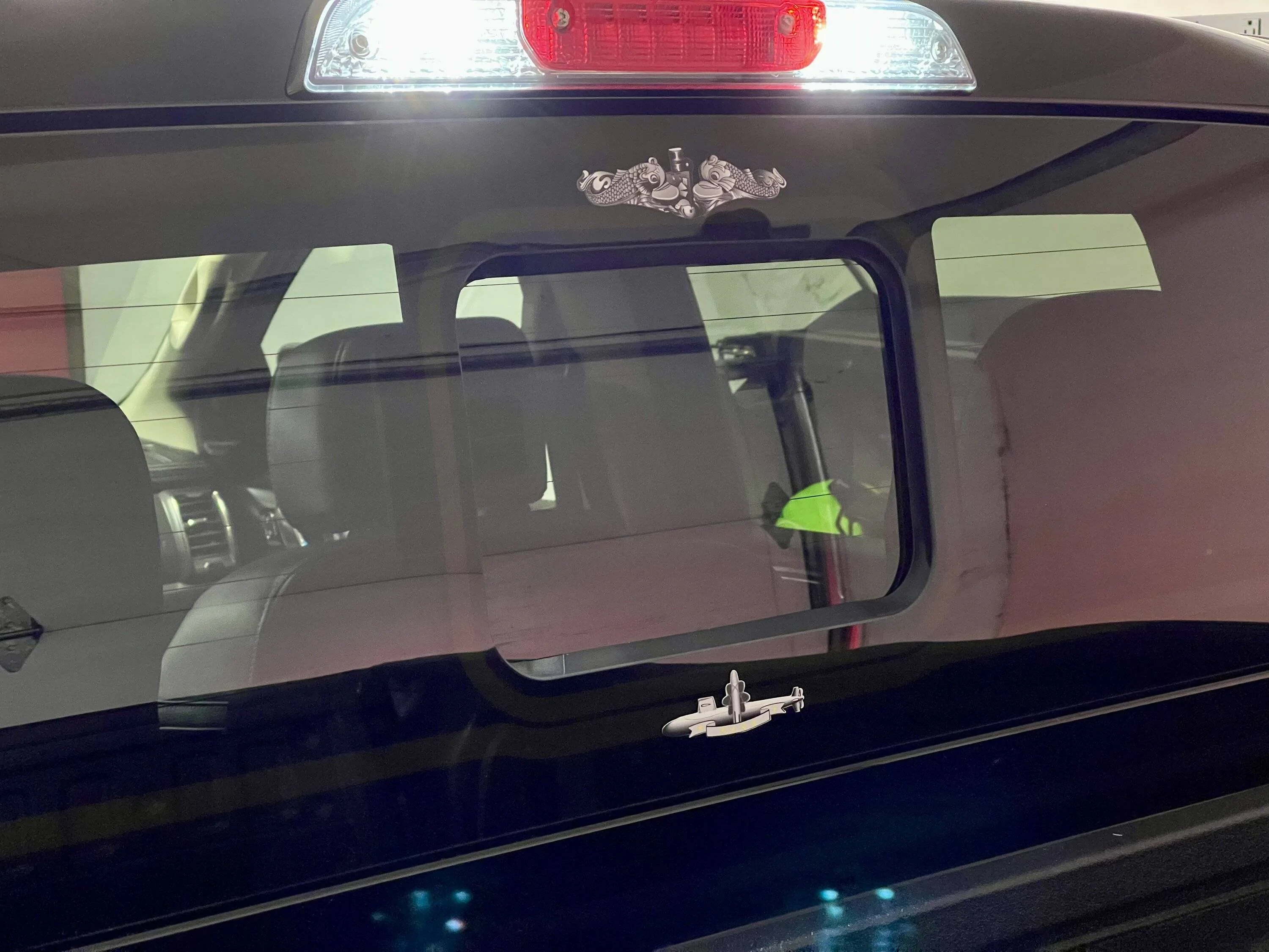

Not providing anything substantive other than recognizing a fellow boomer sailor :rockon:
Excellent!! MM1/SS, USS Henry L. Stimson SSBN 655(G) Are these on the inside or the outside? And, where did you get them?

Qualified as ET2/SS (Radio) on the Kentucky 737(B) Nov 5, 2005. Left the Navy as CTN1/SS in 2012. The decals are on the outside, I got them both on Amazon, but it looks like the deterrent decal is out of stock :(
Deterrent Patrol decal: https://www.amazon.com/Submarine-Deterrent-Military-Veteran-Sticker/dp/B07GVF7J4H
Dolphins: https://www.amazon.com/gp/product/B07BD1HCTZ

Cool. With my cap on the truck, they wouldn't be visible though. Might have to put them on the side windows.
