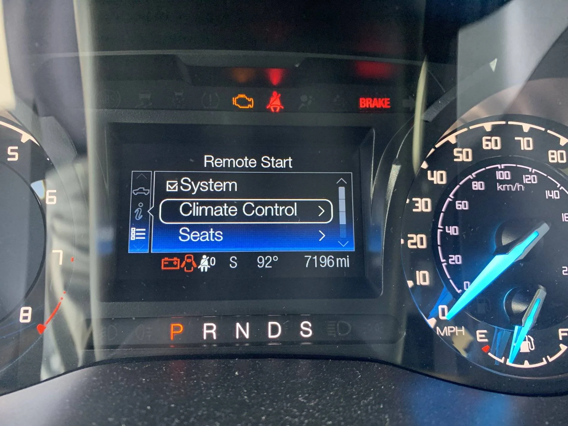

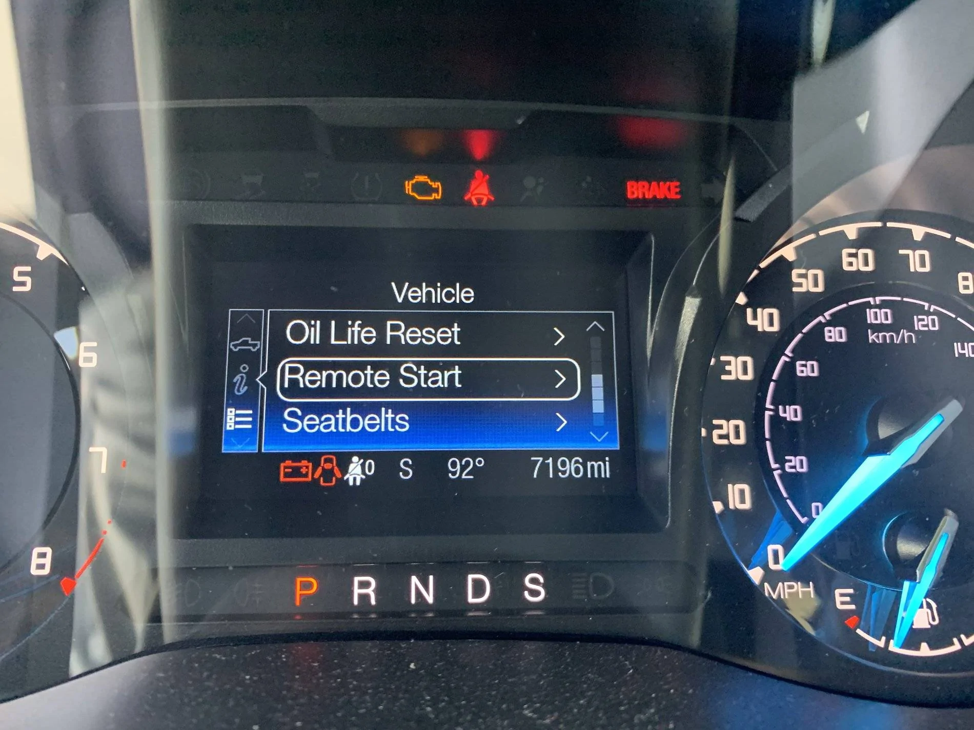

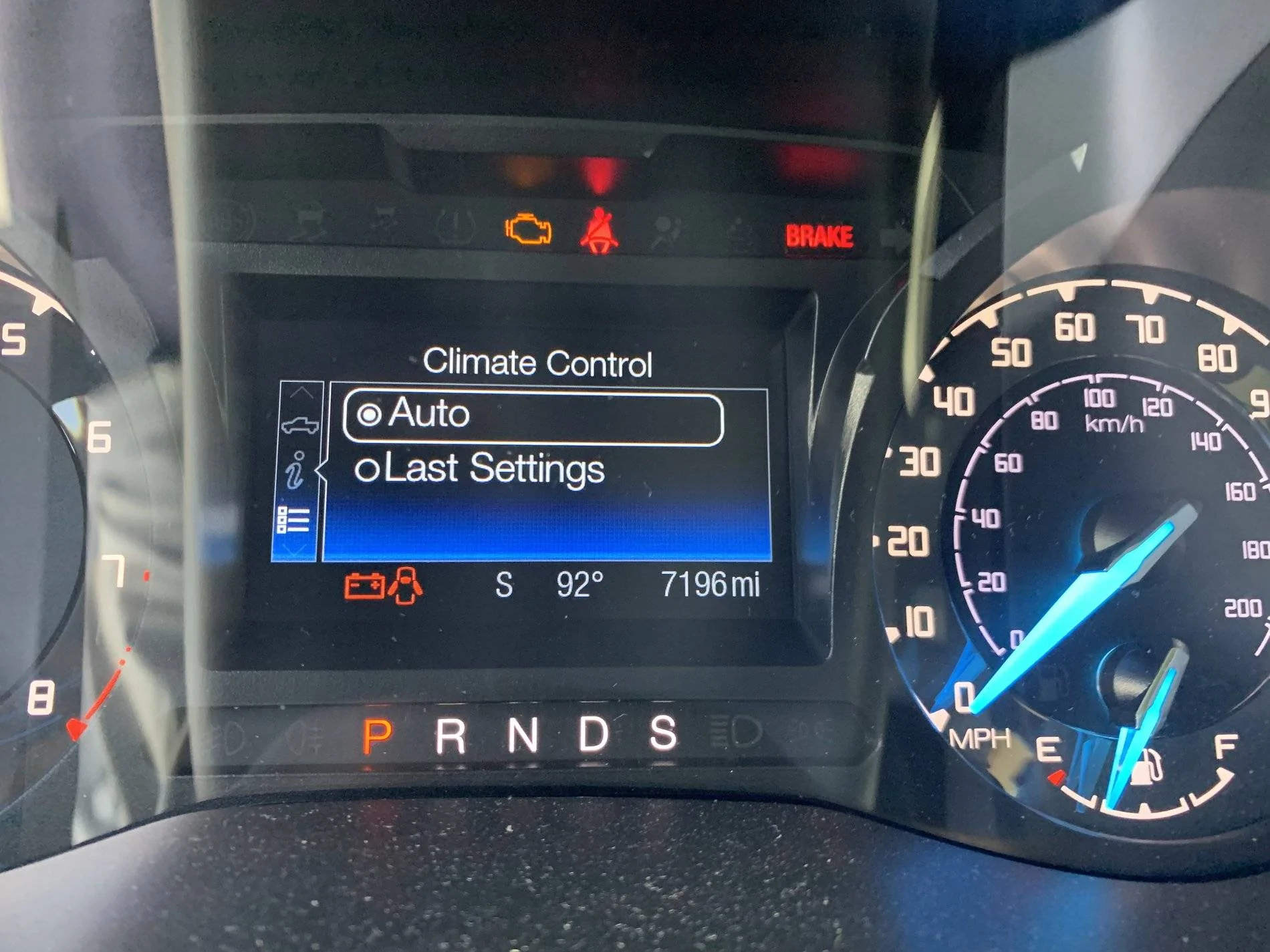

I took some pics of the settings for the group. In the cluster menu it’s under vehicle settings > remote start > climate control. In there, the choice is auto (ac or heat will run to max if needed to cool or heat cabin) or last settings (it’ll run where you last left the climate).
Obviously this only applies to trucks with factory remote start (key fob), not FordPass only remote start. However, on a truck with factory remote start, starting with FordPass will net the same results and same settings should apply:

Just went out to my truck, I never thought to check in the settings there. Changed it from auto to last settings so hopefully that will solve that issue for me. Thank you for that!

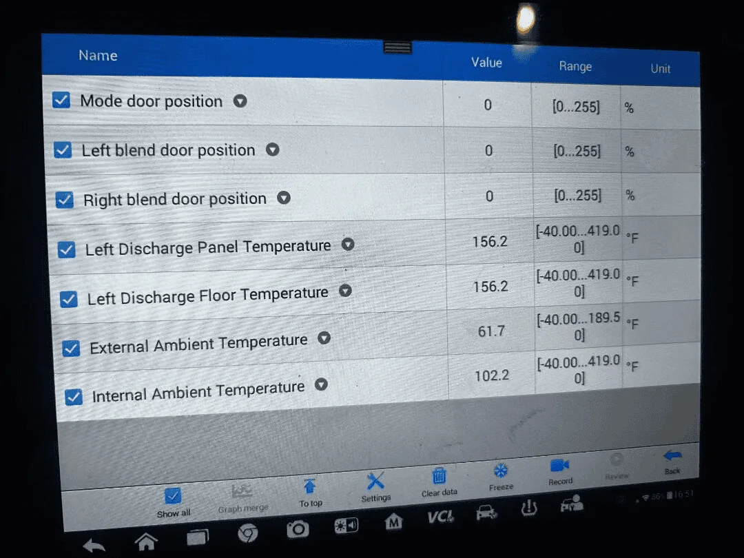

To highlight operation of the doors.
In Heat operation they open
In AC Operation they close
These PID's are from my Autel Scanner, I do not believe Forscan will display these Pids
Yet - Anyway
Notes: For T/Shoot
Mode Door Position: (Normal Readings as Follows)
Defrost = 100%
Panel = 0%
Floor = 50%
Blend - Panel/Floor = 25%
Left / Right Blend Door (This is the Temp Actuator/ Door) Position, this will check max travel open and closed.
Any selected temp in between the (percent) will vary.
Hi (Heat) = 0%
Lo (Cold) = 100%
Left Discharge Panel Temp / Left Discharge Floor Temp
These temps will vary but should be close to each other, if mode is placed in Blend (Panel/Floor) if you wait about 5 minutes or so the temps should be near equal.
External Amb Temp - Should match OAT Temp, using your phone etc.
Internal Amb Temp - This is the Temp/Humidity Sensor, this reading will read high and or low, if just sitting still as the heat/cold air is rising up from the floor vents through the dash.

So I followed the instructions posted by Airline Tech and switch mine from auto to last settings in the cluster screen and have seen a much better improvement in clearing the windshield while remote starting. Another affect that I’ve not expected, I can now feel air blowing at my feet on half fan speed but that could be a placebo affect so perhaps some other members could try it and let us know?
