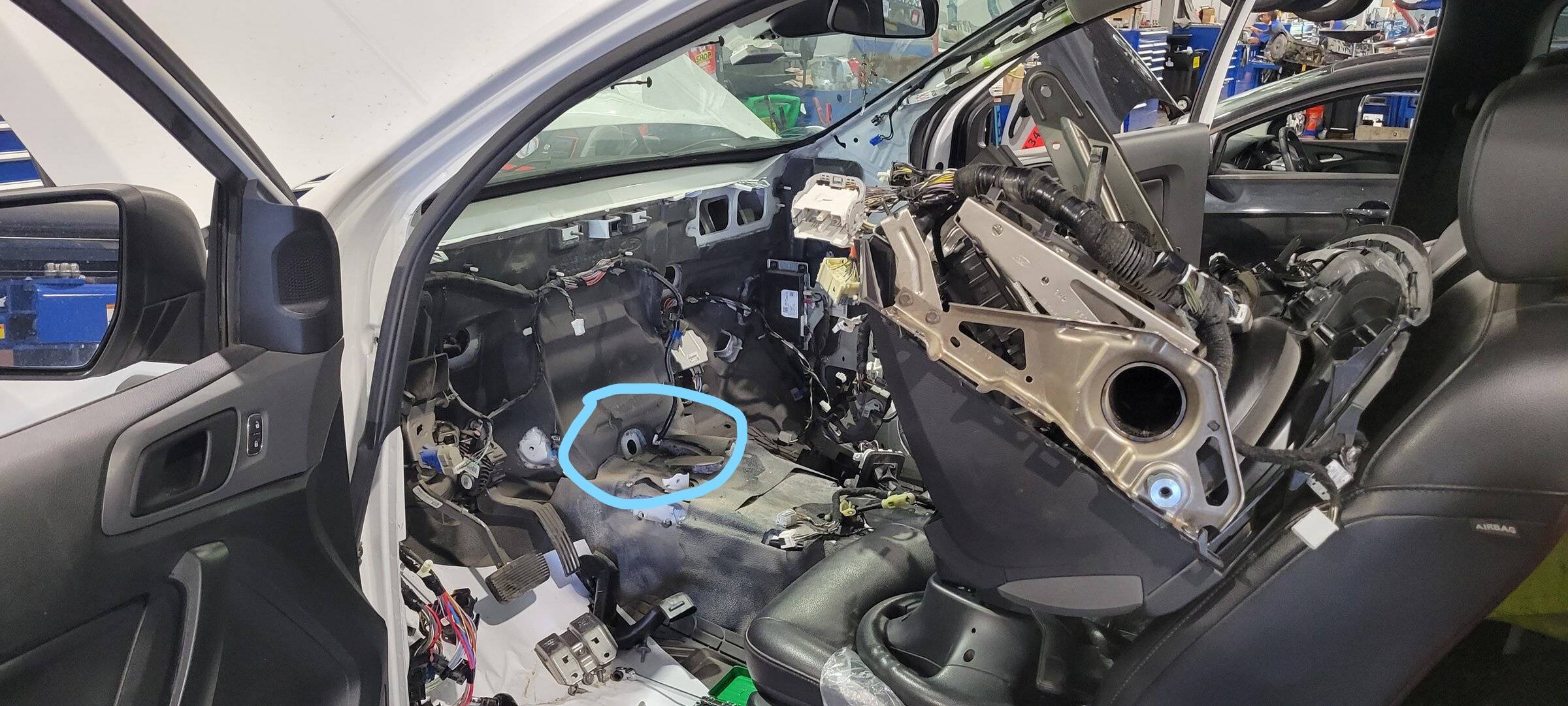

I took a quick look on my truck this morning and the drain is not easily seen, I know that it drains just above the transmission, so this may be why I have not noticed any draining on my truck, transmission may be stopping it from hitting ground (?)
I do not have any issues with the AC or wet floorboards, I am just curious if I have a clog on mine.
I will have to possibly go through fender well to see it as it is buried and hidden from easy view.
Borrowed Pic, The Drain Tube should be withing the circled area. (For Ref) for location on engine bay side.
