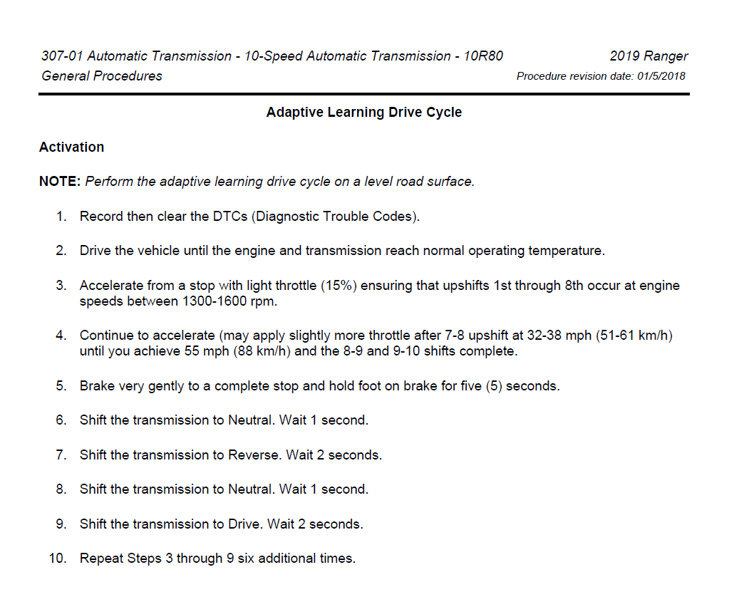

why wait?
accelerate the process by following these steps....probably done in an hour.

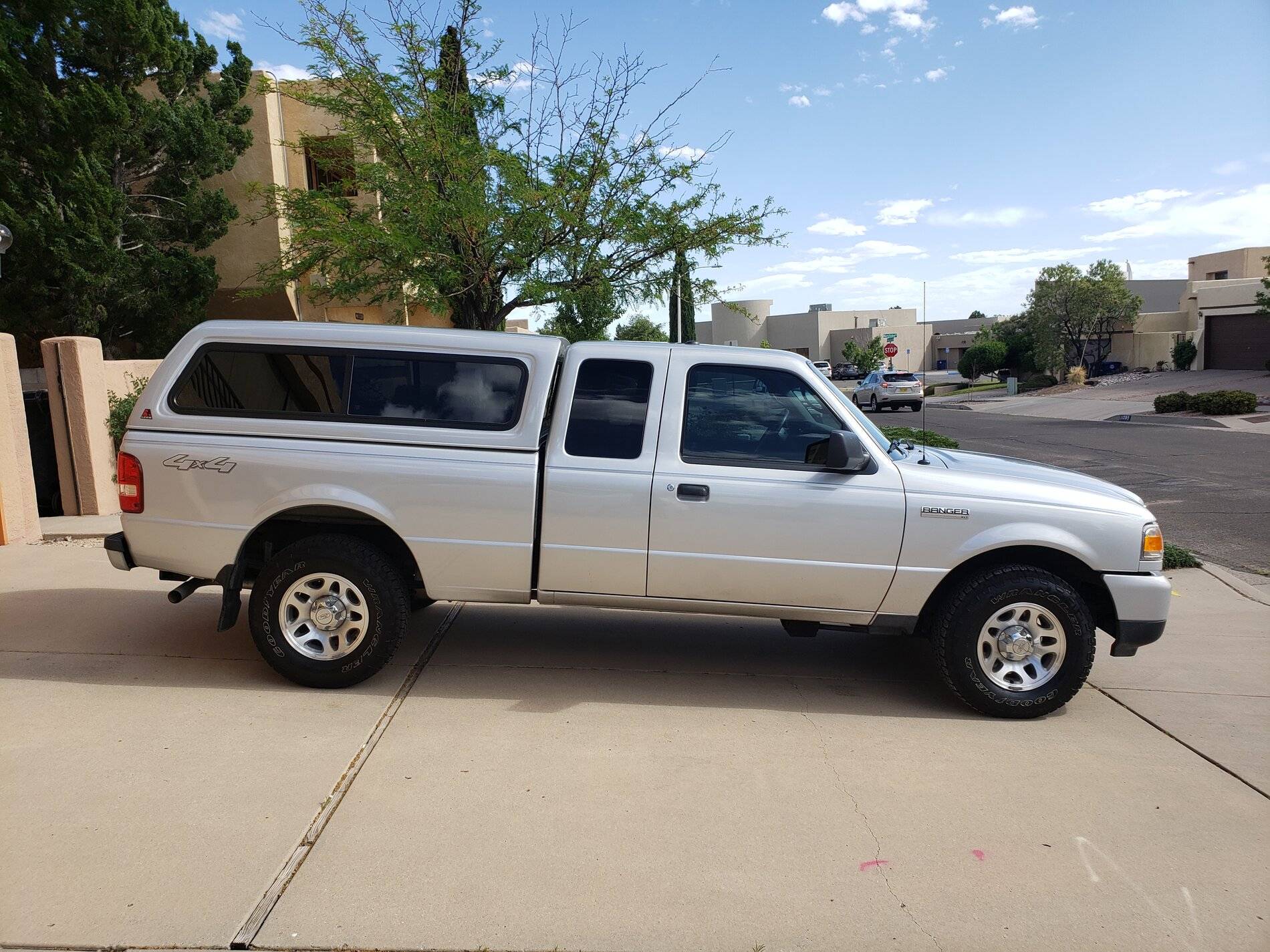

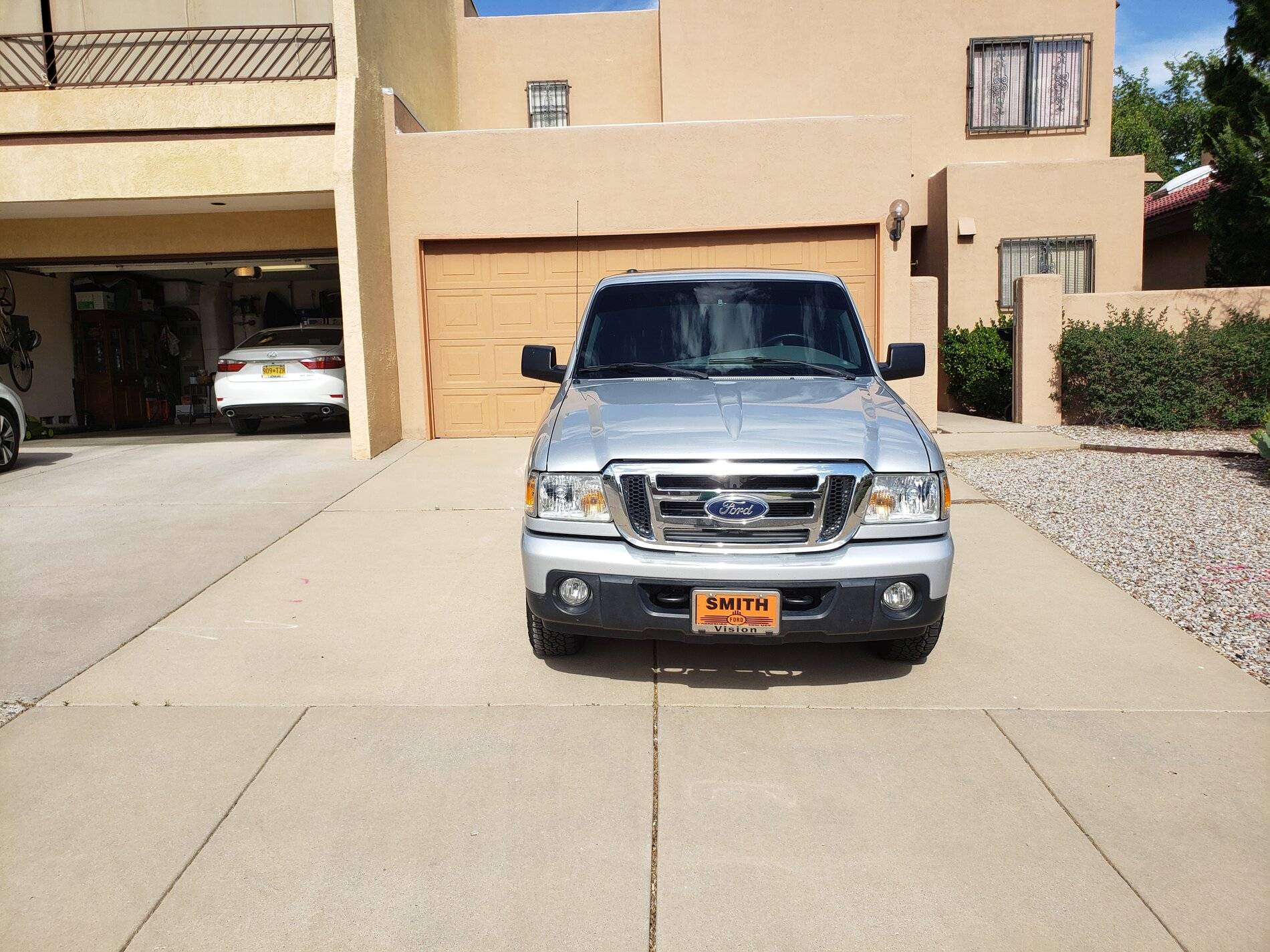

Mine rides fine and no complaints. Like the way it handle's. After all a Truck should ride like a Truck especially with a 4X4 stiffer suspension. I had a 2011 Ranger 4X4 which rode well too. I just upgraded to 265/70/17's from the factory size, so looking forward to test and see how they ride.

and yes.....people....please stop spreading the misconception that the transmission adaptive process "learns your driving style"
that is simply incorrect.
Let's not get hung up on semantics....
It shifts based on input from the driver. Skipping gears if you're more aggressive, not skipping gears if you are less aggressive. Therefore it shifts differently based on who is driving.
That's why some folks say it learns your driving style....
