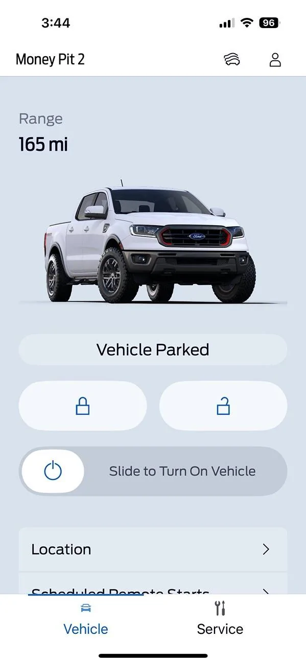

I'm still hopeful that once I'm able to update it it'll go back to normal. Probably wishful thinking but there were a few with a similar problem and once they did the update it went away. ?Ahhhhh ?….
Don’t want to scare you, but….
This is sounding similar to what was happening before ford had to replace the modules for the multimedia stuff, head unit too.
The service manager I deal with is a good guy so he told me they were just going to rip it all out and replace it, haven’t had any issues since…
Did have a few trips prior to it all blacking out, but like all intermittent issues…when you take it to get checked out..
The little suckers hide themselves till they can safely ruin your day again ?
First they walked me through doing the Sync update to version 3.4.23188 then getting the modem to respond which they said hasn't reported since June 3rd. They ended up having to reactive the modem then deactivate my account and reactivate it which took care of all the issues.
) everything would go smoothly. It was really easy to use the USB drive and only took maybe 10 minutes with the agent walking me through it. What took the most time was them diagnosing the issue and I had to be transferred to 3 different agents. But they were all great and it was worth the time getting it fixed.
