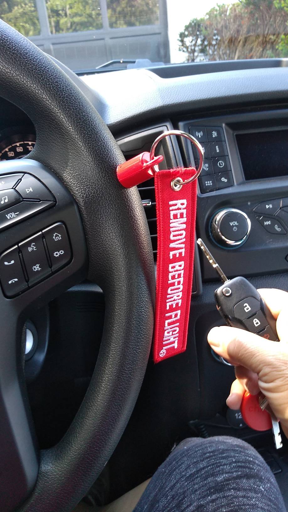

While you're on another buying spree you might want to add one of these to your order. You can lay it in the dash tray, it's a good reminder your truck is hooked up to the maintainer and you don't drive off with it connected.
https://www.amazon.com/dp/B00XWIY7W...olid=1JZJN0W5WUIWA&psc=1&ref_=lv_ov_lig_dp_it

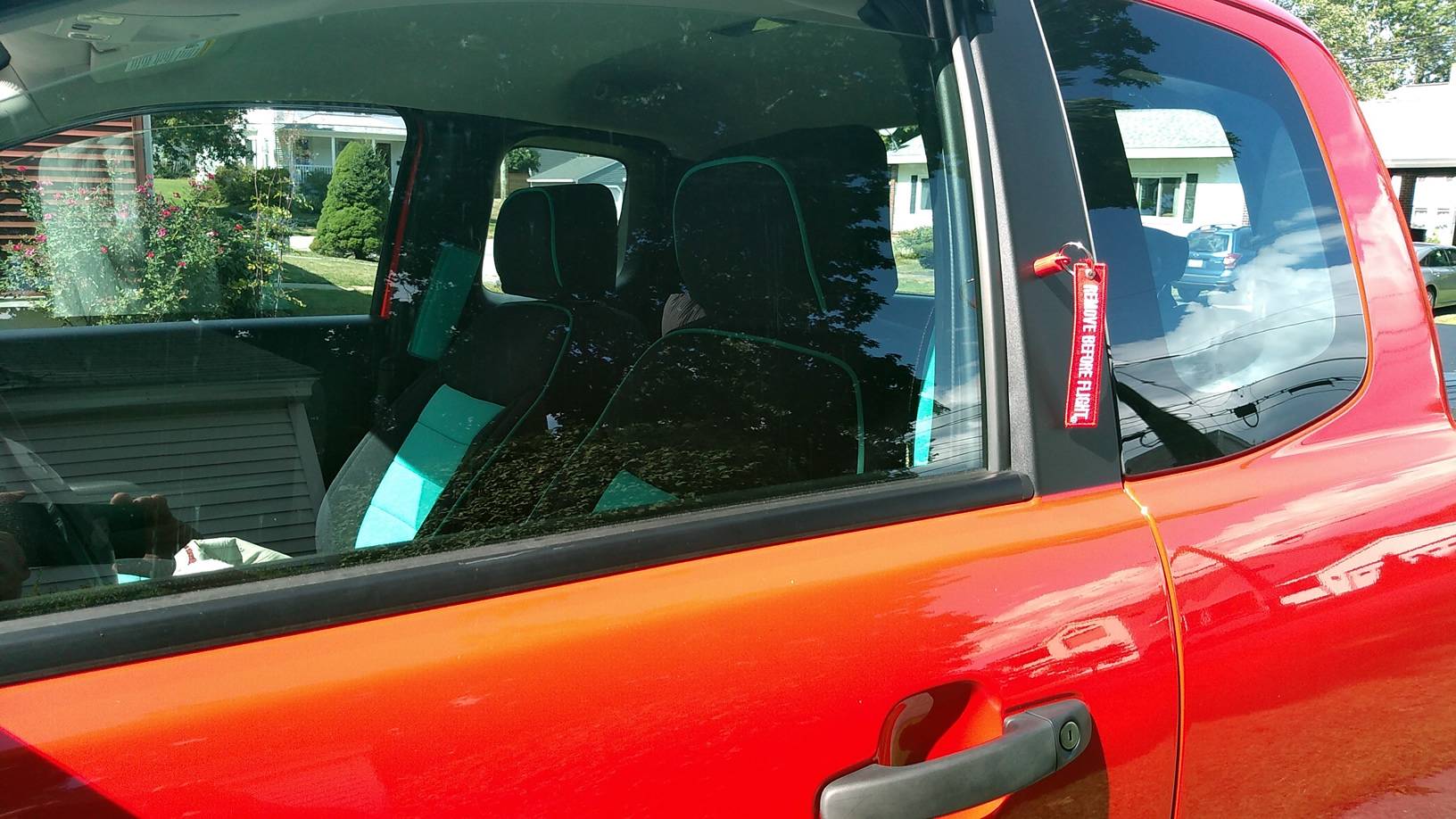

Gonna add a coated magnet to that thing so I can stick it on the door! Thanks!

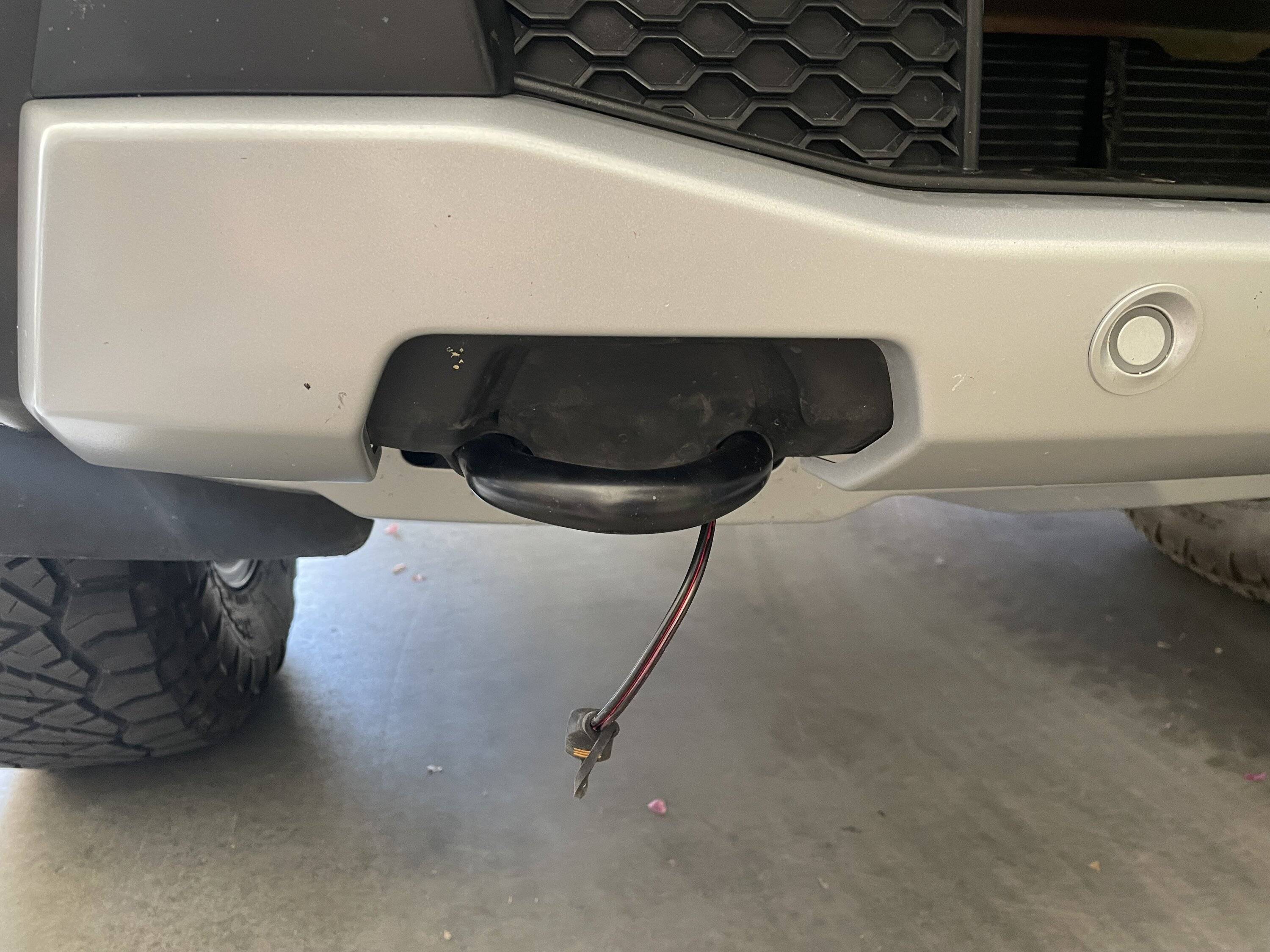

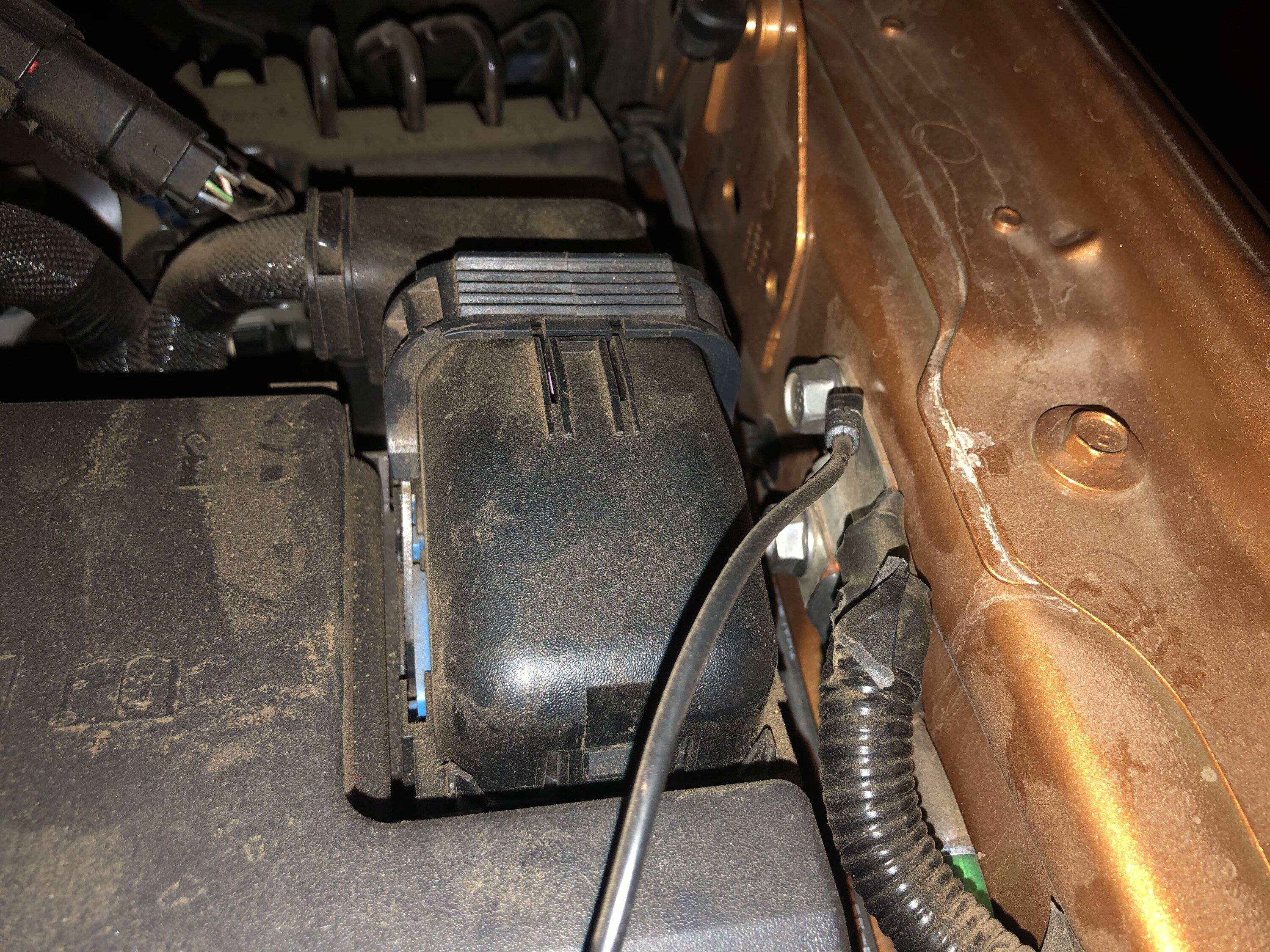

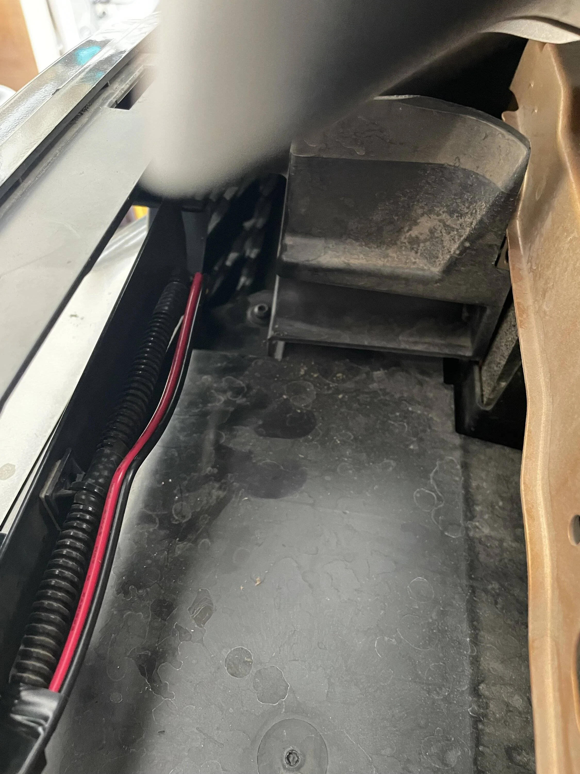

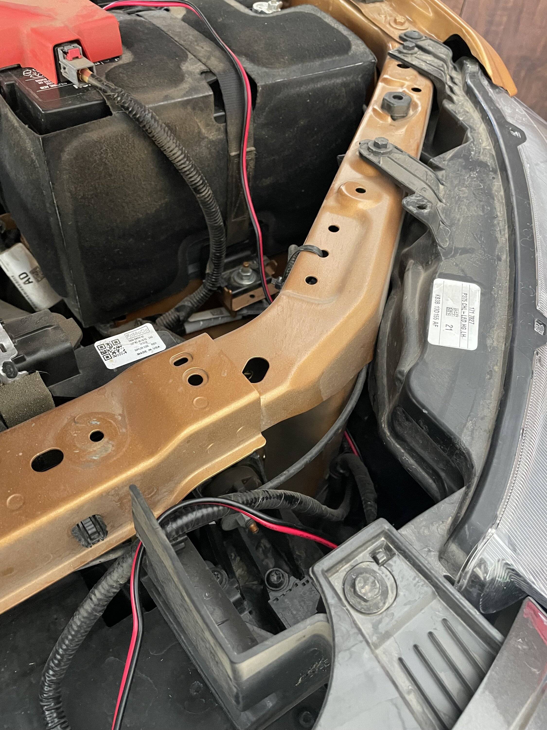

Glynn, I hard wired mine to the battery and ran a longer lead down and out through the front tow hook. This way it's easy to quick connect it without always having to open the hood to attach it.
I bought this one here with my FordPass points but you can by the same one on Amazon cheaper here. This is the longer lead if you decide to go that route.
Just remember to ground it to the body and not to the negative on the battery. This is where I grounded mine.
I ran the longer lead across the front and dropped it down to the tow hook. When you're not using it you can tuck it up inside the rubber boot on the tow hook. If you need any other pictures let me know and I can get some tomorrow when it's lighter outside.

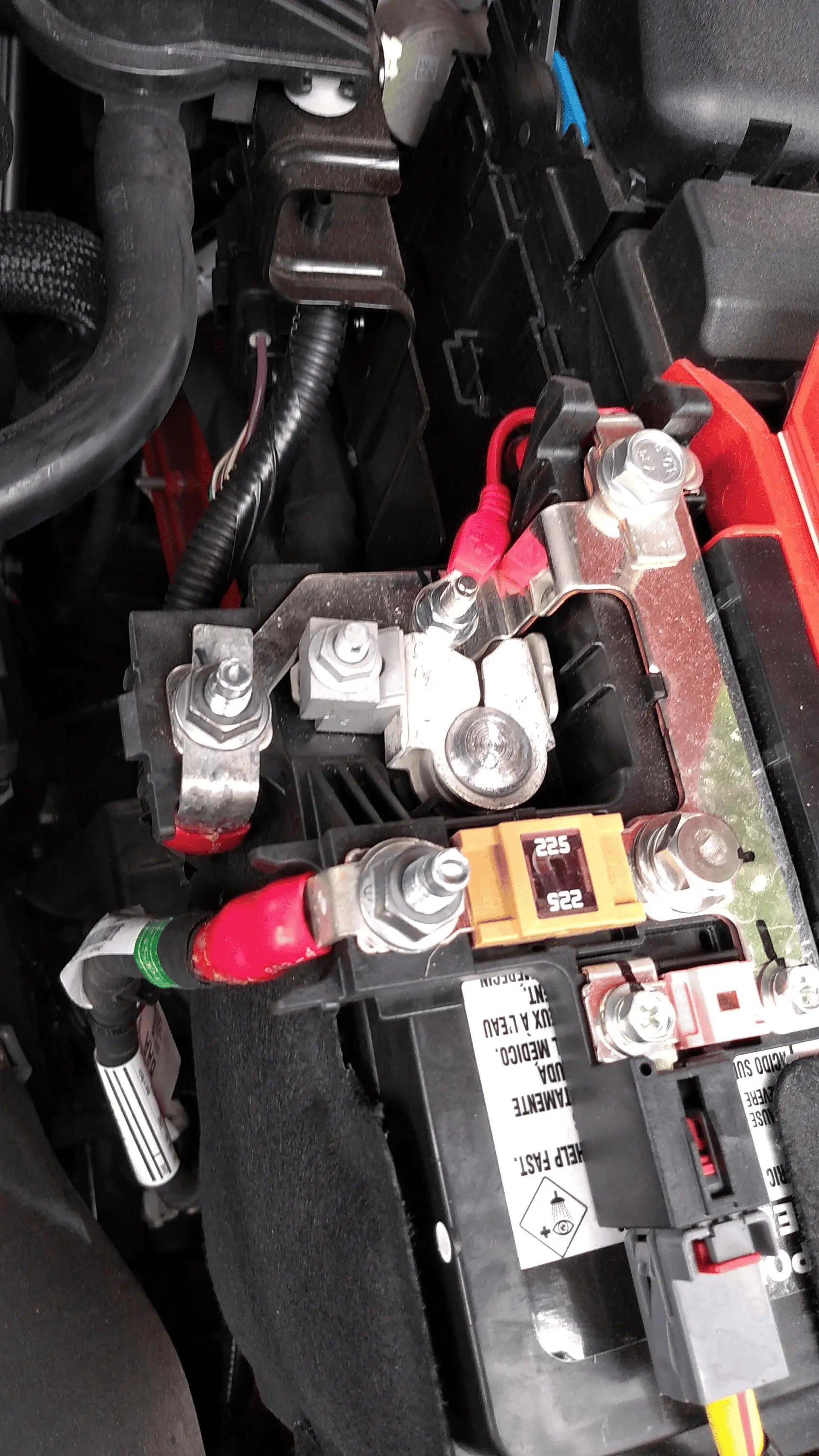

Last question, Where on the positive side? Great photos BTW. And Thank You....

See the red lead and wire? It's above (or to the rear of) the battery post itself.
It should be rotated counter clockwise, right now the red cover binds over it a bit:

The magnet I use is strong enough to firmly catch the metal in the steering heel. It'll also connect outside on the plastic trim behind the driver's window.

Sorry for not seeing this until now Glynn. I had a bunch of notifications while I was away and I guess I must of forgot to come back to this one. Looks like David already helped you out with his picture below. This makes it so much easier to quick connect and the lanyard can be a savior if you forget that you're connected and pull away.

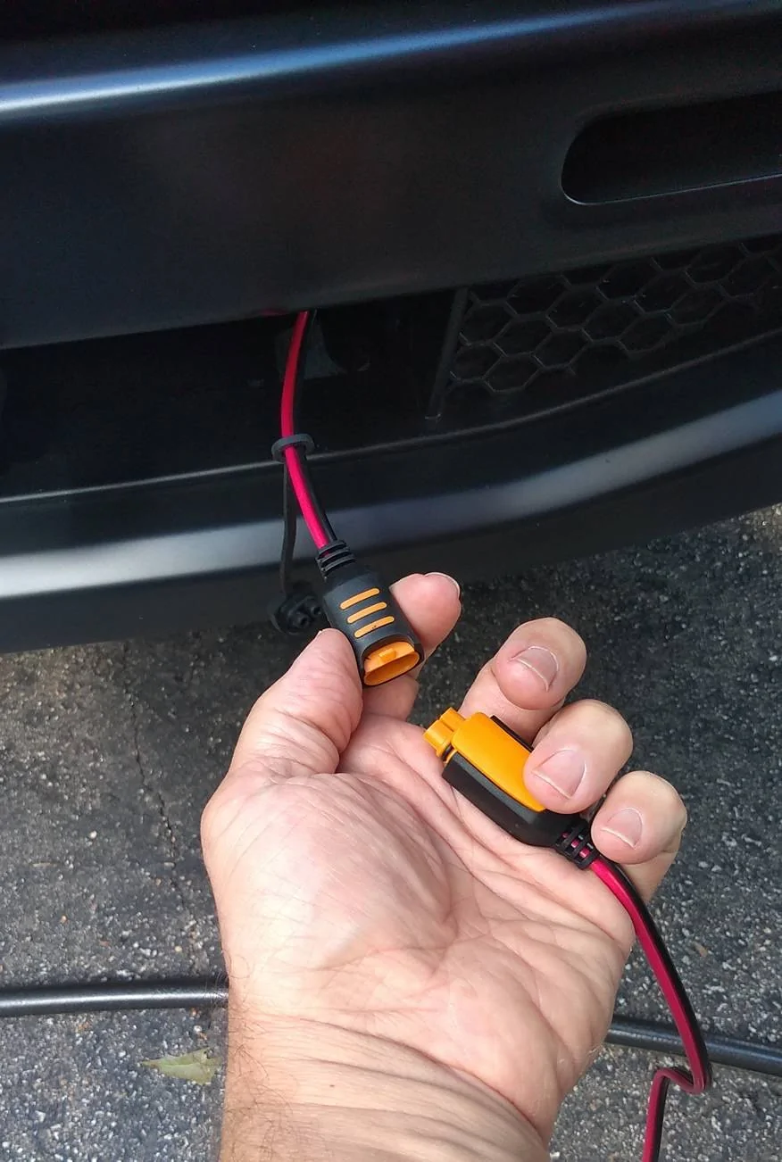

The "extra" leads I got means I leave the CTEK plugged in all the time in the garage and leave the extension cables on a bush branch next to the garage door. I don't have to open the garage, I just need to be within 10 feet of the door and pull out the plug from the bumper and voila!
Also, I think SuperCrews could also stick a magnet where I have it in this pic. I wasn't sure if mine has wider trim for the wider door or not ...

Perfect picture. That is exactly what I did after y'all helped with the pictures. Counted Seven bolts attached here and wanted the right way. Thanks to Subquark and AZ
