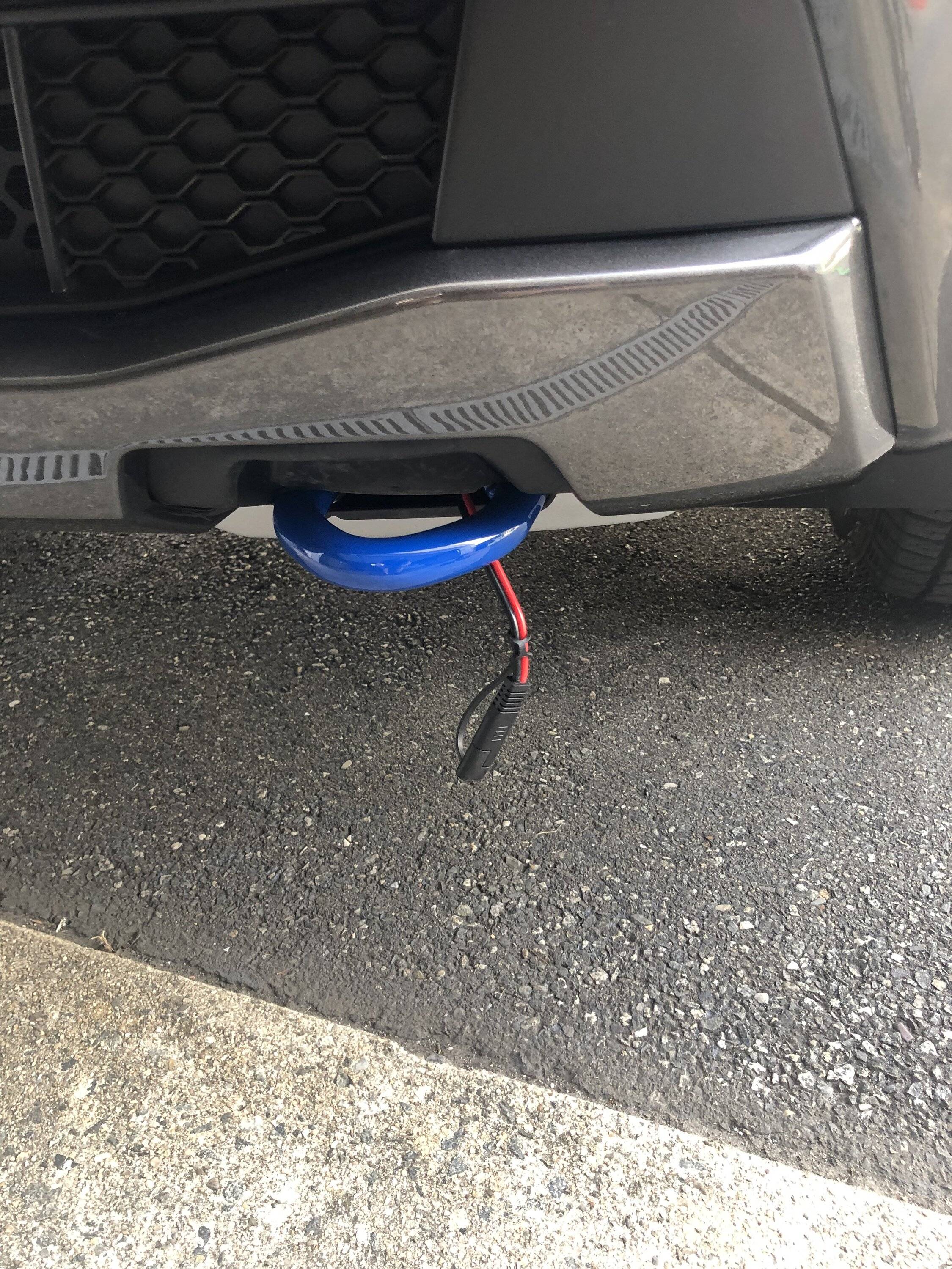

Yes I hard wired mine so I didn't have to lift the hood every time I wanted to connect the maintainer by the clips. The charger itself isn't wired into the engine bay it's still remote and plugs into the wall outlet then the lead from the tow hook plugs into the lead from the charger. The longer leads are only for the quick connect lines running to the maintainer. Sorry if what I said earlier was confusing it's been a long week. lol :crazy:

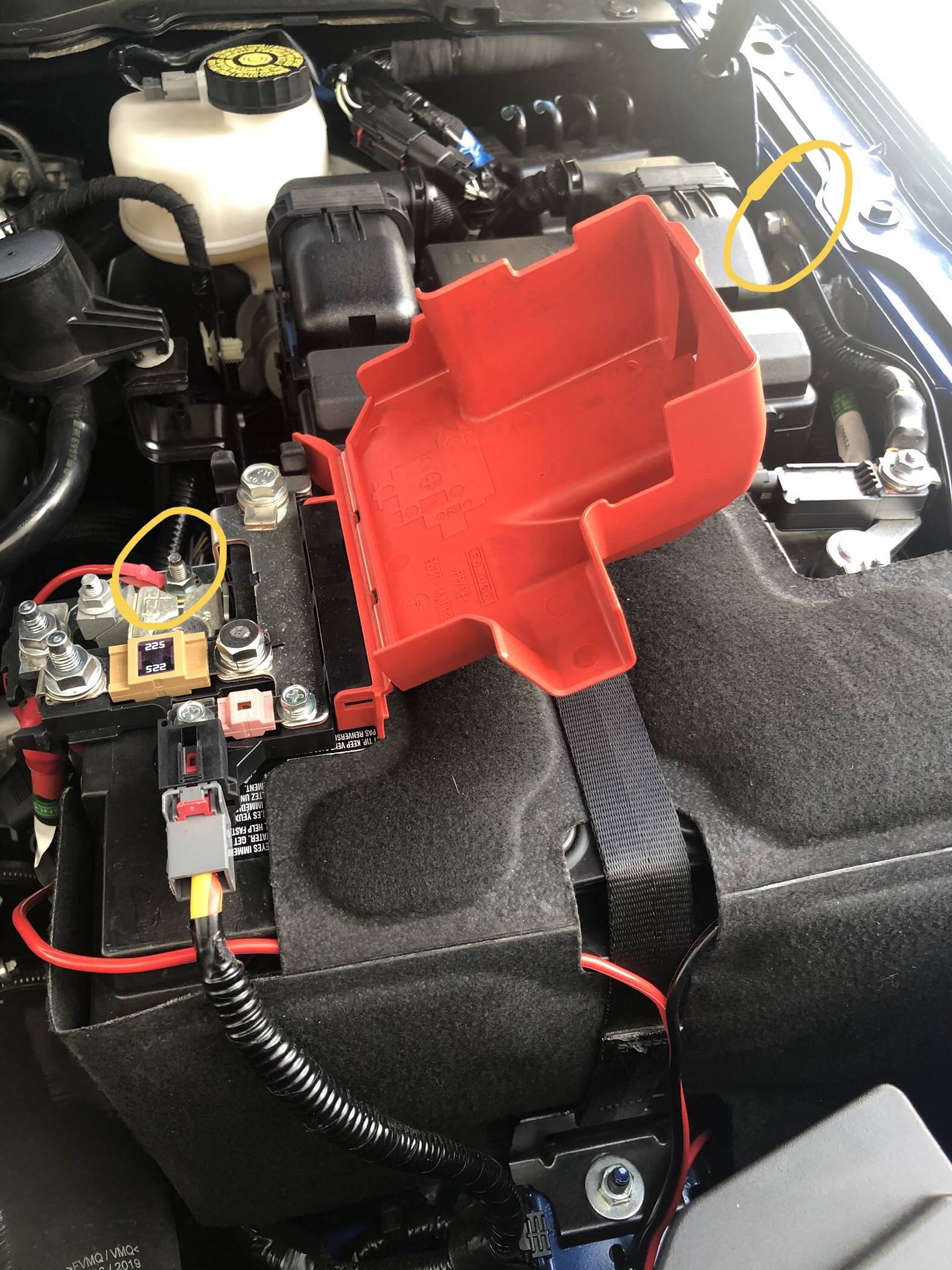

I use the CTEK charger as well. My negative is to chassis and positive on the battery. My BMS system likes it that way. I also added this connector to my grille so I don’t have to open the hood and I can seal it when not in use so it stays clean. Works awesome!

So I have my Battery Tender Plus hard wired. Apparently after reading everything it looks like I may have incorrectly installed mine. Could someone verify if I should ground to chassis even with a BTP? Thanks

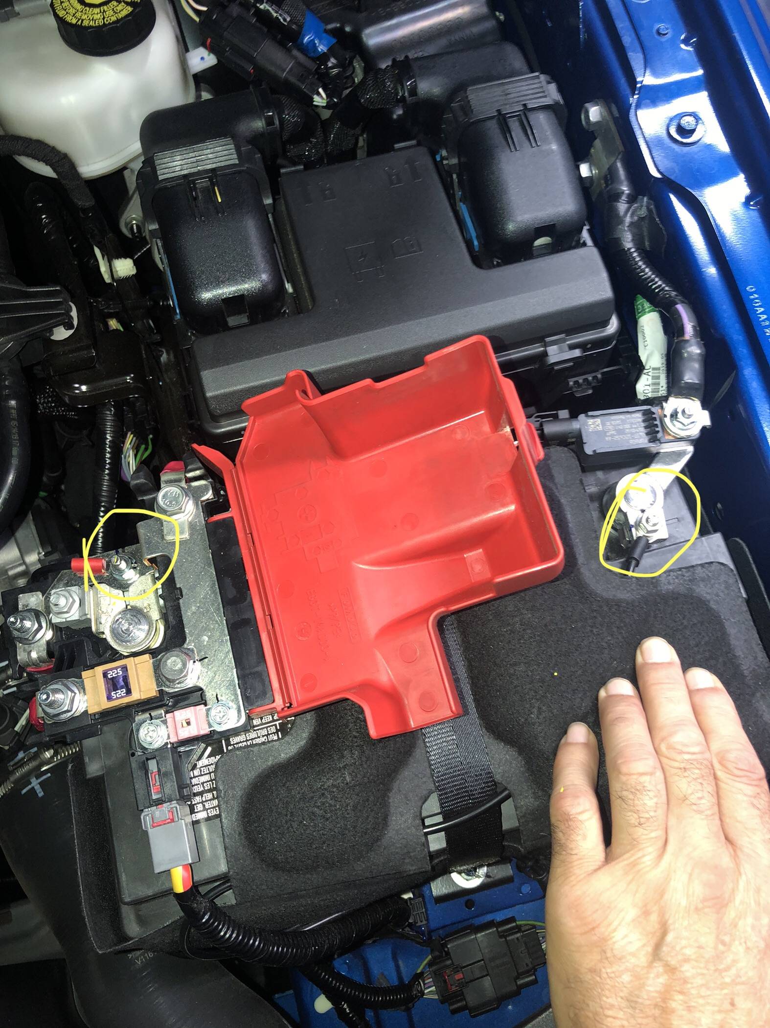

Negative wire should be a chassis connection and not on the battery

Tony you might want to get the 8.5' lead. I know it sounds like a lot but you'll need it to go across the front and down to the tow hook. I didn't know they made a 4' one but that might work if you drop it straight down to the drivers side tow hook. I had to go across because my outlet is on the passengers side.
For the ground see post #7. You have to take that plastic cover off in front of it and use an open end wrench. The screw is long and barely has enough room to come out but it will. Just don't drop it. lol

Hey Dave, yeah I went out after I ordered the lead and realized it wouldn’t be long enough, my 2ft barely makes it past the bottom of the battery. I was able to cancel it and went with a 7ft. Also I’m having mine exit out the drivers side so it sbould be plenty. Thanks for the help and thank you to the OP for bringing this to light. :thumbsup:

Hey Dave. I got the lead today and did the install, also went and grounded to the chassis.. 7ft lead was plenty to pop out the drivers side, I had a little over a foot left. Thanks for the great idea, help and pictures.. Same goes for @RANGERPRIDE, @Trigganometry and the OP for starting this thread!
