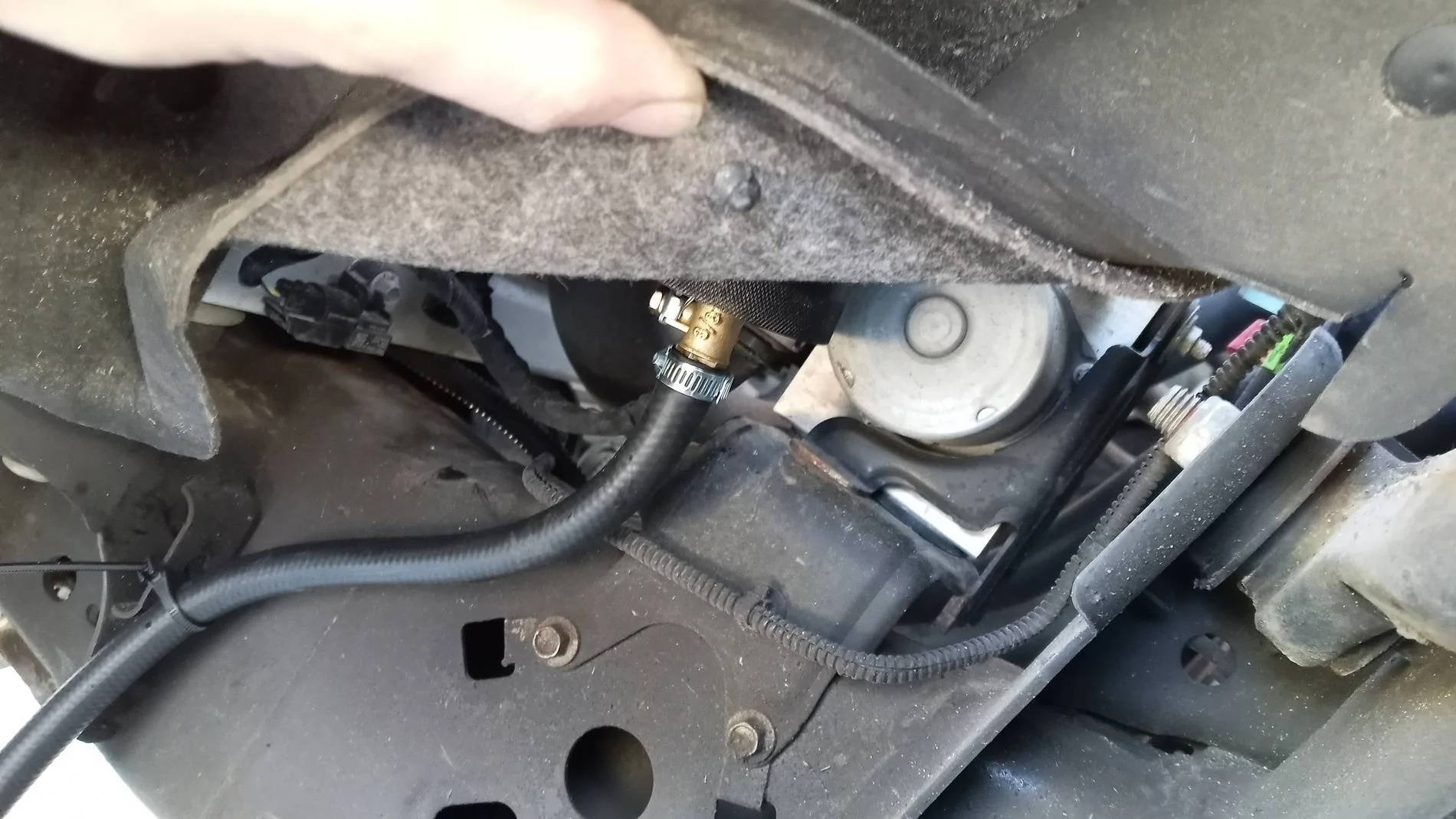

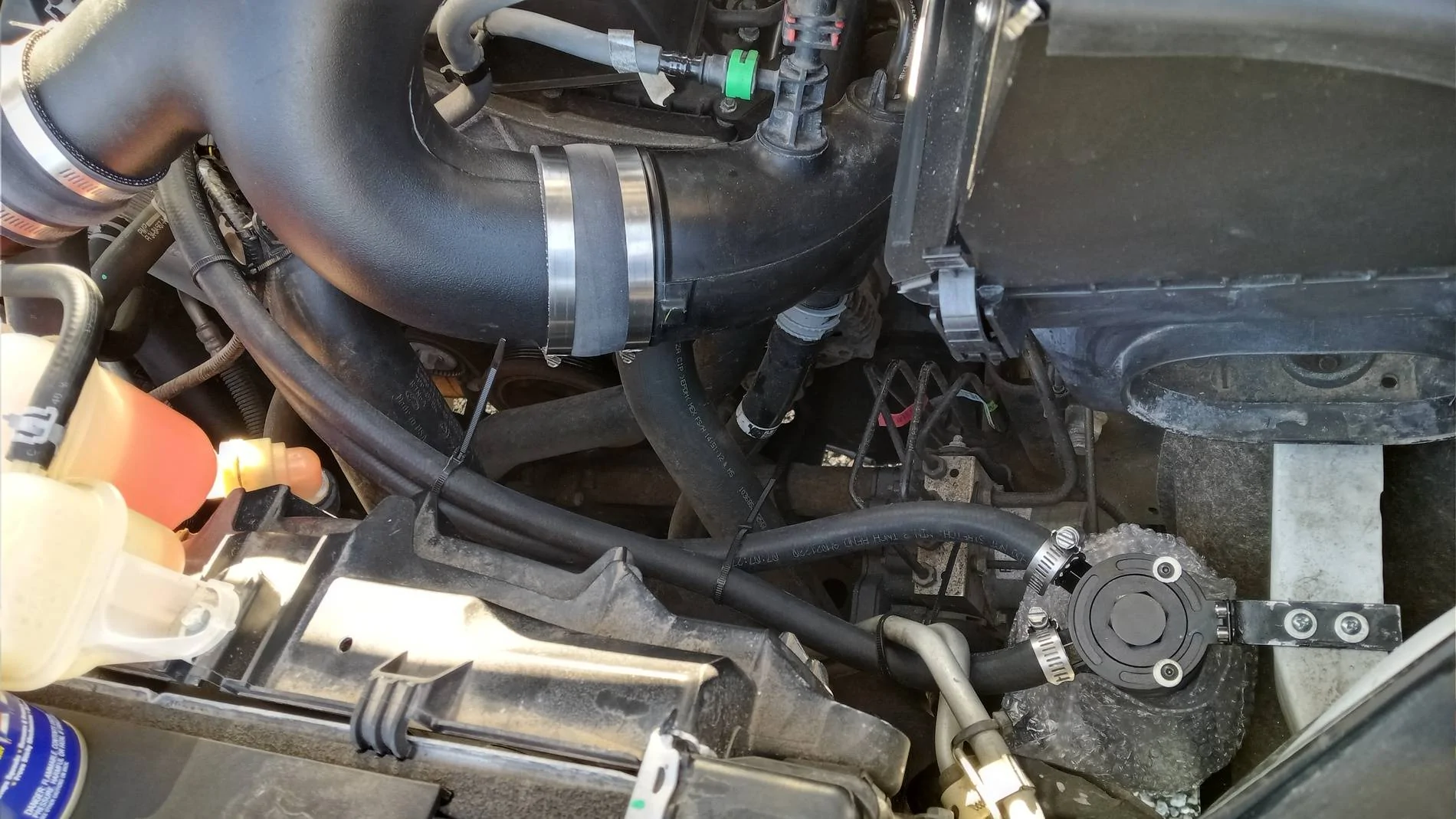

Here's my F150s catch can.
took me 2 hours to route the lines(I had plastic lines, had to downgrade to rubber hose for it to work). Cans 10" long and 3.5" diameter, made it imposible to mount anywhere top side due to fords hatered of having engine bays with room.
Drain valve with long hose can be accessed through fender liner.
Because I'm mentally challenged, I plan to repeat the the difficult task on the ranger.. Whenever ford builds it.

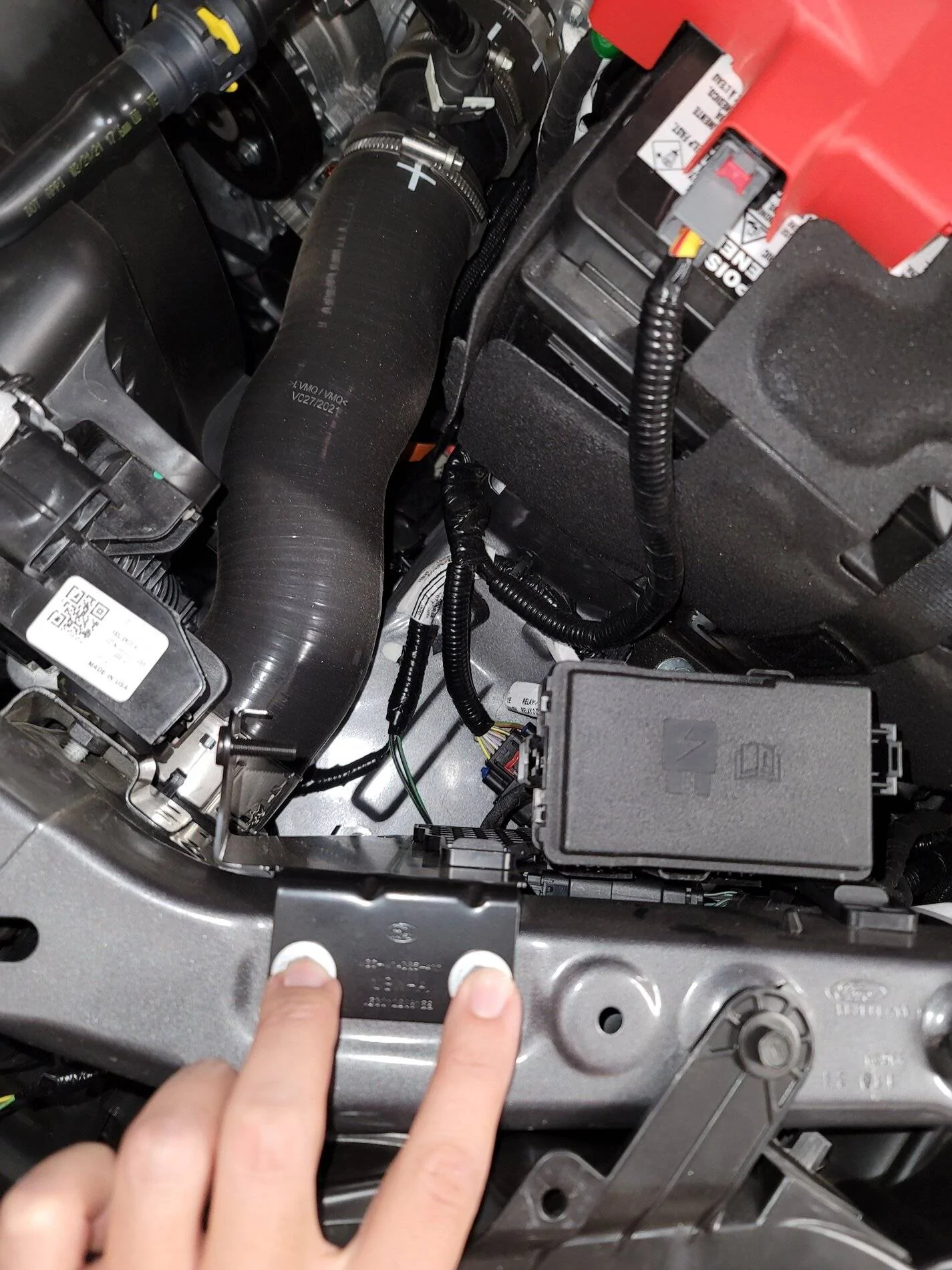

How did you mount the canister ? I'm also trying to install mine and the location that it's supposed to get mounted in is occupied by a fuse box bracket ?

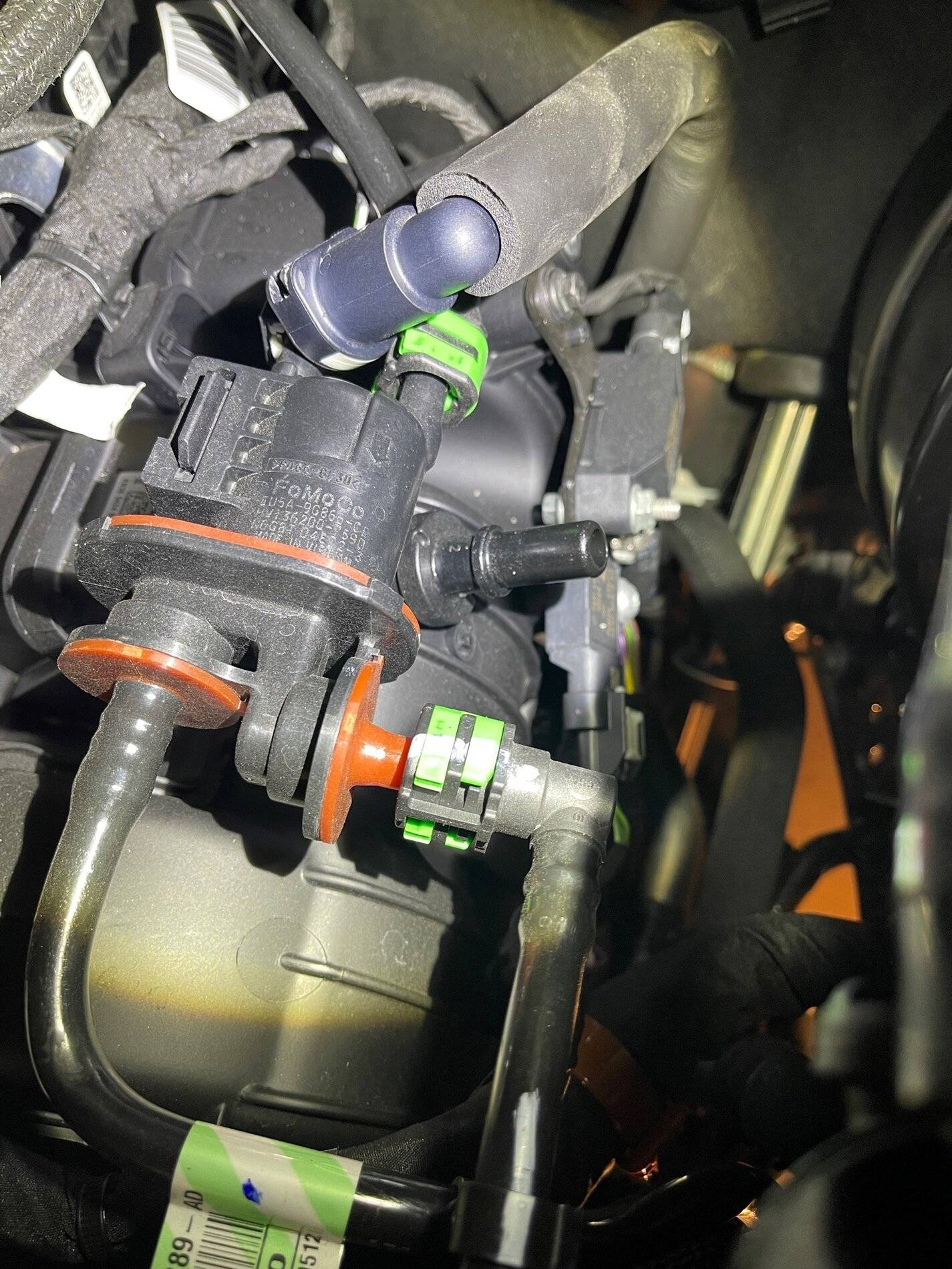

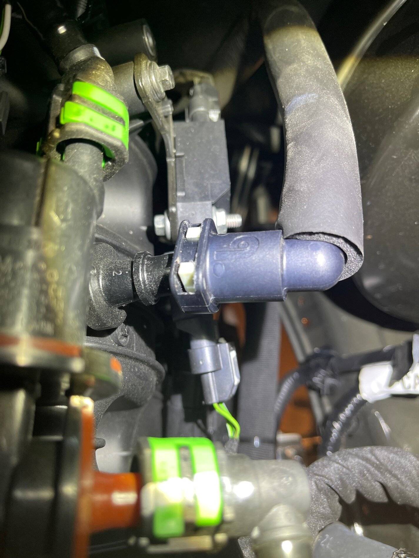

So... I'm installing my Mishimoto oil catch can... or trying to.
I'm looking for the damn hose. The only hose I can find with a blue connector goes from a reddish orange L-shaped male connector that is spot on for where it should be in the Mishimoto install video. But, that hose goes up to the top of the engine and does not have the same quick connect, but is attached to a black straight male connector.
Here are pictures of that end. The other end, with the blue quick connect looks exactly like what is in the videos for 2019-2020 installs. I can't find a video for anyone installing on a 2021. Maybe Ford changed it? I don't see why....
Any insight or help?
Is this view from top of engine? Bottom?
