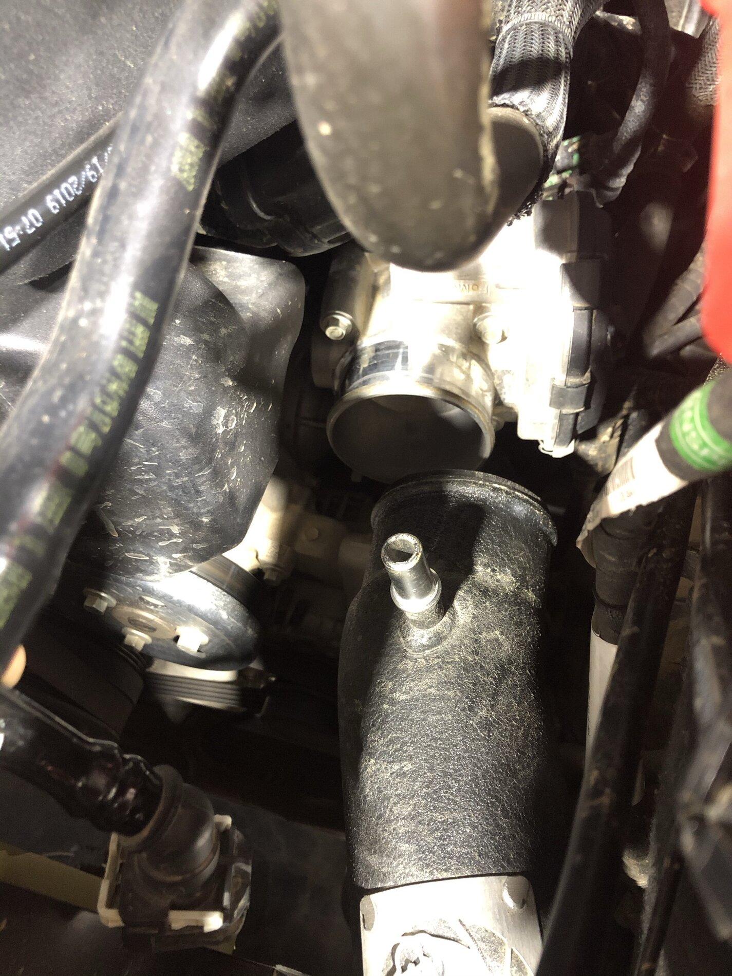

Everyone with aFE Charge pipes please note: My cold side tube would not line up with the Mishimoto intercooler - as it was about 1 inch off from lining up with the throttle body.
I ended up having to reuse my old stock pipe.
I had zero issues. I have the afe charge pipes and they fit up just fine. Try loosening all the connections and tightening it all up once the tubes are mated. Everything fits in the stock positions so there should be no fitment problems
Lol I tried everything and loosening the connections was the very first thing.. Must be a manufacturing defect on my intercooler or cold side pipe. Here’s where it was after mounting to the mishimoto IC. You can see here how off it was from lining up with the throttle body.
[/QUOTE]
I would say an issue with AFE. To say the least I have not been impressed with thier products over the years.
[/QUOTE]
When you installed the intercooler did you put the rubber gromits back on properly??

I had a very experienced mechanic who works on all the Rangers in the southeast ranger Facebook group do the install. He’s done about 4 intercooler installs on Rangers by now.
He tried everything and we both troubleshot and tried to find a solution other than going back to the stock pipe.
