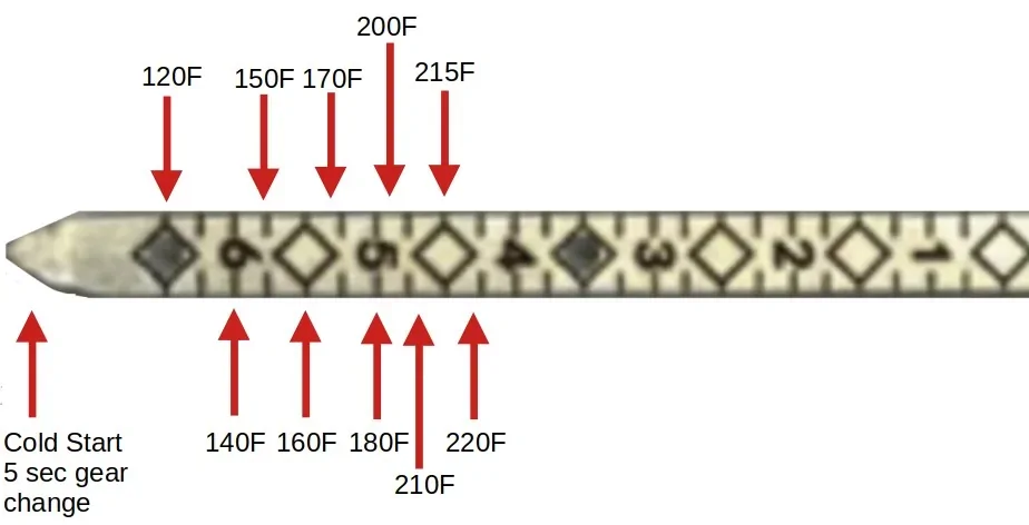

On the fitzstick, i am considering getting. The way I read it is, with the engine at normal operating temp then on the fitzstick the fluid level should be between 4 and 5 ? Is that right ? If so where on the dipstick should it be with a cold engine ?
Slightly below 5 usually.
I always recommend checking it hot just like the factory, but, like ctechbob said that just below 5 idling in park cold will be in the proper range hot.

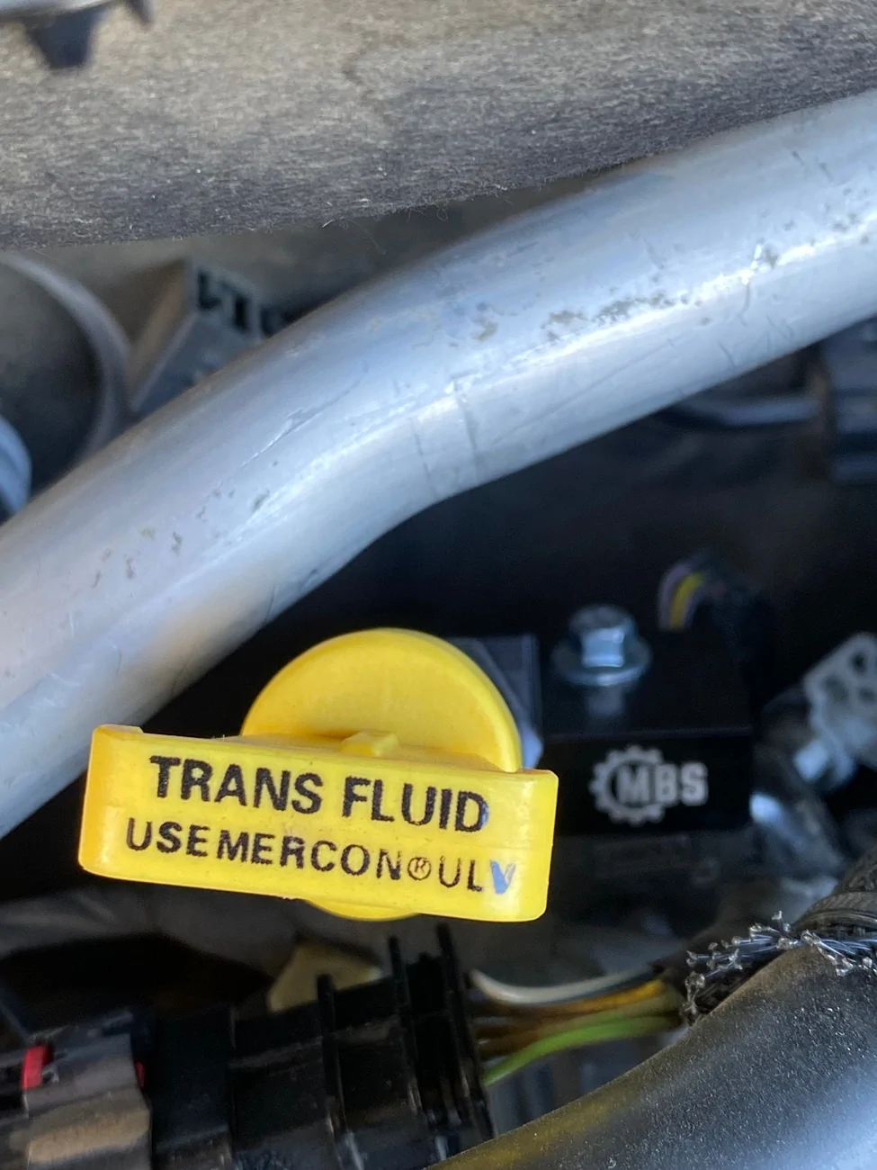

Another Happy Customer !
Great customer service, excellent packaging and fast shipping 👍
Installed the new Fitzstick and what do you know, almost a full quart low in my 2023.Pop in the new funnel that was provided in the package and topped her off 👍 So Stoked !!!
A cold engine would be an incorrect method of checking the fluid...
Engine temp has nothing to do with it. You need to me monitoring the trans temp. There's very little link to engine temp most of the time.

The transmission fluid temperature needs to be between 206F - 215F, and truck must be on level ground. Then fill until fluid level is between 4 and 5.
That said, I have filled the transmission using the Ford method and then tracked the fluid level at different temperatures. Each of the measurements below are with the same fluid quantity, just at different temperatures.
For instance, if your transmission fluid temperature is between 140F - 180F, your fluid level will be between 5 and 6. It took my truck idling (from an overnight cold start) 21.5 minutes for the transmission fluid to reach 150F. For all the details read the attached PDF.
The cold start level is exactly that. Start your truck, promptly run it through gears at 5 second intervals, park to sport, then backtrack to park. Immediately check your fluid level. It should just be showing on the tip of the dip stick.
I took the measurement at 75F (fluid temp at 77.4F). These initial temps were taken with the truck on but not running using my D8 diagnostic tool (before the truck was started). Truck was level.
There is a little wiggle room as I filled the transmission to the diamond (the middle of the fluid range) at 215F (the top of the fluid temp range).
Using this method eliminates the need to go to 215F to obtain an accurate fluid level.
