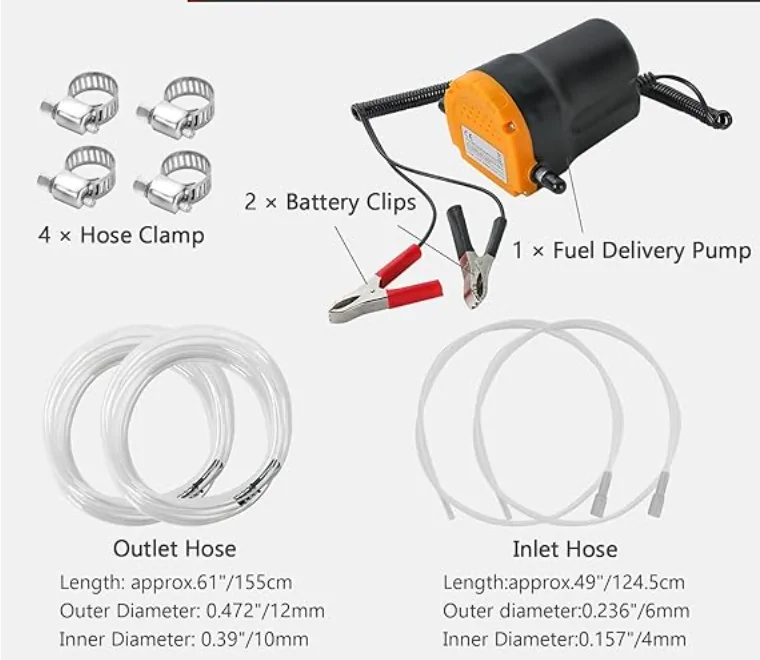

Suck the fluid out through the dipstick with a $16 pump from Amazon, and refill. I do it in under 35 minutes and never spill a drop....going out or putting in.
Which pump do you have? I bought a manual one from Harbor Freight and the hose wouldn't fit down the tube.
6,045
30,193
I bought a Dasbet 12 Volt Oil Change Pump Extractor on Amazon....$14.00. Works extremely well and included a hose that slid down the Fitzstick tube.
Now have an Expedition....no Fitzstick but planning on still using the pump to extract and fill trans using the OE dipstick.....
This one from Amazon which is now $13.99. Has everything you need, except for two 1 gallon milk jugs. I did weight the outlet hose with a brass fitting just to keep it in the milk jug. It wants to curl up.
And before beginning I poured 1 quart of water into the jugs marking each quart with a black sharpie so I could easily determine what I pulled out.
I then just put that amount back in. Don't forget the LubeGuard Platinum!
I also use a 50 year old 12v analog battery charger to power the pump. Easier on the battery.
One last thought and I really shouldn't have to say this. Seems obvious to me.... Use the hose clamps to secure the hoses to the pump. Transmission fluid is slippery and those hoses will fly off under pressure. I recall someone complaining about this happening.
Click on the link below to go the Amazon entry.
DASBET 12V 60W Oil Change Pump Extractor, Oil/Diesel Fluid Pump Extractor Scavenge Suction Oil Change Pump Transfer Oil Removal Pump for Oil Change Tubes Truck Rv Boat ATV (Yellow)
6,045
30,193
Times 2 ^^^^,
Exactly what I did using clear one gallon distilled water jugs, clamps, and weights. Do it right and you won't spill one drop of tranny fluid.
