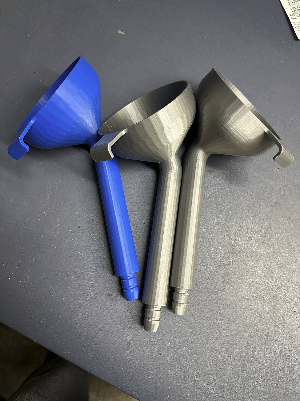

I'm glad it went well, and yes, the fluid is thin and clear, low light is the best way to read it.
I found that if I use the amber marker light and look for the reflection, or the clean towel method also works well.
Bright sunlight reflects too much off the shiny stick, I have tried bead blasting the sticks, scoring, scuffing and Scotch-Brite, nothing really helps, the fluid is so thin.
As for the funnels, what I thought to be a easy solution has not been easy, I have printed 20+ funnel fails, the ABS is a difficult material to print, the PLA prints perfectly.
But.... fingers crossed, through a mistake, I may be good to go now. I thought after so many fails, I should buy the OEM material from the printer company, so I did, still problems, changed settings, still problems, changed settings again.
I was about to give up. I tried again, but I forgot to assign the OEM material in the program, it defaulted to the non OEM material, it printed perfectly, so I have one great copy, hopefully the rest will be the same, the silver is the OEM plastic, the blue is the cheap Amazon stuff.
So just maybe I will have funnels available, a bit early to tell, but I finally have a clean printing.

The right most funnel looks perfect!
Congrats!
You are a craftsman. Not many left in this world.
I find projects move in increments. I call it "polishing the stone" Small incremental improvements all add up to a great finished product.
Your funnel work followed the same creative process. You know a great deal about what didn't work, and discovered what did!
Feels satisfying when you finally achieve success.
