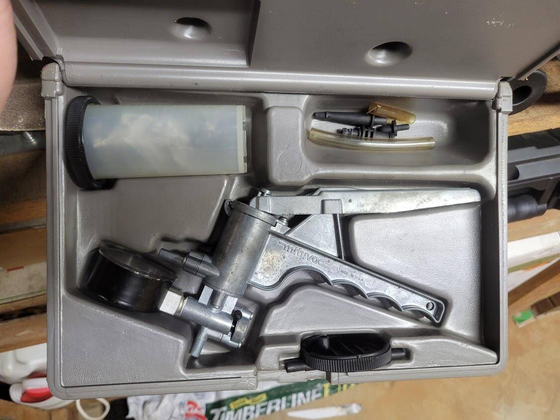

Mean time I remembered I had this, and all I need is some longer hose. It's many years old. A NAPA, Balkamp automotive service, brake bleed kit. It doesn't move a lot of volume, but is super heavy duty and can create some decent vacuum or pressure.
