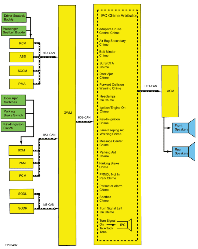

IPC is actually from a small speaker in the IPC.
You are correct, the manuals are vague, this diagram is the only thing that depicts the Turn Indicator speaker is internal to the IPC itself.
Turn Signal On Chime Tone
The IPC provides a repetitive 1-second on/off tick-tock chime tone along with visual RH or LH turn indicators to inform the driver the turn signal or hazard lamp function is on.
The IPC receives the left turn lamp on request and right turn lamp on request messages from the GWM over the HS-CAN3 .
The GWM receives the left turn lamp on request and right turn lamp on request messages from the BCM over the HS-CAN1 .
Turn Signal Left On Chime
The turn signal left on or turn signal minder chime uses both odometer and turn signal status messages. The turn signal left on chime sounds a repetitive 1-second chime through the front speakers when the vehicle is driven with the turn signal on for more than 3.2 km (2.0 miles).
The IPC receives the turn signal switch status and odometer count from the GWM over the HS-CAN3 .
The GWM receives the turn signal switch status from the BCM over the HS-CAN1 .
The GWM receives the odometer count from the PCM over the HS-CAN1 .
When a chime request is received, the IPC sends the IPC chime request message to the ACM to sound the chime.
