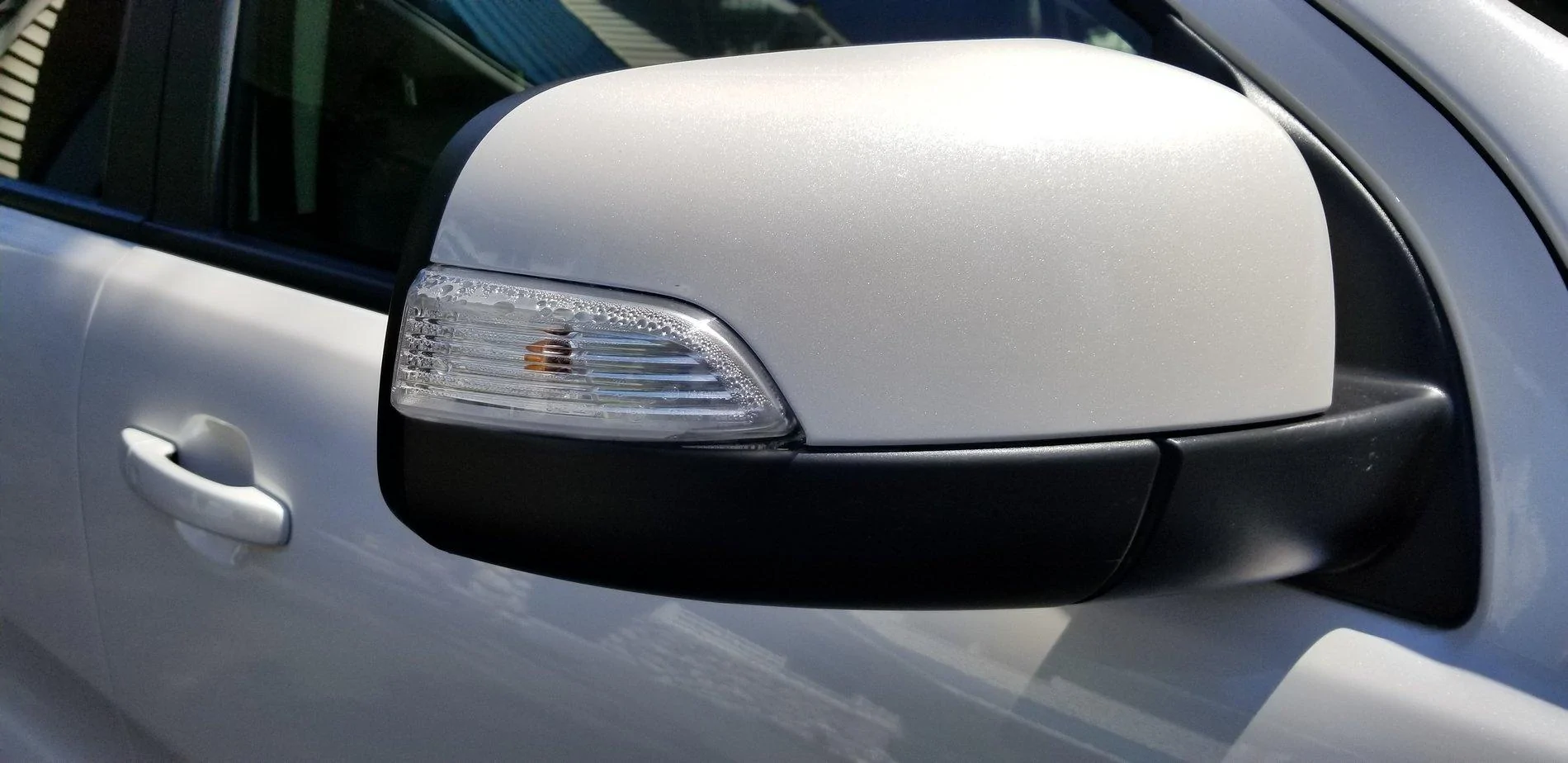

I wonder if anyone else has seen this. I washed my truck today and when drying it, I noticed the passenger mirror turn signal had some water in it:
Has anyone else noticed this on their truck? Is it something I should be concerned about? I've seen cars with moisture in taillights before. The drivers side is dry - it is just the passenger side that has a bit of moisture in it.

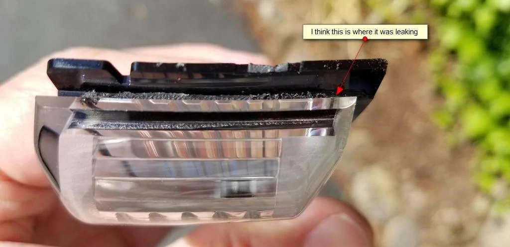

After following the hints in this thread:
https://www.ranger5g.com/forum/threads/exterior-light-bulb-replacement.1998/page-2
I was able to successfully remove the mirror cover and then the light assembly - I used air to blow out most of the water and then left it in the sunlight for an hour or so to make sure it was dry. Then I applied some sealer around the light - as @mike said earlier in this thread, the sealant in these fixtures/lenses is pretty wimpy. I think I saw where there was an opening in the edge of the light, but when I blew it out you could see water escaping around a bunch of the edges. I put a bit of sealant all the way around the lens so hopefully I won't have any more trouble. I will keep an eye on if for a while to make sure.
Here is a picture showing where I think it was leaking:
That is the reason I LOVE this forum. You guys just saved me the hassle of taking this in to the dealer. Drop it off on my way to work, wait for the shuttle to take me to work, then wait for the call, and then wait for the shuttle driver to come and get me from work. A big pain for such a little problem. Thank you!
