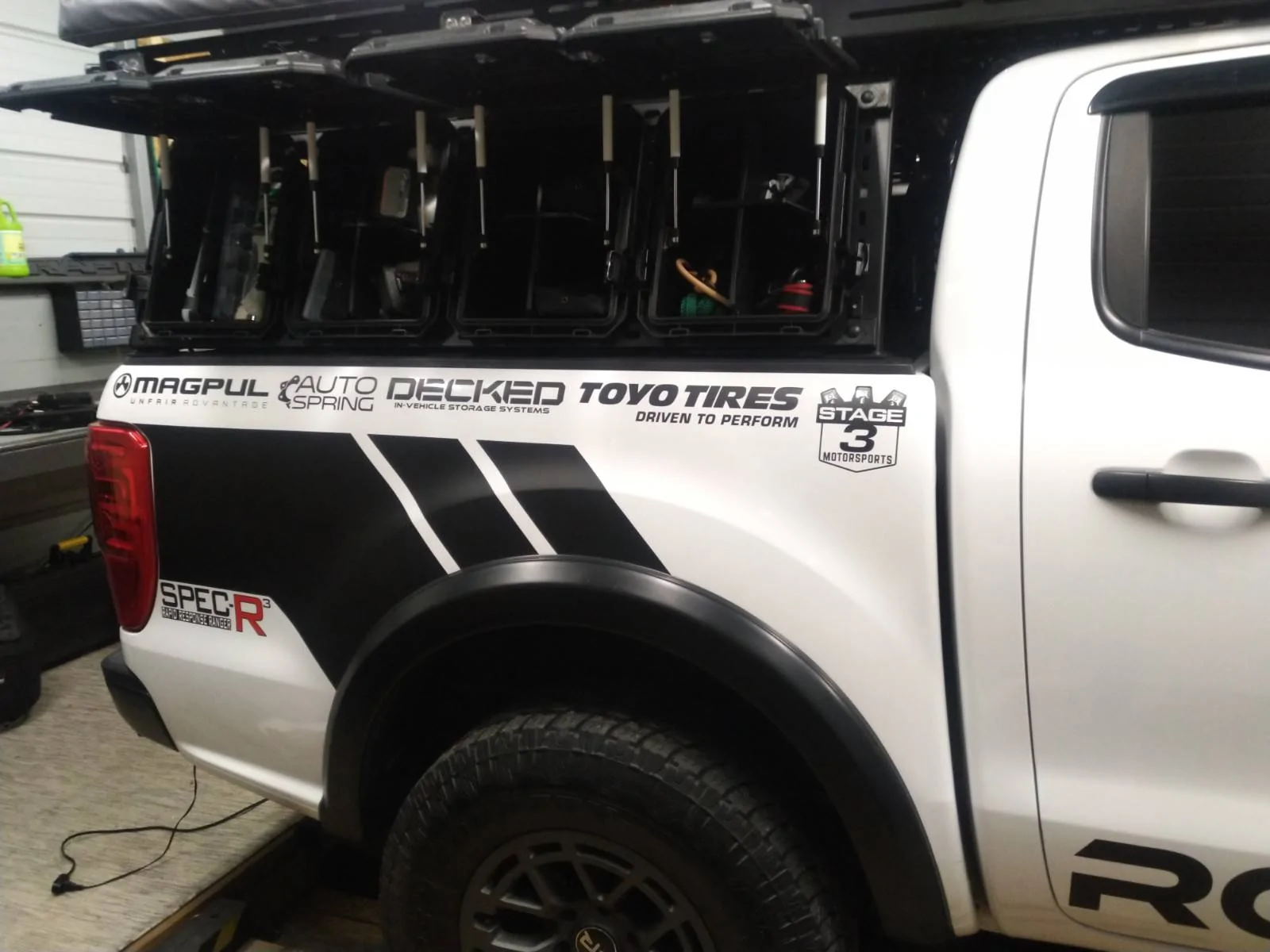

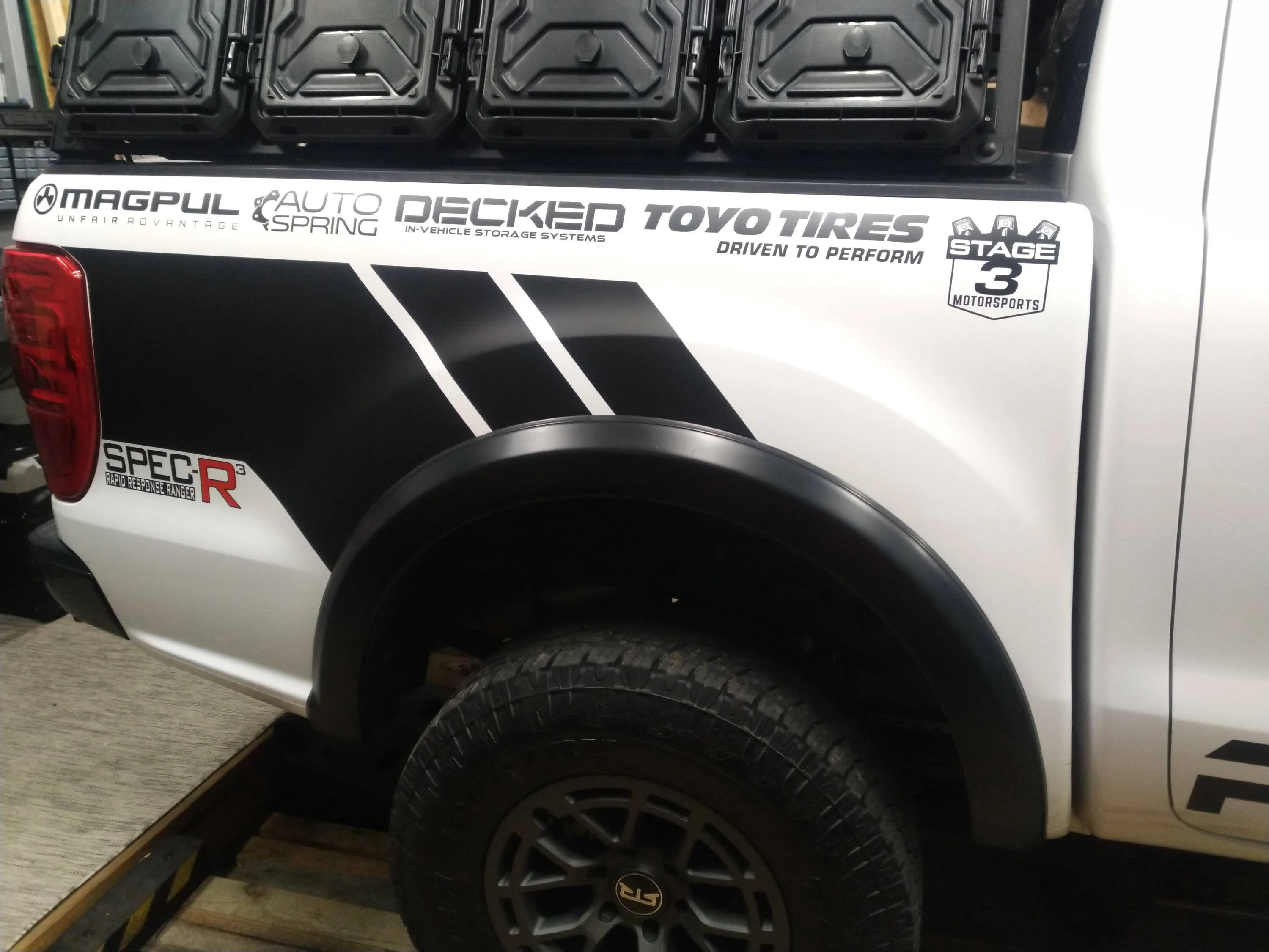

Wow holy crap. I guess it was like a boiling water affect, as time went on I added more and more gear I failed to pay attention. The only downside is my tallest roof trunks are about 2" too tall to fit through the garage door now. lol
Oh well.
I also opted to keep my 1" eibach blocks installed because unlike most, I will be retaining a constant heavy load in an almost permanent configuration. Now I retain my 1+ " height in the rear when fully loaded instead of a bit of drop from said load even with the leaf helpers in.
Also gives me a very small rake, which I actually prefer in this setup.
Pictures say it all, shesh.

Being fully loaded it is ok to be level or have small rake. That is the purpose of a truck having rake in the first place.
Wich helpers did you get? Also with all that weight how is the ride with the new helpers installed?

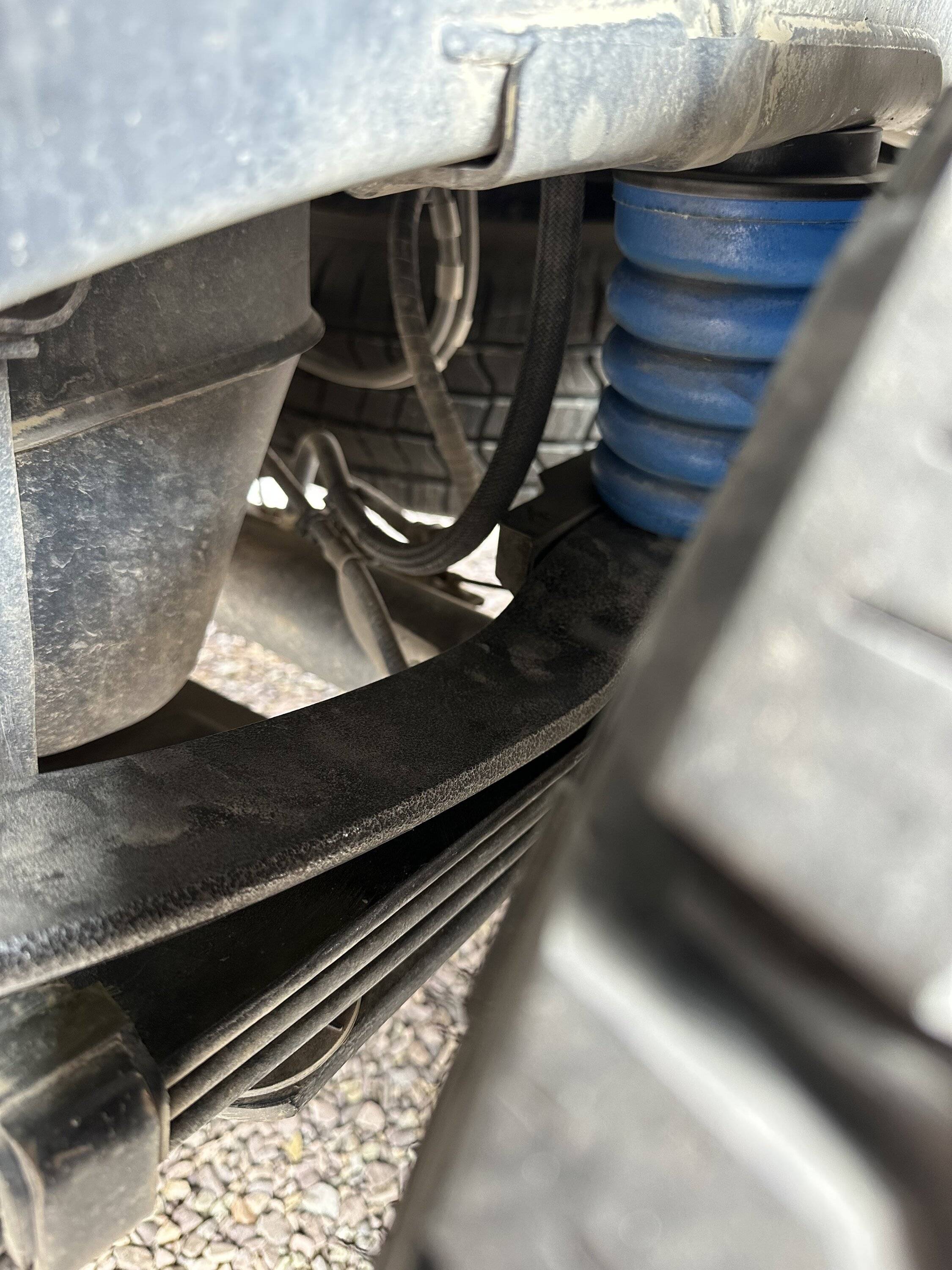

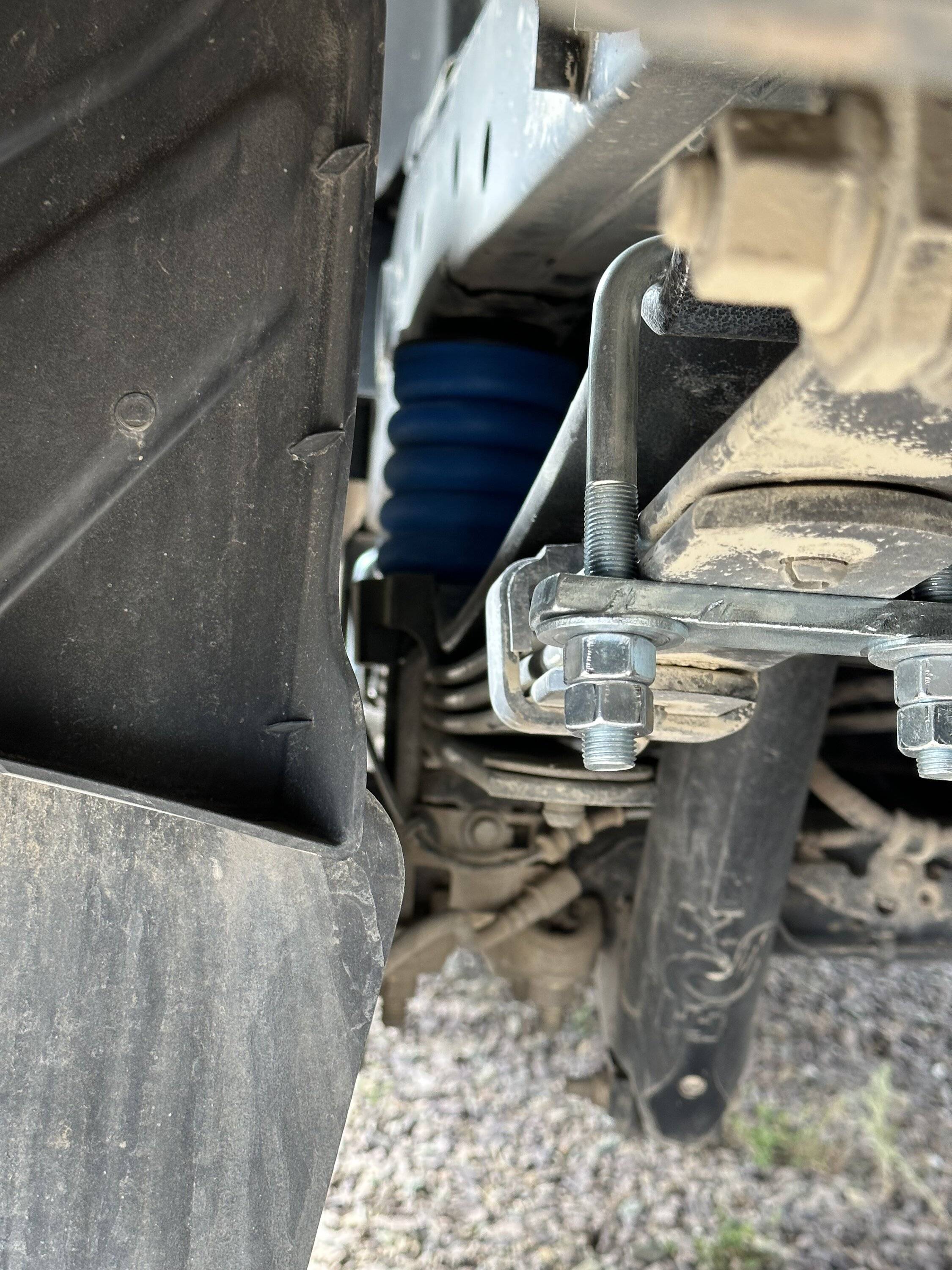

I went with autospring. Pair of 750lb helpers was $260. Install is just drop in between top leaf and bottom overload leaf.
Small jaunt after install; My poor eibach felt like factory shocks with all that weight. Much better now.

So after action report after doing about 300 miles round trip over the weekend.
Not much to say other than everything is just flat better. I am now back to properly floating over uneven terrain instead of bouncing over it. Truck seems to handle much better on the highway as well, though not sure if this is a placebo effect or a mixture of both.
No creaking or squeaking either, but these helper leafs did come with proper coating and teflon contact pads, like all should I imagine.

glad you like them. I felt like they were a big improvement on my ranger as well. much more secure feel now instead of the floaty boaty feel on bumps.
