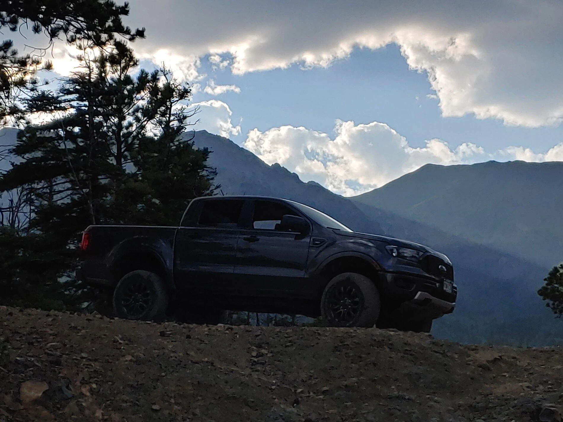

I myself went with Old Man EMU by ARB on my truck and i am running 265/70-17 Bridgestone Dueler Revo 3's with no rubbing what so ever. I have been on the road plenty with this kit and offroad with this kit. The best way for me to describe it is that the Old Man EMU is a nice balanced suspension for on and offroad!! I have even towed with it and the results were great!! The heaviest I got was 5,500 lbs towing my 280ZX and it handled with no problems.
Now you are probably wondering where I go off road? Well I am here in the beautiful state of Colorado and i have been trail hunting quite a bit. I haven't done anything to extreme but i still dont mind a challenge of sorts because why not. I usually hit the easy stuff with some moderate trails since it is a new truck and i dont have a locker(that will be fixed later on). With the Old Man EMU it has given me the clearance and flexibility that i need to get through most anything(within reason that is) and im comfortable at the same time.
Hopefully that is enough info for what you want to know. Also the Old Man EMU lifts the feont by 2.4 inches and the rear by 1.6 inches by itself. And it keeps the factory load capacity with no major issues.
Here are some pictures of it!!!

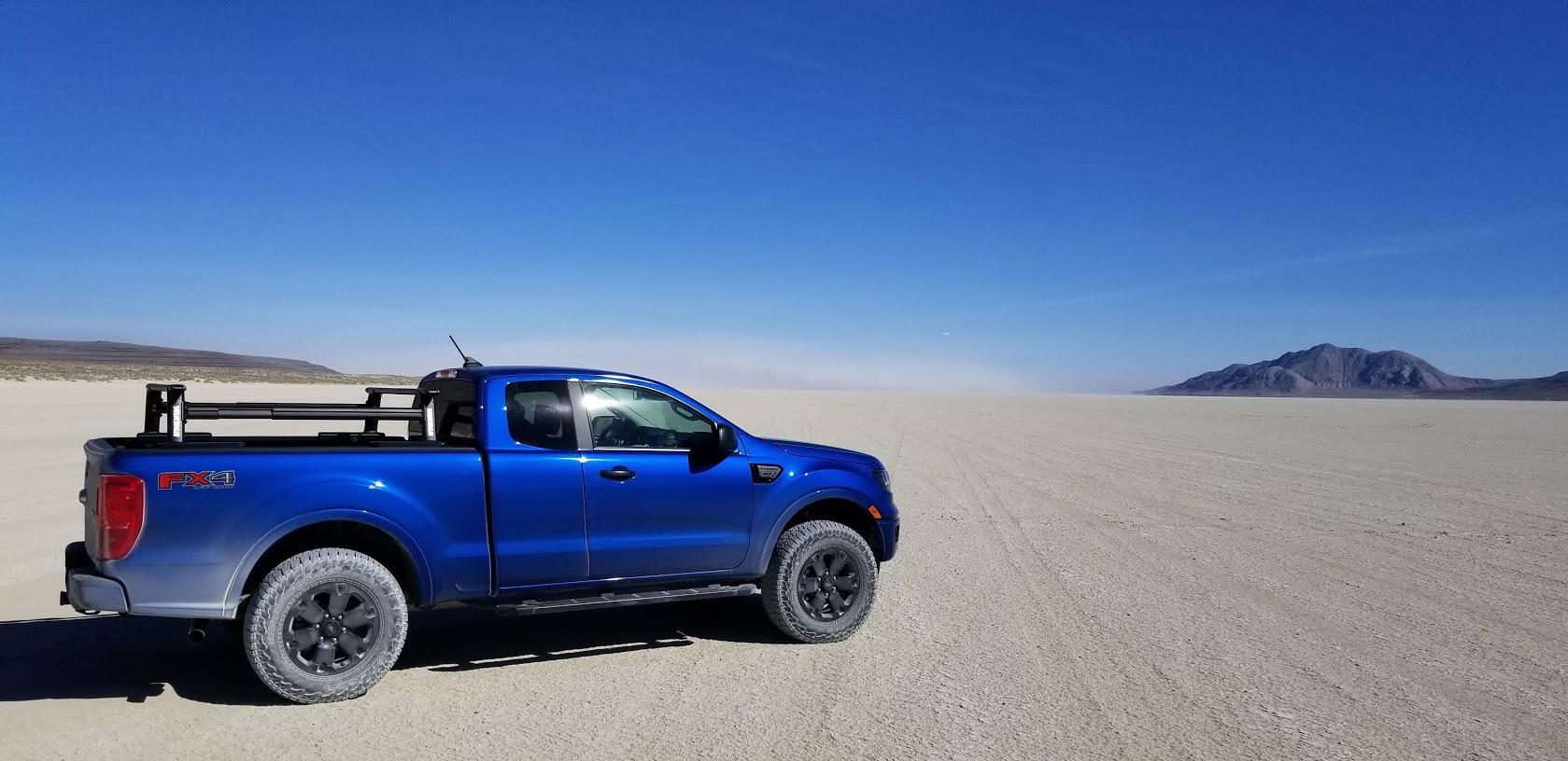

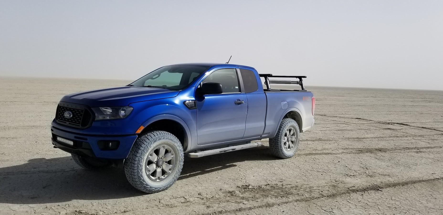

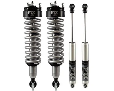

You should be able to get a 265/70 R18 in your truck with no rubbing with one of the kits that have at least a 2" raise of the front.
I went with the Ford Performance Fox 2.0 kit and I'm very happy with the results for ride on/off road.
If you want to go higher the Old Man Emu kit will be the one you want.
Here is mine with 265/70 R18 Wildpeak AT3s.

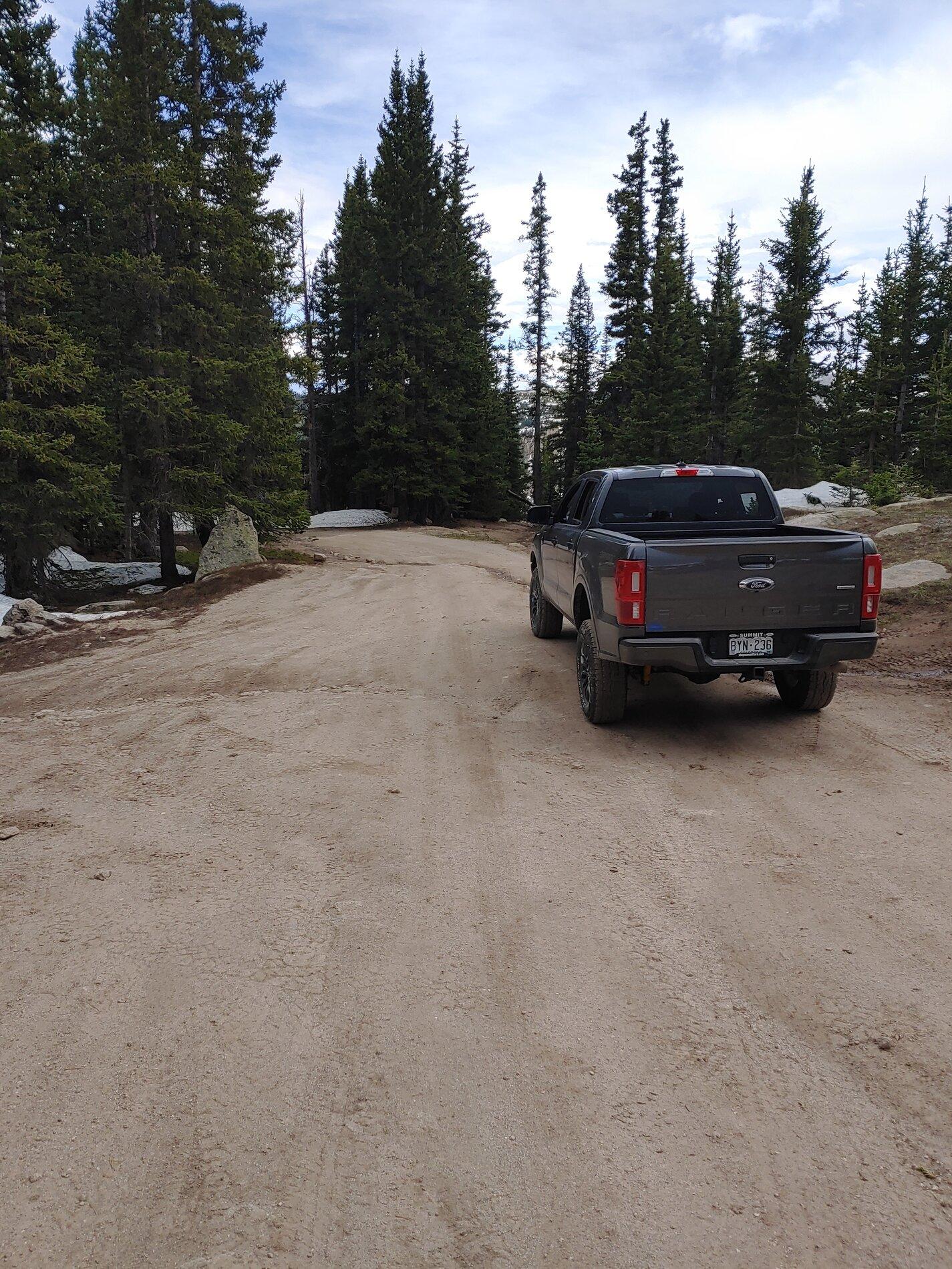

Just one short section heading up to Leavitt Lake off 108, only on 3 wheels once each on the way in/out. Haven't had any rub there or any milder off road so far.
The Wildpeaks I put on were 32.7 inch diameter, if the tires you choose are that or smaller you should be good.
That being said If you are looking for articulation ( I wasn't ) go Old Man Emu, there is a couple of folks here that have it on their trucks and are very happy ( look for the OME topic ). If you are doing rock crawling stuff on the regular it's the way I would go. Price is about the same too.

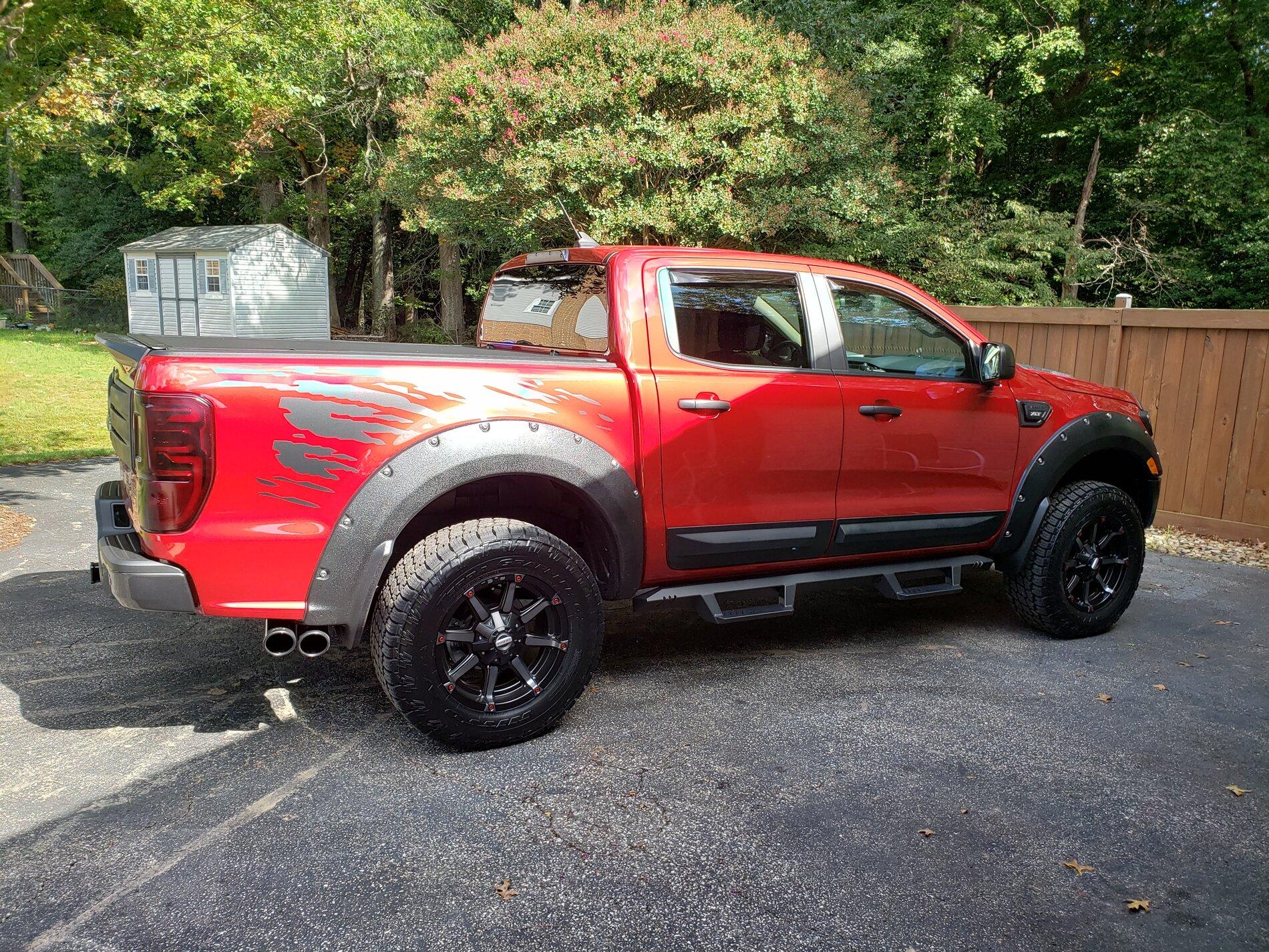

I also went with the Ford Performance Fox tuned suspension, but I went with a 285/65R 18 on a 18x9 wheel with a +19 offset. With this setup the front and rear crash bars had to be removed. That being said the 265 tire setup that you're looking at shouldn't hit the crash bars. Hope this helps!

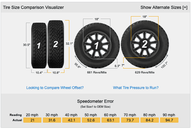

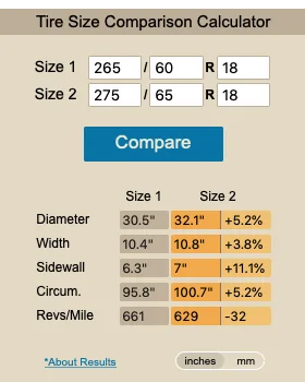

i ordered the Roush Tuned Fox 2.0 stage 1. I'll install it tomorrow then wednesday actually having local good tire shop put on 275/70 R18s to see the front fit and if don't like it, they'll switch to the 275/65 R18s which they also will have on hand. I used tire size. com to see the attached. any other tips, advice removing or cut crash bars? is appreciated...
