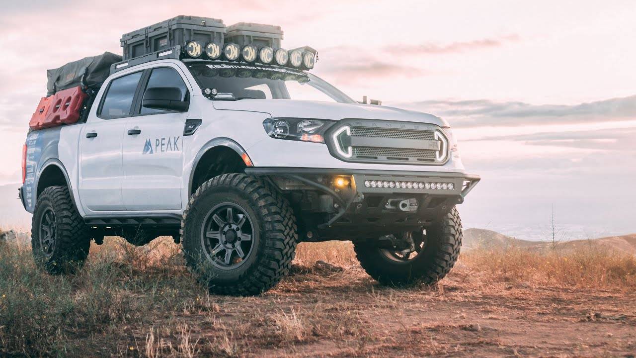

Well I just placed an order for the autosprings. I can't really find any problems searching around (even anecdotal ones). I don't know if they still run them, but even peak suspension runs these on their truck. Looks like a gucci to max ride, so I doubt they are going to install something questionable(?).
We have an upcoming trip to Black Rock scheduled in 2 weekends so I need something quick that works.
