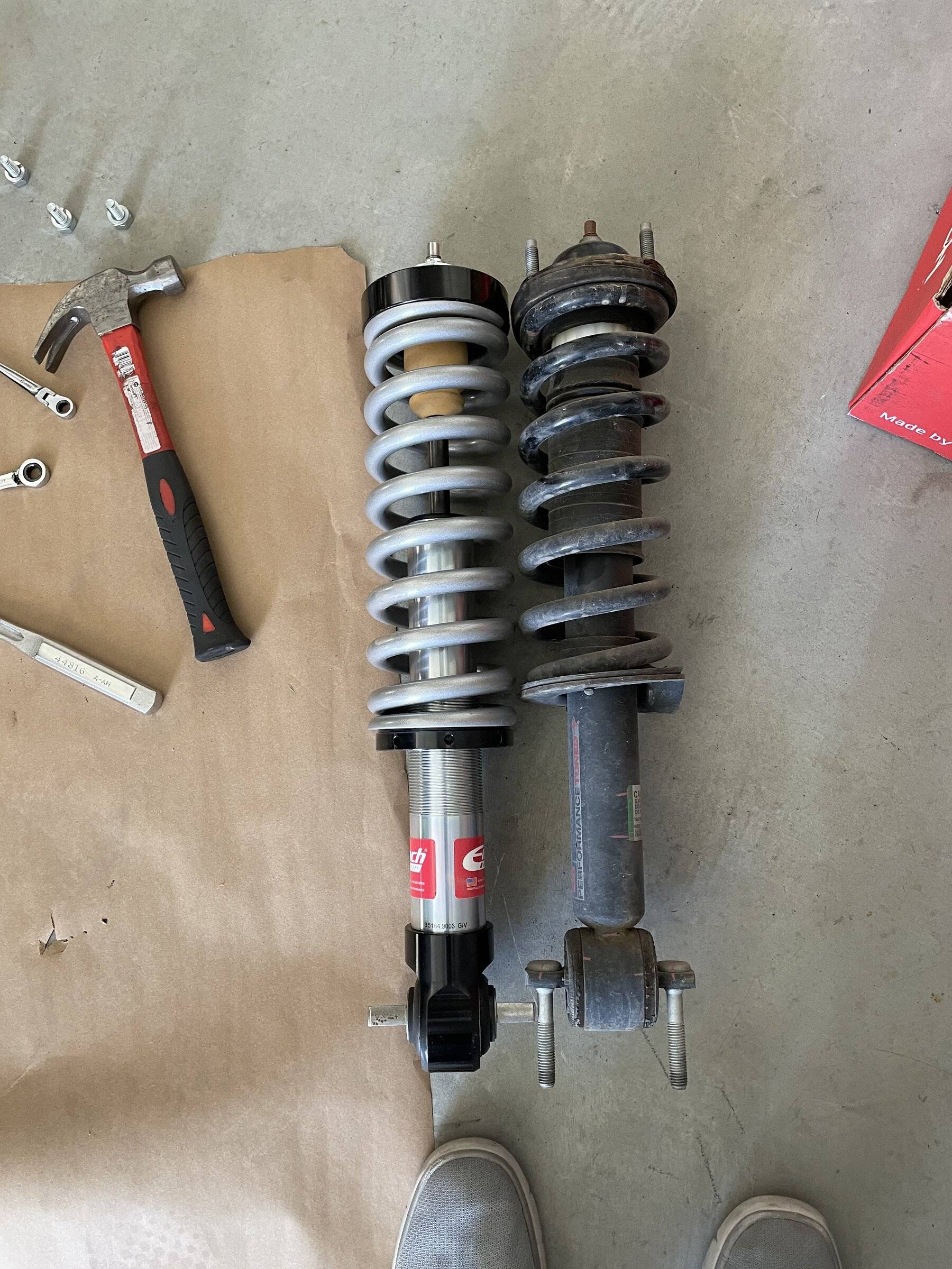

Looking for a comparative picture of a stock strut next to a lift aftermarket strut, trying to make a point

For the guys who have swapped the front coilovers, do you happen to have a picture of a stock strut side by side to an aftermarket one (OME, Eibach, Fox, Icon, whatever). A reputable manufacturer claims that their lift suspension is exactly the same length as the stock one and the lift is achieved by spring preload, thus mitigating coil bind. I think it's purely marketing (although preload may be there), as this would result in a very harsh ride with very very firm springs.
I could not find easily such a picture.

Thanks! Sure, with coilovers you change the preload, however, the question is a bit different. Is the strut exactly the same dimension as the oem one or longer?

My eibach adj coilovers are longer than the factory stuff it was evident on the install. I don’t have pictures though.

Unfortunately I don't have the factory struts anymore and I didn't take a picture of my old vs new when I did the old man emu swap but I can promise you the factory struts do not have the same length as aftermarket struts. Well not ones that do create left. In order to achieve extra lift in the front you have to do one of the following. Install a spacer between the strut and the frame. Change out the strut that has different grooves for the Spectre spring to sit in. Or change out the entire strut and spring assembly that gives more lift.

Thank you! I was watching an explanation from Ironman where they claim their struts are exactly the same length and the lift is achieved solely by preload, thus the droop remains as from factory, which is total BS.

Here is a picture of the eibach coilover vs stock strut. Eibach coilover is an inch longer, maybe more. I didn’t take exact measurements.

Thank you! Assuming that the rate of the spring is the same, that 1” alone lifts the front end close to 1.7”, then the preload can lift it more. How is the comfort of the eibachs compared to stock? Is it firmer?
