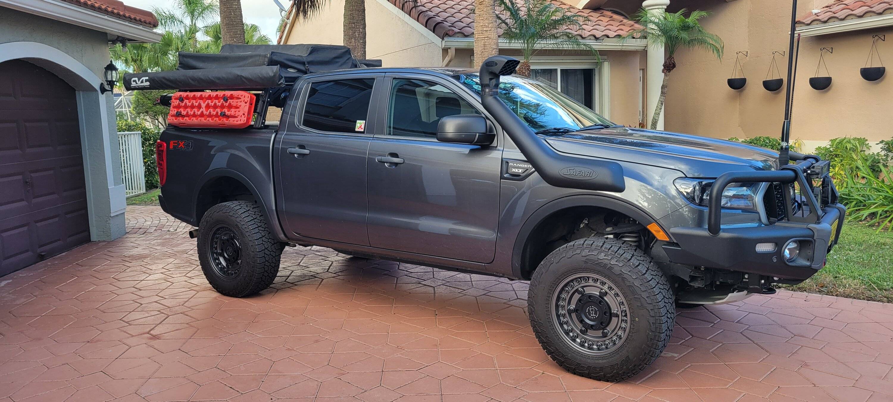

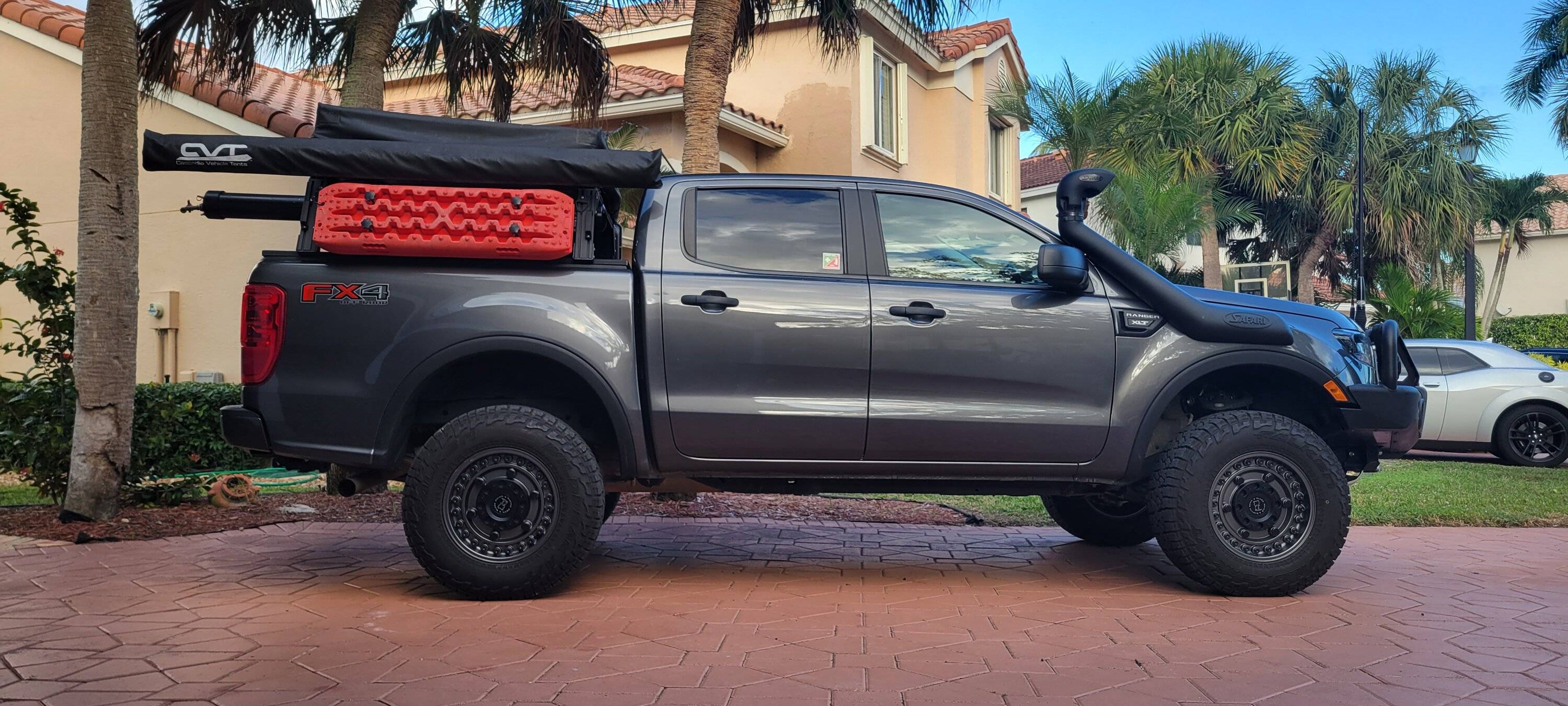

I'm running the autoleaf on mine and the ride is much stiffer, but it handles a load.
I have had no issues towing my boat (damn I miss my boat) and keeping my truck loaded with the gear I keep in it. I did have to move my weight to the nose of the bed to smooth out the ride over bumps though. The springy-ness of the rear would cause things to bounce inside of my bed. Heavy things.
Eibachs and Auto-leaf

Installation for me was simple as hell! HAHAHAHA I snagged the Auto-leaf stuff from a friend for $50, and it all came on his stock leaf springs. LOL, I just swapped the leaf packs over. But otherwise, the installation is pretty simple and straightforward.
As for the flares, there is a little hiccup, but I think you will like what's coming next. The ARB bumper interferes with the fronts of the front flares. The snorkel also interferes with the top of the passenger side front flare.
The plan is the clearance the flares to fit, and then cut and shape plastic to fill in the missing material on the flares. I will then finish them smooth and shoot them in truck-bed-liner. It will be OFC_Ranger style custom and clean!
