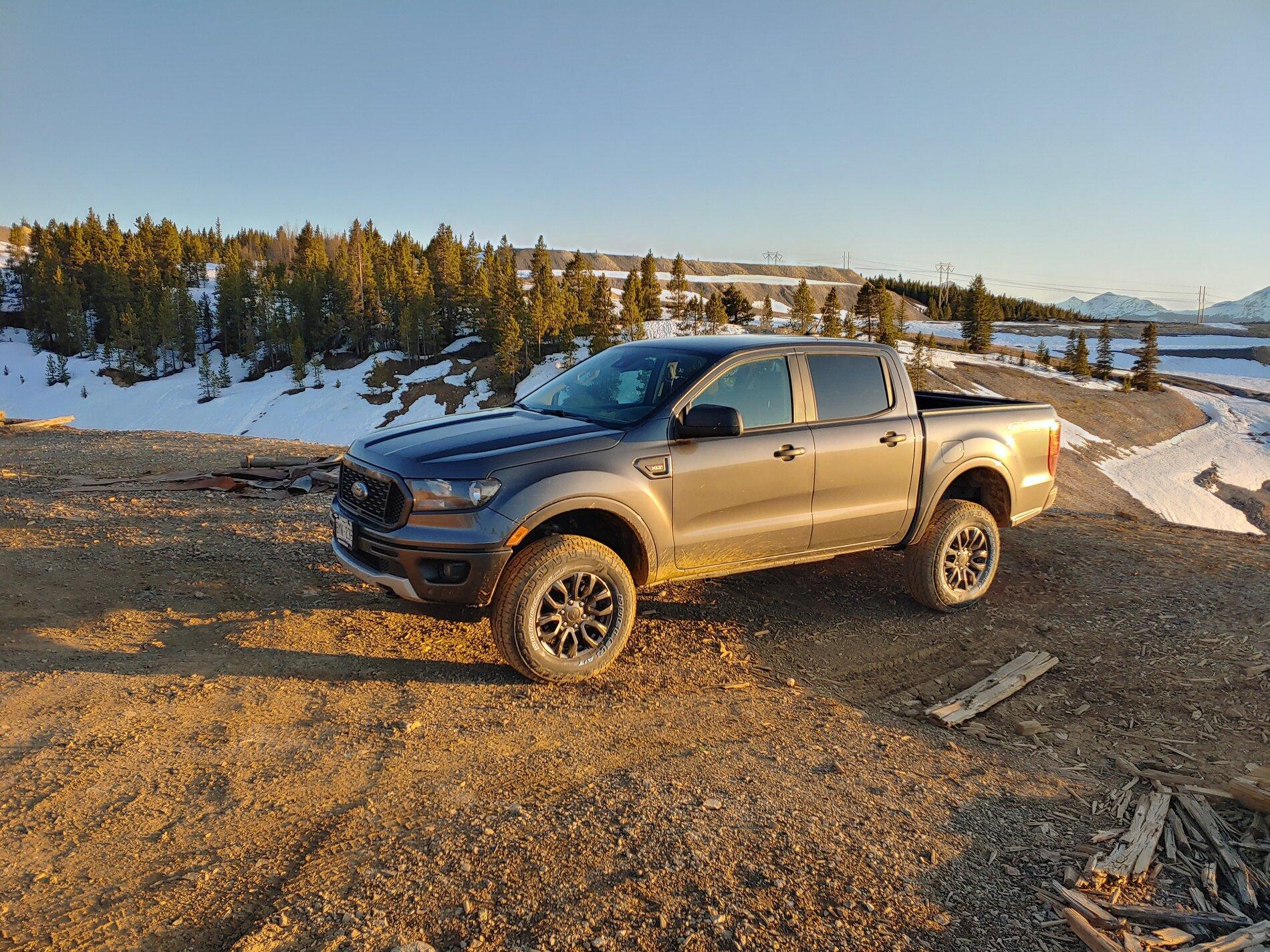

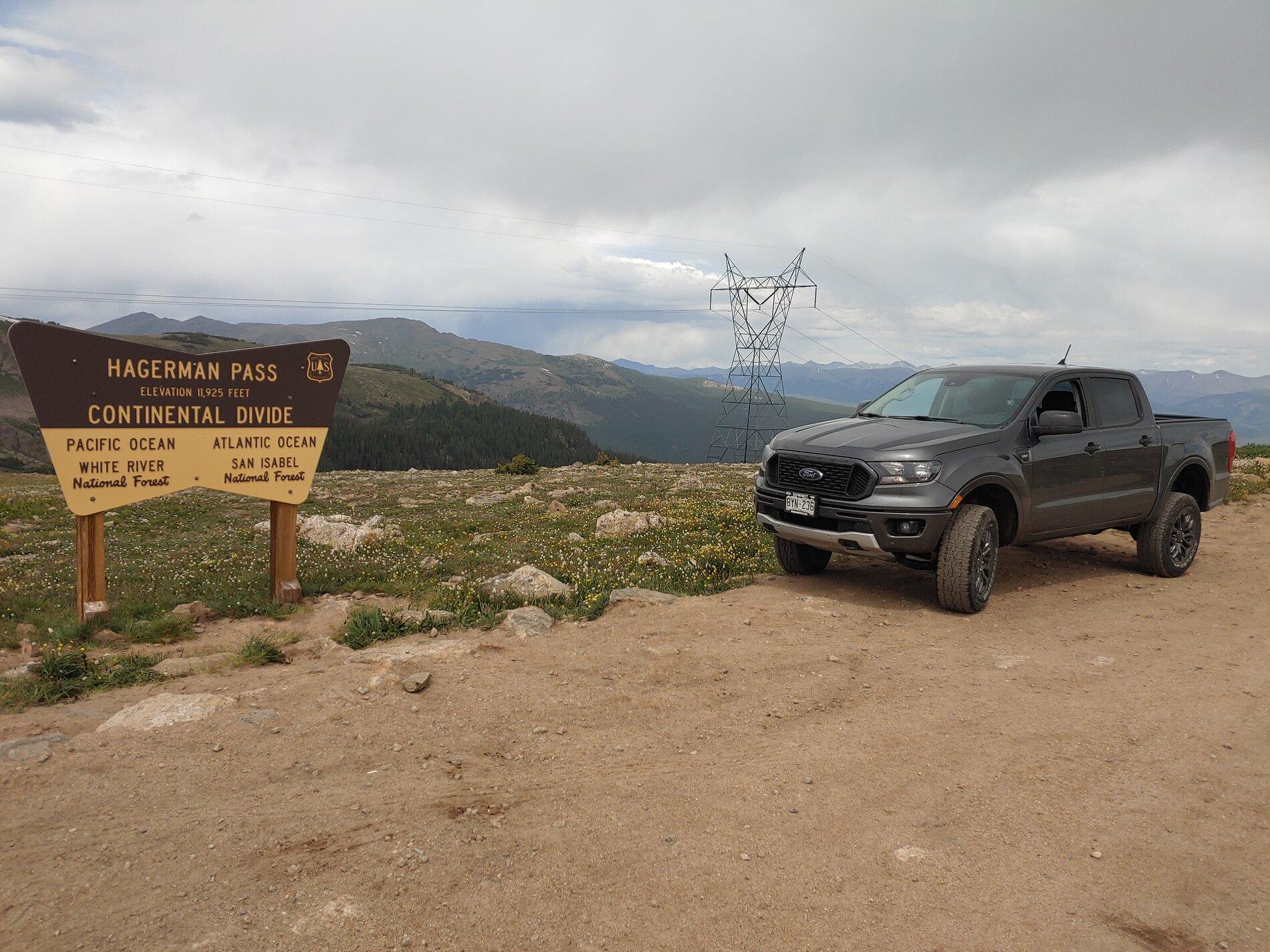

Since you are already planning on doing an overall lift instead of just a level then I would suggest going with the Old Man EMU kit. I say this because once you buy the kit you are good to go. You dont need to buy any other parts to make the kit work(doesn't mean you cant get different upper control arms if you felt like it) and the alignment can go back to spec with no problems. Also I like the Old Man EMU since the rear gets lifted with new leafs vs blocks or shackles so you get way more flexibility in the rear. Here are some pictures of my truck with the Old Man EMU kit on 265/70-17 Bridgestone Dueler Revo 3's. Hope you like the idea.
