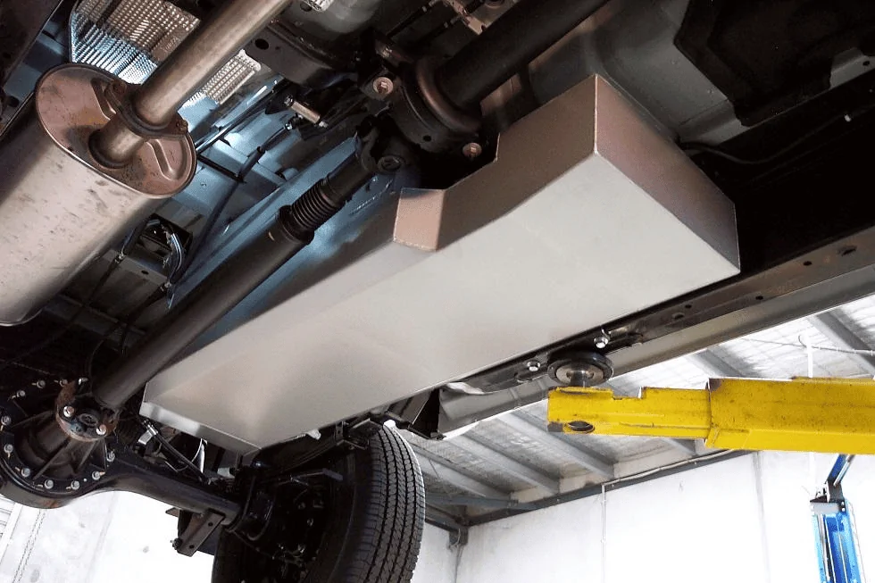

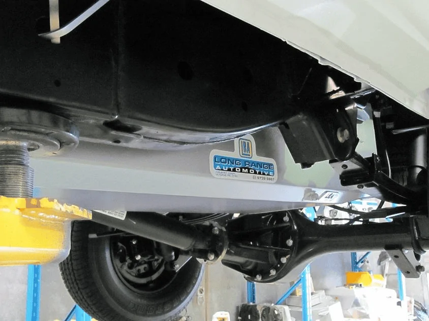

North American Distributor of Steel Fuel Tanks and Rear Bumper Systems from Australia
The Australian option under discussion is a replacement. We do not offer any aux tanks for pick ups and also none that are gravity feed.
We cannot tell you what the ground clearance of the new steel tank is, since we do not have a before/after, but the photos below provide some points of reference regarding updated clearance.
As for weight added, I also don't know weight of the stock tank/skid plate. The weight of the LRA tank shown below is approximately 100 lbs. Hypothetically, if the stock tank/skid is 30 lbs, then there's a 70 lb. increase. If the new tank holds 35 gallons, the increase is 16 gallons. At 6.3 lbs./gallon, the new full fuel tank will increase weight by 101 lbs. (fuel difference) and 70 lbs. for a total of 171 lbs. low and in the middle of the truck. Not a bad place to carry added weight.
In our experience with more extreme increases - like a 100 Series Land Cruiser with 80 gallons of fuel in total - the added weight is found by their owners find the cost and weight to be acceptable tradeoffs for the functional value received.
We are not saying 171 lbs. is not a lot of weight, but it might be worth it for some owners.
