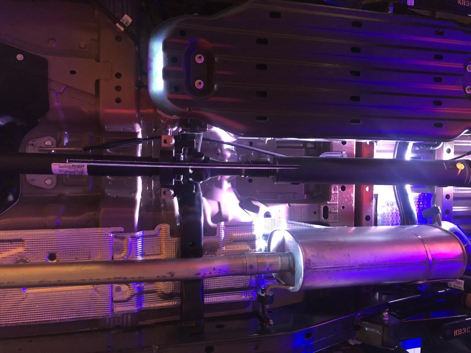

its not the best picture, undercarriage photos seem rare online for the truck.
but this is what you're up against. everyone will want to maintain their ground clearance and skid plates.

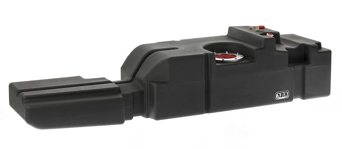

ARB have a tank for the overseas model, it adds 60 litres I think, and it just looks like it makes use of every available nook and cranny around the current set up.
I am well aware of what you're mentioning here. Aftermarket fuel tanks that are bigger usually don't have skid plates to begin with. Also ARB already informed me they wont sell fuel tanks out here. And the company I'm goi g through at this time is similar to ARB where they use every nook and cranny to get the extra capacity
