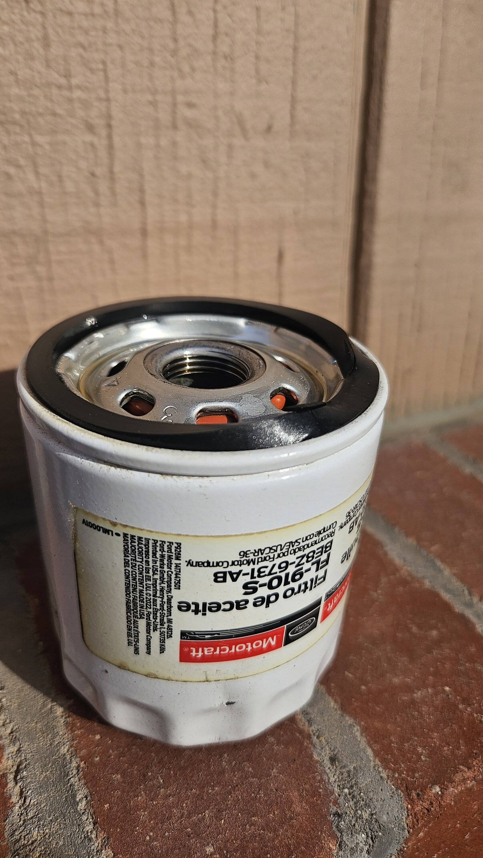

Just had the engine oil changed for the 4th time at local best Ford dealer in Phx. Got it home and immediately found it was leaking oil. Took a look and wiped out the small filter drain collector, thinking it may be residue from oil change. Continued to leak, actually was dripping off the front of the 45 degree cross member, which is directly behind the filter oil spout, called the dealership and they said- bring it right in, which I did. They look at and said there was NO leaking, to which I replied I know there is a oil leak. I thought MAYBE they replaced the filter, but would rather not tell me that- as any type of admission. The service advisor told me their top person in lube shop looked at it. Took it home and of course it continued to drip now on about 6 locations where I park, including my garage. Called service advisor back and was told again to bring, I said no thanks I will put a new filter on it my self, which I ordered on Amazon, and I had a very nice auto sizing filter tool, which worked great. Also while in there I got rid of the very annoying push pin keepers, I replaced them with new ones you can actually remove-without a small fight.
How can you possibly not look at the rubber when you install a filter. I use Ford service on this truck because of the extended warranty. Clearly the rubber washer was deformed during manufacturing of filter. Not very happy about this.

Not so much deformed, just pulled out of place.
Be it before install or during install if put on dry (friction pulled it out) while rotating it tight.
I know, right? Does no one dip their finger in the drained oil and rub it around that gasket anymore? 🤷‍♂️

Pretty pathetic that they didn't even look at it when you took it back in. Is it me or does that filter label look old?

Yes it does, Hmm old filter off - CRAP we are out of stock for a new filter, put the old one back on. 🤷‍♂️ , which may explain how to seal was pulled out of place, during removal.

When I replace my air and cabin air filter, I take a Sharpie and write the install date right on the filter. I do this because I had a service advisor try to tell me that my air filter was bad. He showed me "My Filter" and how dirty it was. The issue - it wasn't my filter. I told the service advisor that was not my filter (I'm guessing they keep a dirty filter on hand because most customers would just agree to have it changed) because mine was just replaced and I had an install date on it. A few minutes later "Your filter was fine, I grabbed the wrong one from the service technician".

Think they may have put the old filter back on????

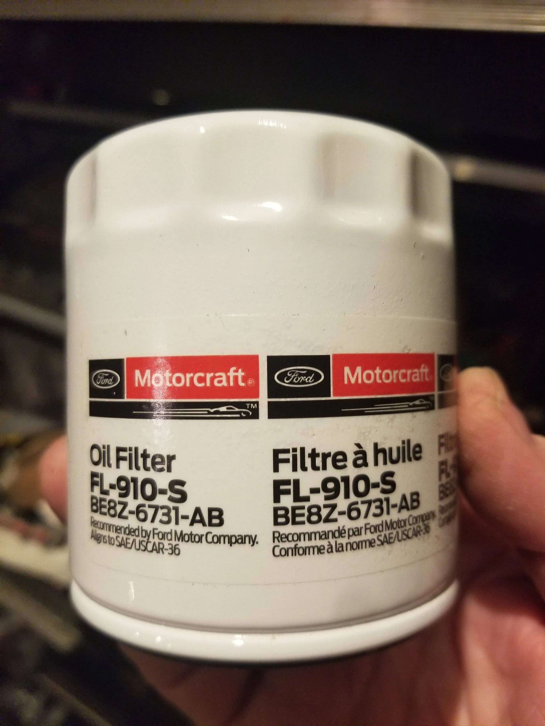

Here is one out of the box that has been in my garage since September of 22. I know that because I bought 2 on Amazon, put them in the garage, then had to go buy one at autozone when I was changing my oil because I couldn't find them. A few months later, there they are. No yellowing from just sitting around.

Bummer to see this from a Ford dealership. But hopefully they use it as a learning lesson. Looks like a non-oiled gasket when it was put on and the gasket hung up while tightening.

That discoloration of the label is from heat exposure. They never changed the filter :(
I mark all my filters with a sharpie before taking them in for service ever since I had the same thing happen years ago. I mark my tires also so I know they actually rotate them. Been there done that merry-go-round with a service advisor also.

The yellowing on the label is from the oil leak
