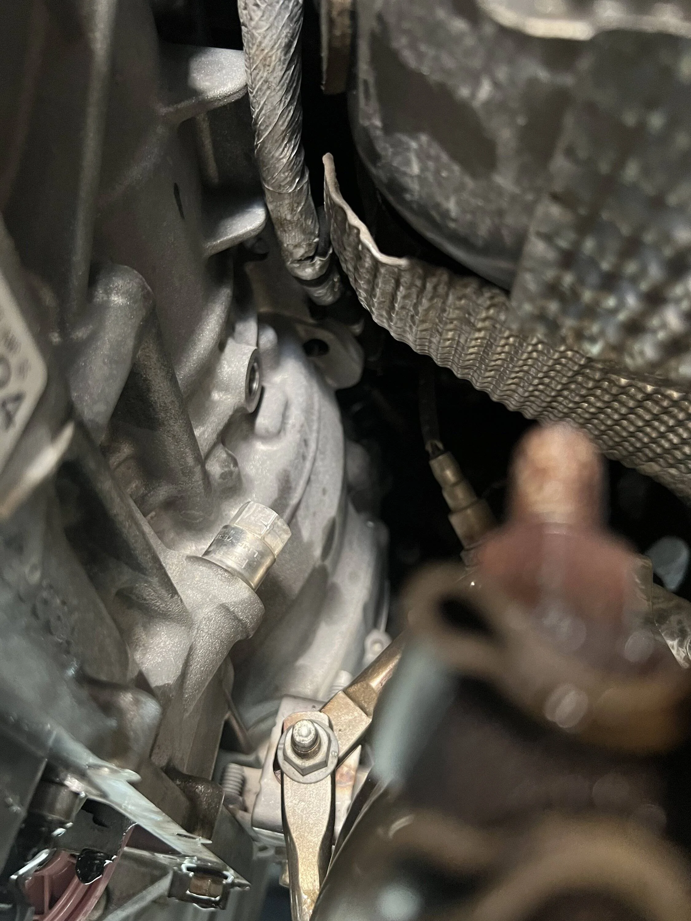

Transmission dip stick seized… how do I get it off to fill transmission…
tnewcomb6370
Tim
Dec 29, 2019
59
104
Connecticut
Lay on your back under the fill cap and use a 19mm open wrench...use a small ball peen hammer and tap the end of the wrench TOWARDS YOUR RIGHT (clockwise)...from the top, this would translate to be counter clockwise to loosen...
Thanks, that is a start. Tried doing from the top but was to scared to turn to hard as it was not straight on.
The cap's aluminum so becareful when loosening as to not slip and mess up the cap...light taps to get it loose and it'll be ok...when putting back on, make sure the dipstick is fully seated in the recess and hand tighten with wrench...it won't come off by itself...

Got the cap off. Actually went thru the passenger side wheel well. Popped a couple of push pins out and folded the flap back and it was straight on shot to the cap. Couple of quick turns on the rachet and it was lose. Got the pan switch just need to refill.
