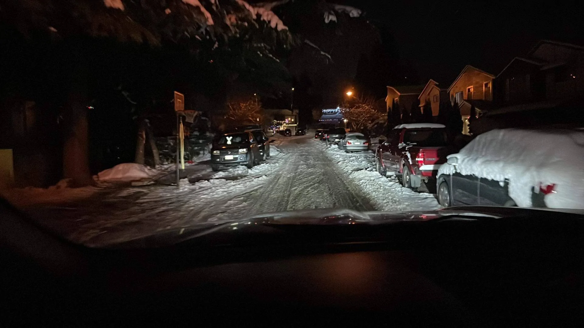

Everything has gone well. Haven't been flashed once since installing them, outside from the person flashing me in the middle of the day as a warning of a speed trap ahead.
The yellow fogs definitely help with contrast when fog washes things out early in the morning. I think that's more important with the colder LED light temps. I bought them kindof on a whim, thinking this might be the case, and I've noticed it's definitely true.
They're not perfect. You can see the artifacts from the different facets of the reflectors, so the lighting is somewhat uneven. Hasn't made a practical difference, really. The cutoff is still pretty hard, and I get better spill on the sides. Getting improvements there was important to me, as my unlit, twisty local roads really sucked. There'd be no way I was seeing a pedestrian on the inside of a corner in the dark if they didn't have their own flashlight (most ppl don't do this) with the OEM lights.
I've no doubt that buying new housings is for sure going to be the ultimate lighting upgrade, but these give a more cost effective improvement from stock.
They're a little brighter than stock overall, but total brightness wasn't what I was after. As I said, I have twisty, hilly local roads. The road changes direction before I'm likely to out-drive my lights. Even with low beams most of the time. More spill on the sides was my primary objective, and I got that with these lights.

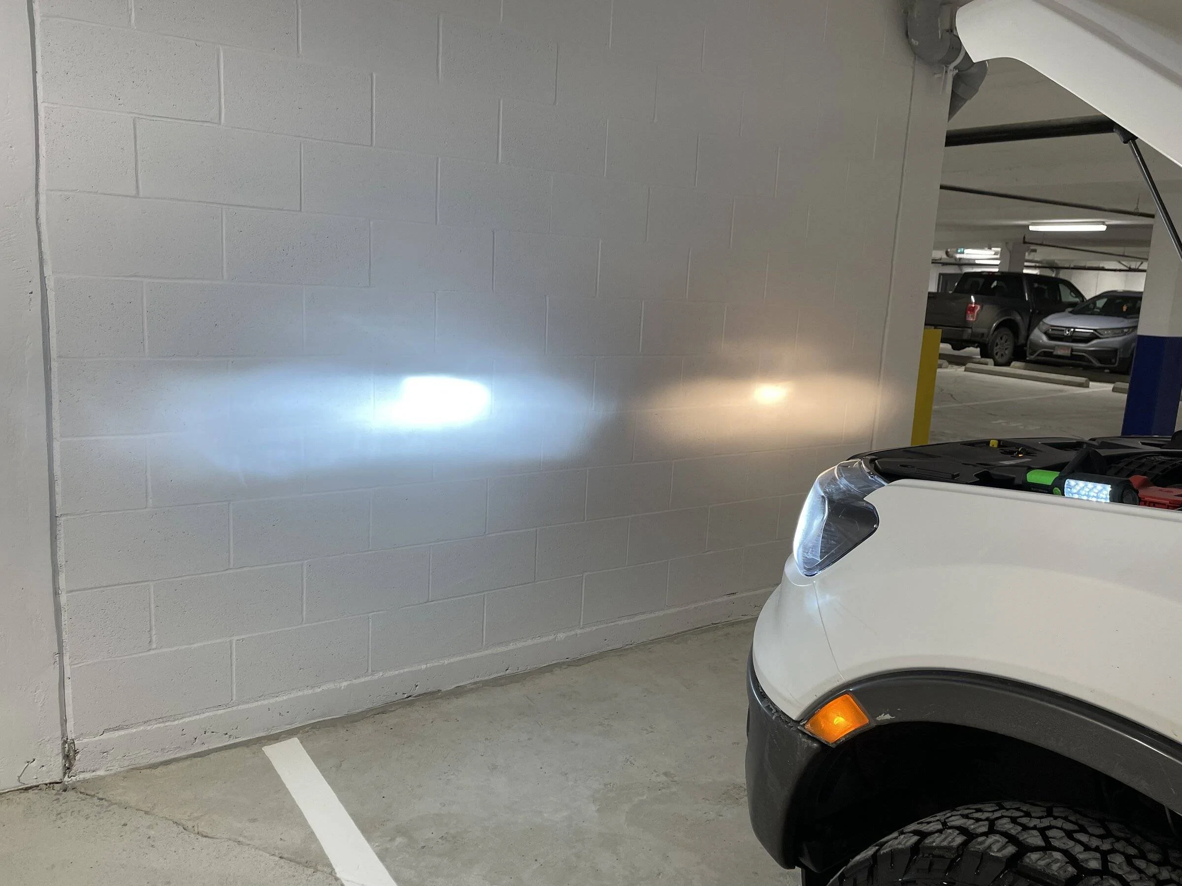

Auxito 12,000 Lumen H11’s. Great upgrade, and pretty similar beam pattern. No issues so far, will report back with any if they arise!
Were you able to put the dust cap back on or is the bulbs fan housing too large? Thanks.
