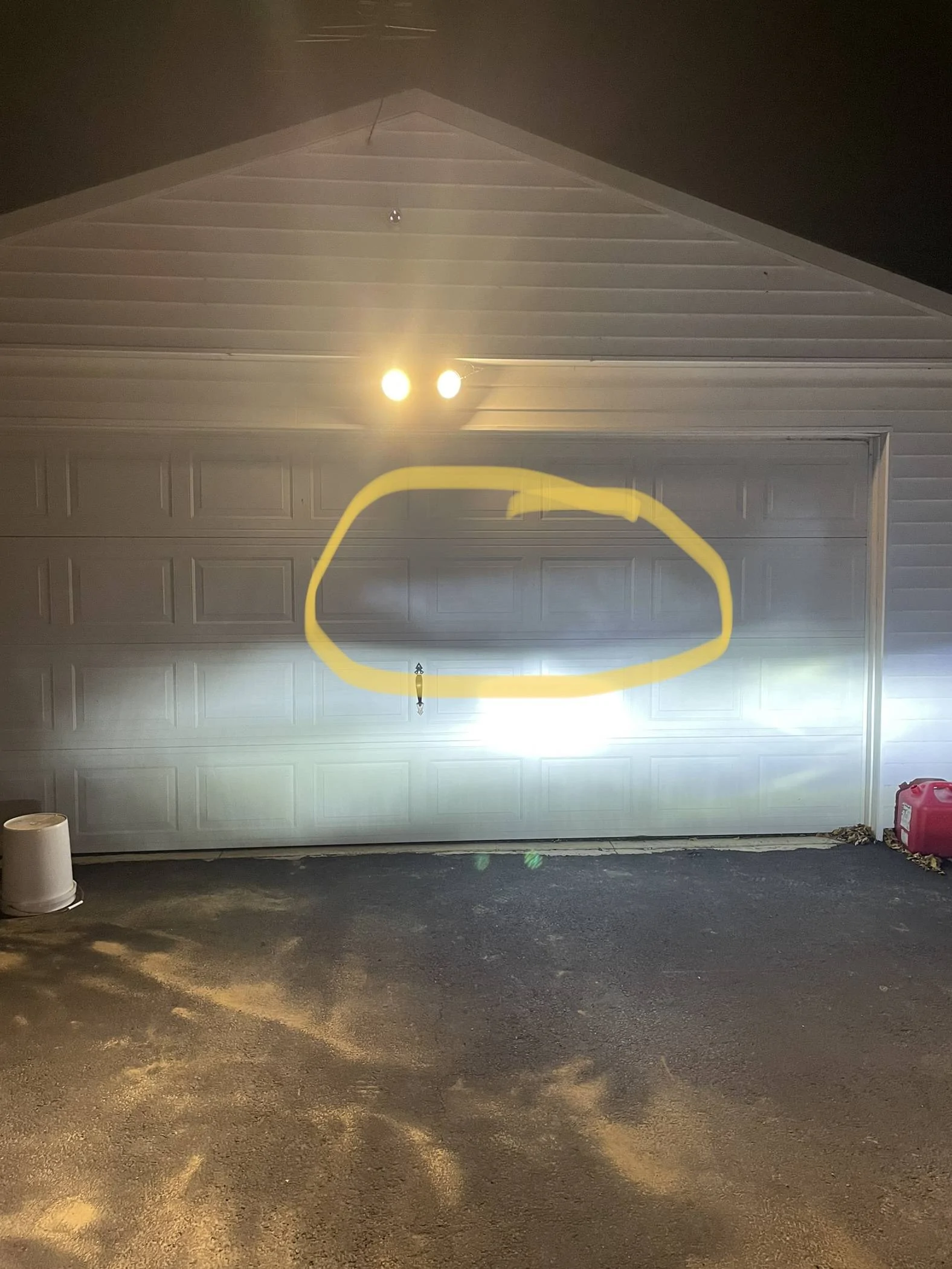

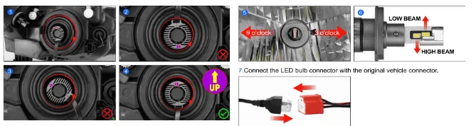

Okay so I’m questioning either my judgement or the collective intelligence of this thread. I bought some car river low beams because they are dimmer (“10k lumen”) and adjustable. Swiveling around the fixture, I was figuring the 9 and 3 parroted here (blade vertical, leds on side facing 9/3) would be the best option, but it seems 12/6 is significantly better. Here’s a photo with left low at 9/3 and 12/6 on right. The huge hotspot above the cutoff is caused by the left.
Is this unusual? When people say 9/3 do they mean the blade faces 9/3 instead of the leds?
Effectively, following the instructions produce terrible scatter above the cutoff. Rotating 90 seems ideal.

I never could get the set of 2 blade LED bulbs to work correctly in my '91 Ranger or the '07 F-150 . I ended up with the 3 blade sets in both and they did well . The 3 blade Leds produce a more 360 pattern of light like the halogen and are easier to get rotated in the reflector correctly IMO .

Like you I tried the CarRover 10,000 lumen LEDs in my lows (today) and I also had terrible scattering. I didn’t really try adjusting them to the 3&9 position because I couldn’t get the dust covers back on regardless of how hard I tried. So I’m giving it a few months and I’m doing a complete headlamp replacement with either the Alpharex novas or the Morimotos. I’m tired of trying the drop in LEDs and them being a complete disappointment.

Yeah. 3/4 of my dust covers closed no problem, but for some reason one did not clear the fan off the back fully so is 3/4 tabs locked in. Before settling on position i loosened the ring on the bulb and tried swiveling in all directions with the light on to test. 6/12 was the best for the lows.
I noticed today in morning driving (gloomy, but 45min after sunrise) that the highway signs 20' in the air were catching a lot more light than usual...
I'll try some of the 8 side bulbs, and then if those are also acting up just go to better halogens and call it for now.
I've not tried the brights yet, but scatter is less of a concern. I want them to be an upgrade of course, but i will not be using them when anyone else is within view.
