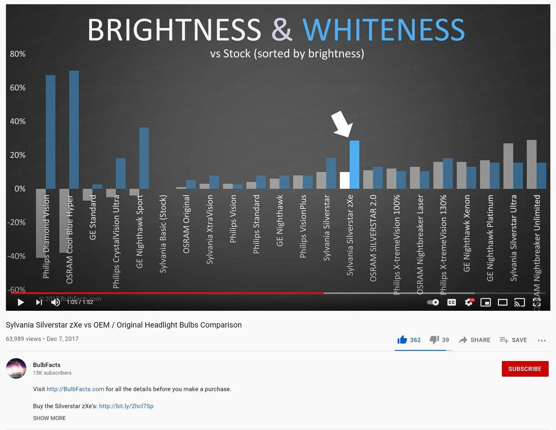

Here was a resource I used to make the leap
That link should start it at about the 1minute mark where it shows whiteness vs brightness on bulbs tested. The normal ZXE seemed the best all around but the ZXE Gold was not tested, figured it could only be at least as good as the standard version....possibly the standard version could be more white though than the ZXE Gold.
Well, long story short, I am happy with the results. I plan on trying the two Phillips mentioned below as I want spares anyways. I just wanted to stop messing around with LED options since all the ones that will fit in the stock dust cap seem to have a trade off in beam pattern to a degree.

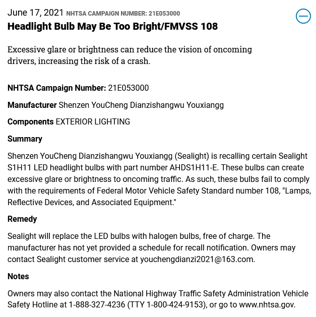

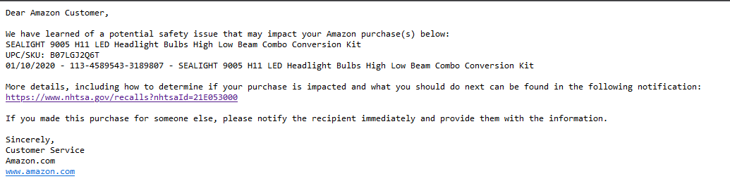

As a note - This is exactly why you need to be careful with LEDs, especially drop-ins, where they don't belong. (Note: I also didn't run these bulbs luckily, I returned them after a test-fit.)
https://www.nhtsa.gov/recalls?nhtsaId=21E053000

This is an important thing to consider when dropping leds into the Ranger reflector housing. I have been running the Auxito 16k lumen leds in mine, in both high and low beams, for several months now. After being flashed several times, regardless of how much I adjusted the beam, I have removed the leds from my low beams. I kept the high beams in because I only use those when there’s no traffic. I am now saving up to get the Alpharex Luxx headlamps, as they provide superior light output and an incredible cutoff that is much needed when running leds. I miss my led low beams, but for the sake of other drivers on the road I had to remove them.
