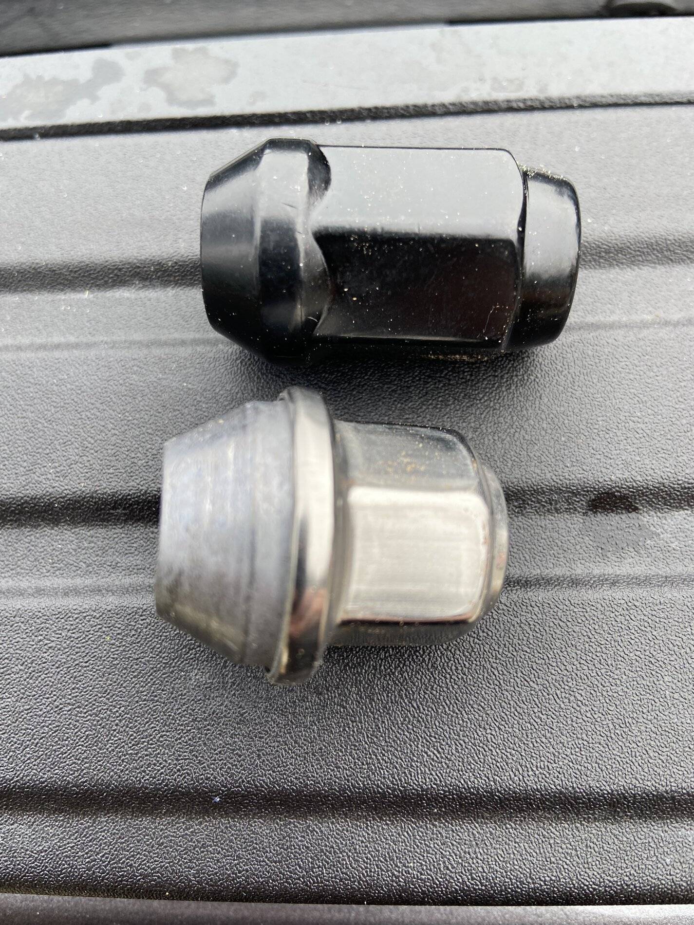

I ordered those same exact ones and returned them. I posted pics on the forum and Phil pointed out that they were not 60 degree cone and left too much of the wheel exposed. Hopefully they are better now. Post pics when you get them on!
Here you go - a side by side. Definitely a 60 degree cone, but shorter, and no wider flange or lip. Whaddya all think - do they look ok to use?

As Phil mentioned earlier, there are other threads on here that get into detail of the proper nuts to use.
First and most important. They should be of forged steel. There are reasons for this but in short, produces stronger threads. Can’t strip out or shear under high stress. Second is cup size. We have 60 degree cone seats. The full surface of mag seat needs to be used. It’s another stress point and shear can happen from small diameter nut seats.
Gorilla is a safe bet and no one on here has had an issue with them. They have “bulge” nuts in chrome and black with two different hex sizes of choice.
This is not a place to cheap out.

Your stock lugnuts are two piece and subject to swelling over time to the point the lugwrench provided will not fit.... It is better to junk the stock lug nuts and purchase new. Do not know your definition of $$$ but Black lugnuts are very inexpensive on Amazon.... This topic has been covered over and over again....I recommend you use the search function to help you with your decision... It took me about a day or two with my new truck to broom the OEM lugnuts. Shame on Ford for continuing with these POS OEM lugnuts. Pay attention to the cone area as you need the larger cone area... This is discussed as well....
