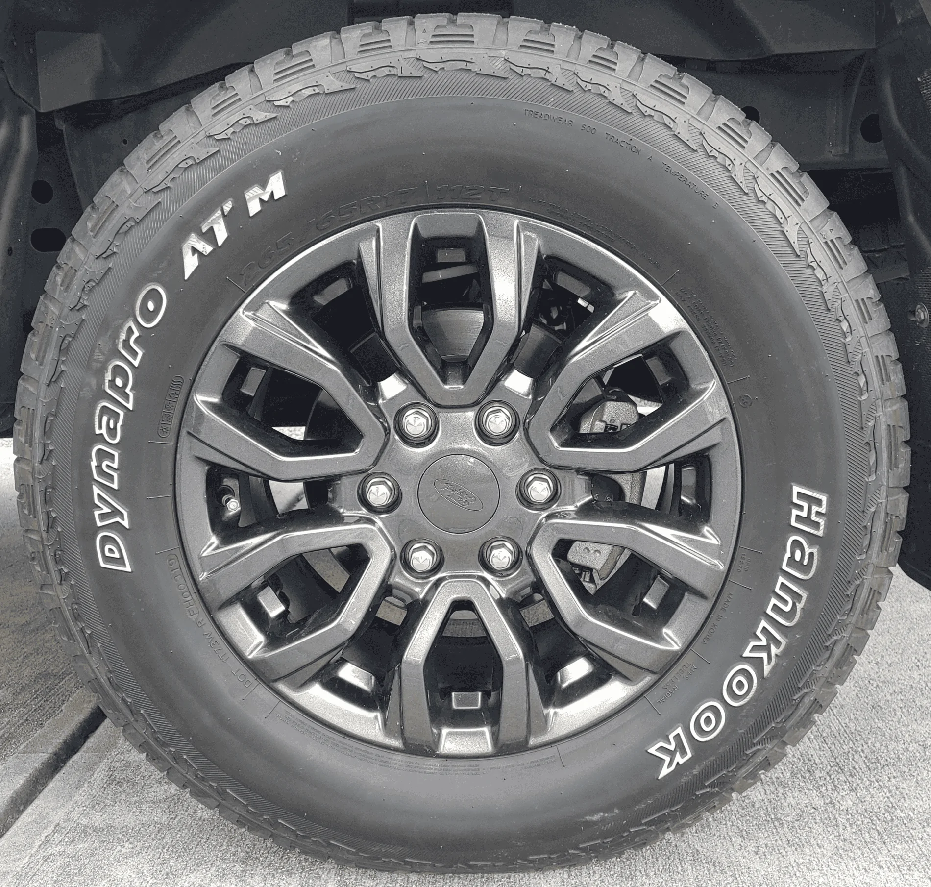

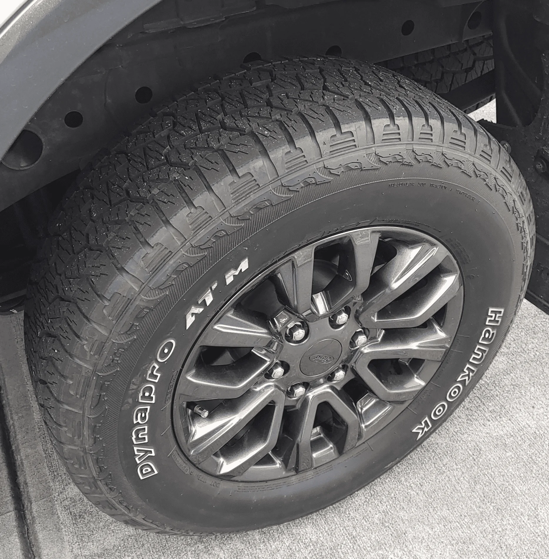

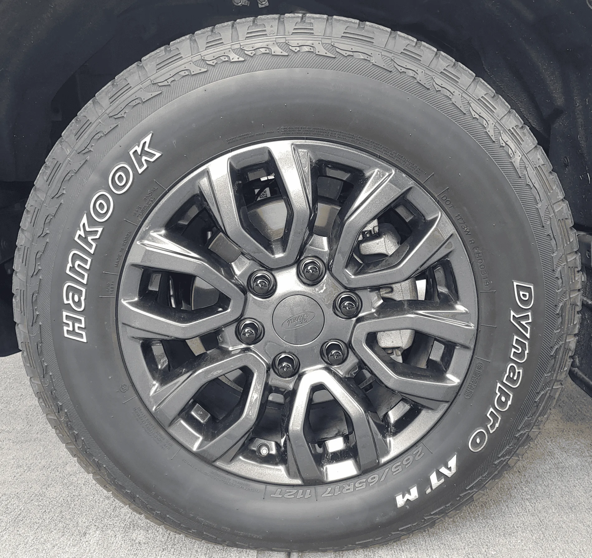

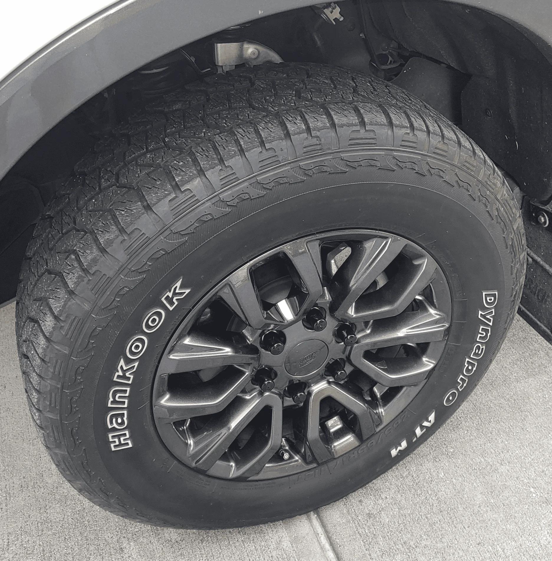

EDIT - Ok I have cured my ignorance! Having not investigated Fords swollen lug-nuts(my bad). I now understand the risk! I assumed the cap was chromed steel, not ALUMINUM!!!! What Mechanical engineer worth his degree combines steel and aluminum in an corrosive environment is beyond me! So with that in mind adding a cap on top of these, plus add in a little salty water via capillary action, you have accelerated Ford Swollen Nut Syndrome - FSNS (this needs an emoji!).
Based on this I will not use these and will not recommend them.
I will leave the pictures for future readers
Having just switched to Magnetic wheels I was looking to change to black nuts. Before shelling out lots of $$ I decided to try Colorlugs a try. Basically a vinyl cap, I know, I know...
They recommended 1 inch long, which is way too big. I am sending those back and getting the 1/2 long version.
Some pics with and without - you get the idea, but also see that they stick out too far.
I will post new ones when the shorter version arrives, gotta luv Amazon free returns!
Oh and these do come in other colors besides black, for those so inclined....

1000% do not advise this. This perhaps may be an even worse idea than painting them. Both are completely terrible plans. It baffles me people sell garbage like this.
Hmmm why so?
It's has no impact on the ability of the lugnut to hold the wheel on. It's easily removed, with the tool the supply. You might argue wheel balance, but mass is next to nothing and if it was it's so close to the center of rotation it would be minimal.

Because anything that could cause an issue with getting the lug nuts off when having a roadside emergency is just dumb. The brake heat cycles will change those stickers consistency as well. Just get black lug nuts. Ford’s have enough issues getting the OEM lug nuts off when they swell. Putting stickers on them? It will be worse. A tow for sure costs more than a set of lug nuts… Out of 1,000’s of cars we service at work yearly, I haven’t one person do this. Even the squatted truck kids don’t. Lol.

Maybe they look better in person, but IMO the stuck lugs look better than black on the magnetic wheel. That mod wouldn't be worth the hassle to me.
