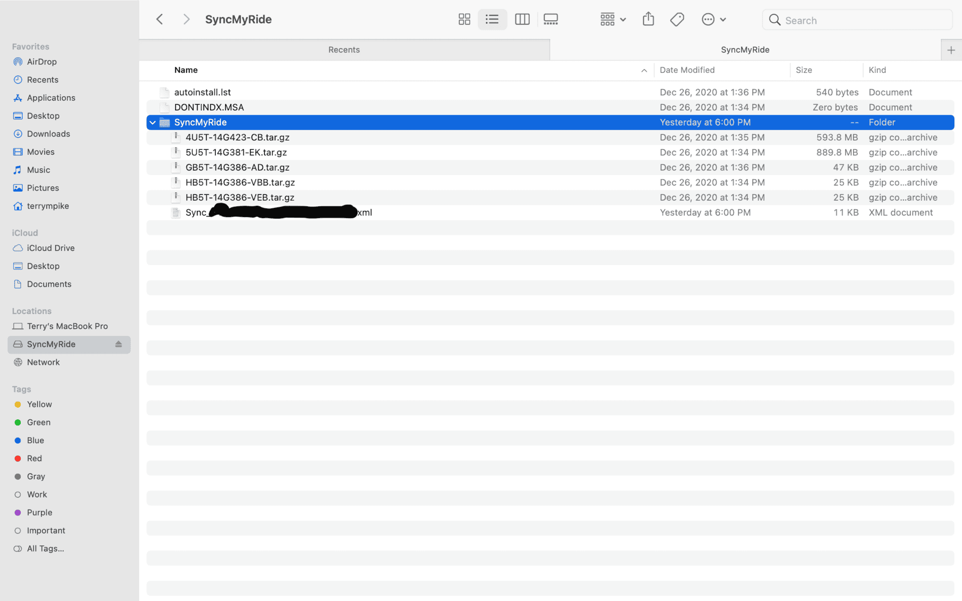

I used WinZip with my MacBook and i was able to update my Ranger AND GOT MY CLIMATE CONTROLS BACK!! Updating took about 25 min. Winzip only added SyncMyRide Folder and its files. I had to go back and add autoinstall.lst and then again add DONTINDX.MSA. After I done this by trial and error I was able to update my truck. I am not a techie & this was by trial and error. Remember to name your thumb drive " SyncMyRide " and format your thumb drive to ExFat. After the update was complete a note popped up on screen saying I can remove the thumb drive and updates will take place once I restart the truck.
