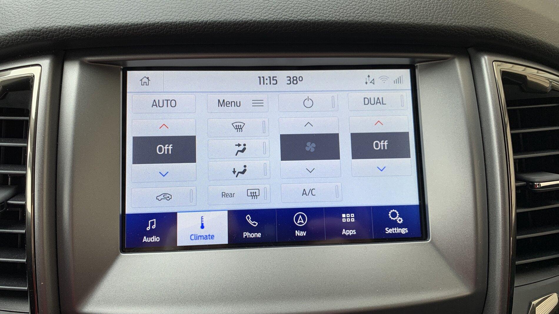

I updated from v3.4.20136 to 282 and I gotta say either something was wrong with my 136 install or Ford has done some huge improvements to the sound of my B&O system with this update. On 136 the bass was very anemic and mid bass was muddy and distorted...passed it off the to the small sub. Sound was ok..just not great. After this update the bass response is so much better being quite punchy and mid bass very clean. Other than rear biasing the fader a bit the sound settings have been left at default this time and the sound is great all the way to max. Either Ford adjusted some of the crossover or dsp settings or perhaps my sub was not functioning well or at all on 136?
Anyone else notice anything different in their sound quality?
I got my climate back which is nice...still no heated seat icons though.

Like many others, I also lost the on-screen climate controls on 20136 and got them back on 20282. So a thumbs-up there!
Like @Benworks the heated seat controls remain missing. Not a crippling deficiency of course, the physical buttons are within easy reach. Posting more from a "was this intentional or a remaining bug^H^H^Hfeature?" POV...
