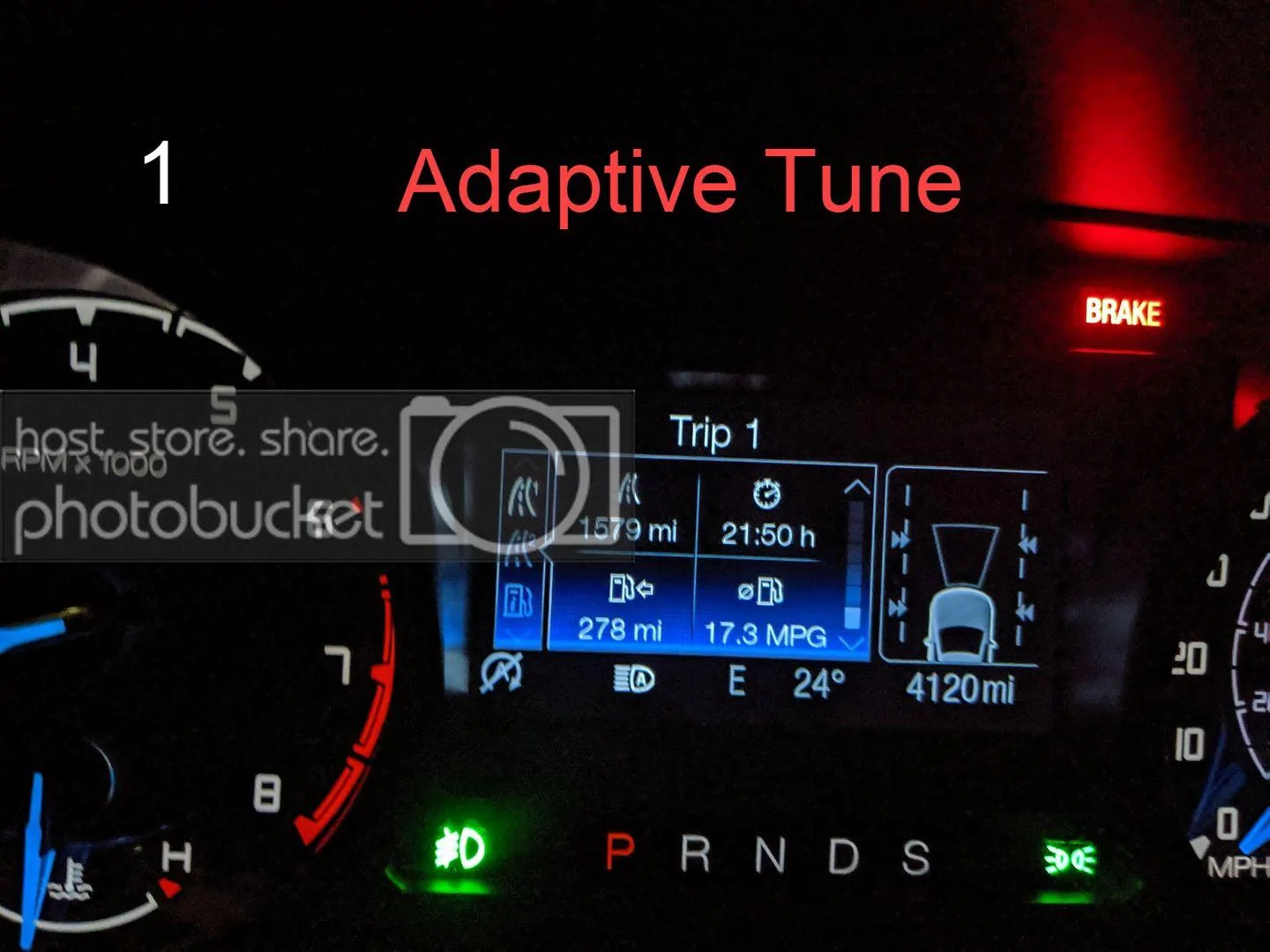

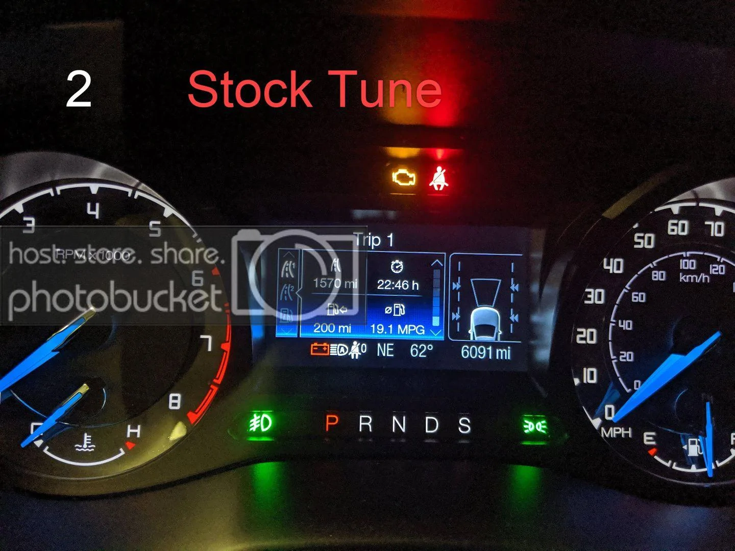

Now, let’s talk about fuel economy. As I was suspicious about the strong exhaust smell mentioned at the beginning of this saga, I wanted to test my fuel economy on a long-distance road trip I had been planning. I recently drove out west from the east coast and had the updated adaptive tune applied when I began my trip out there. I used mid-grade fuel the whole time (89 on east coast and 87 further west). The weather was perfect on this drive and I experienced almost no traffic. As seen in the attached photo (1), I averaged 17.3 MPG over 1500+ miles of continuous interstate driving. The Rangers fuel tank is not the largest and I was quite frustrated by the end of this drive with how frequently I had to stop for gas and that I could almost watch the fuel hand move down. Upon arriving at my destination, I decided to remove the tune hoping that my fuel economy would go up a little. On the return leg of this trip I still had the vehicle set to stock. Looking at the other attached photo (2) you can see I averaged 19.1 MPG on the return leg of the trip. Some things to note about the return trip are that the trip started with roughly an hour of stop/go traffic due to poor timing on my part. Then, through the entirety of the great plains, there were very heavy winds that negatively affected my fuel economy pretty significantly while watching the instant fuel economy display in the gauge cluster. Also, I used regular gas the whole way (85 out west, 87 in the east). I am adamant about using cruise control and both legs of the trip I mostly had it set between 78-83 depending on speed limit.

Averaging 80 mph with 85 octane over the divide through a long stretch across the plains in high winds; 19.1 does not seem to far out of an expected range in my opinion. I would hope it would stay above 20-21 mpg in those conditions but I have yet to rode trip mine.
It's not bad and I would say you're correct that it should be in the 20-21 mpg range but there are so many variables it's hard to say.. I averaged a little better than that (19.5) on my last trip and we were climbing in elevation for most of the way 1000' - 5000' at 75-80 mph and 87 octane. I also have a 2.5" level kit and larger tires so it's about what I expected. I've been tossing the idea of a tune around for a few months now but still not sure what I'm going to do. I like what @Doc has from Unleashed where the D position is cleaned up a bit and the main tune is in the S position. If I end up doing one this is the one it will be. :)
