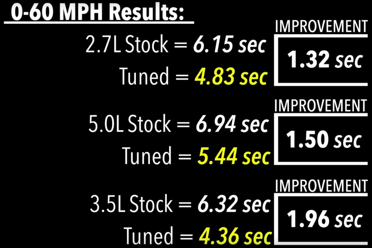

I saw this yesterday - this is a screen capture from a TFLTruck video showing results of 0-60 drag races between a 2.7, 3.5 EB and a 5 liter V8, both before and after tuning. The results surprised me, but it shows how amazing these EcoBoost engines are:
