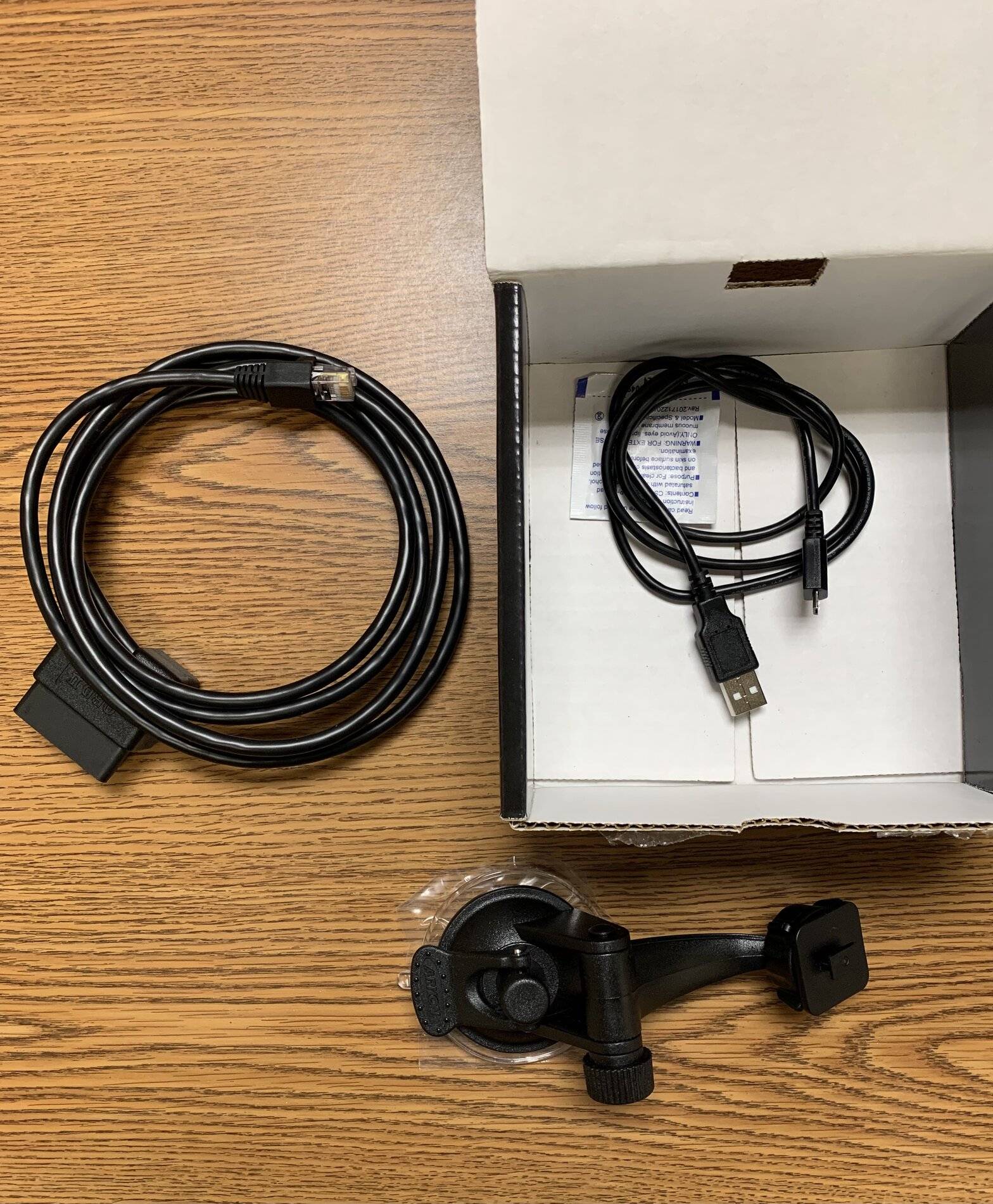

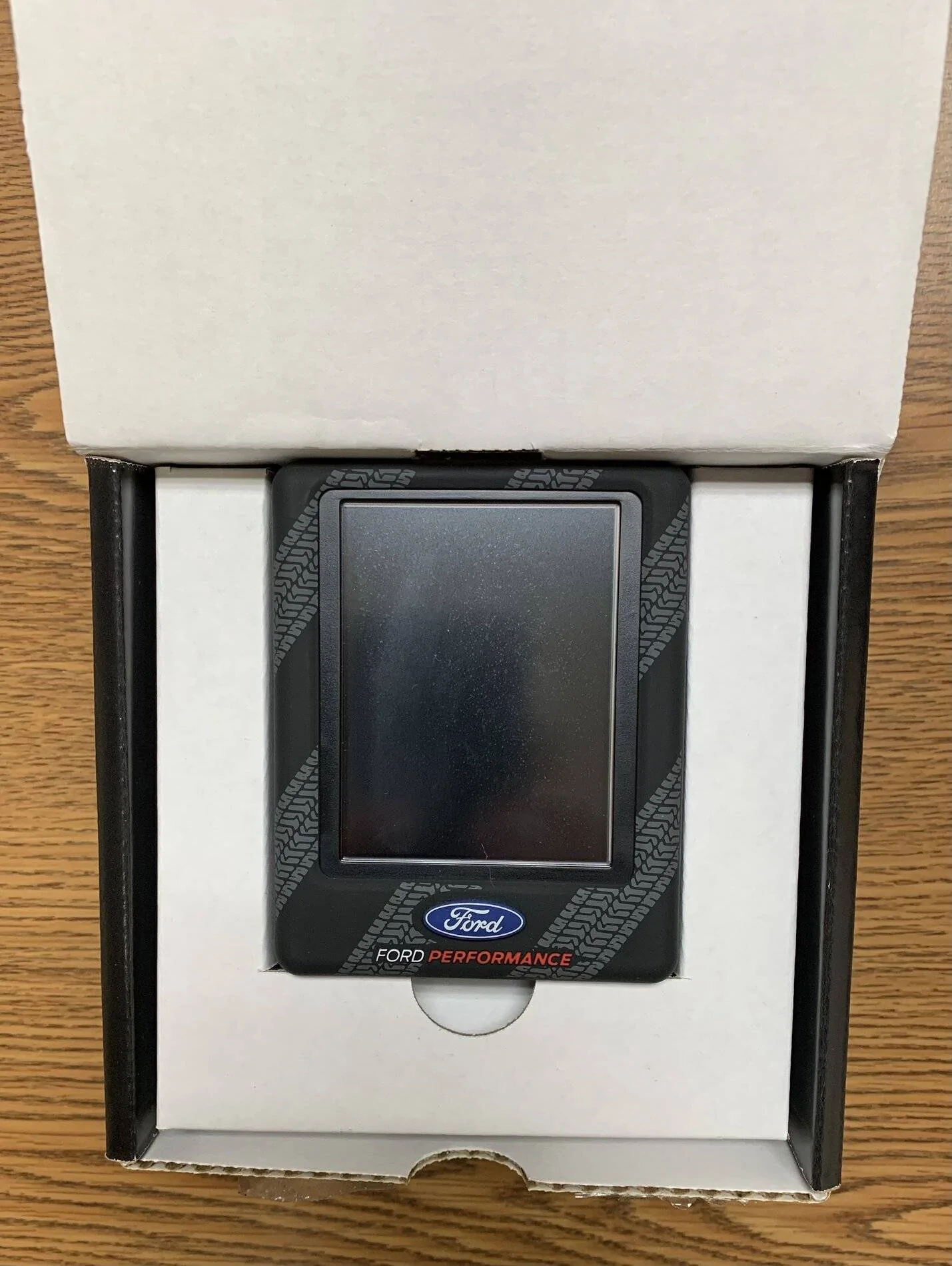

I found a ProCal in my truck when I bought it used about a week ago. I confirmed with my service department there is no tune on my truck. I don’t want to plug it in, no need since it has all the power I want or need.
I’ve heard “if” there is a tune on it that it may not read another truck if it was plugged into mine at one time. If there is no tune on it can someone use it and download a tune to it for a price? There’s no voucher slip in the box.
Is it worth anything as is?

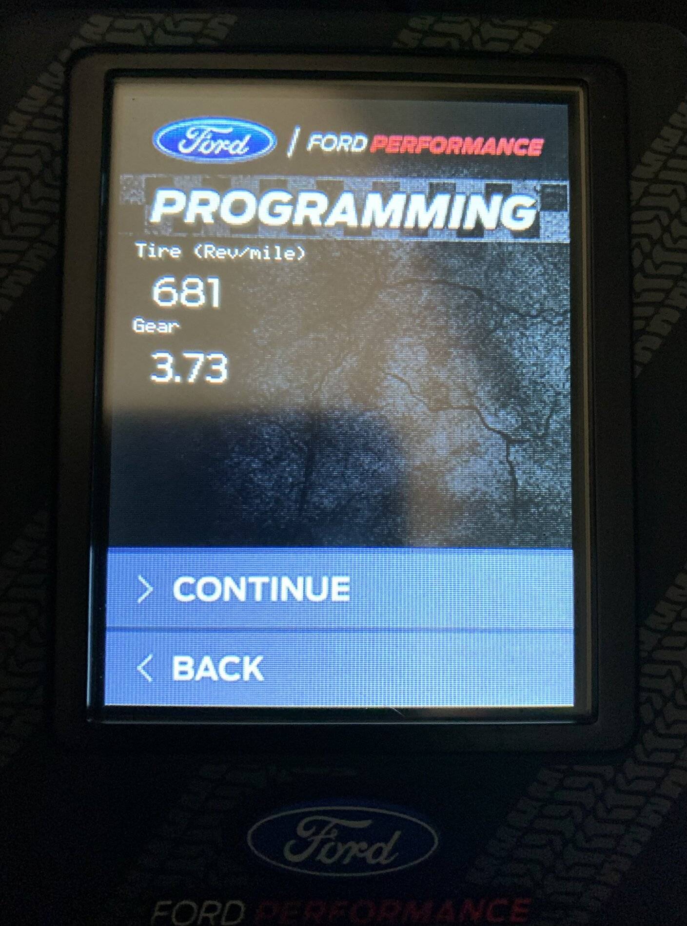

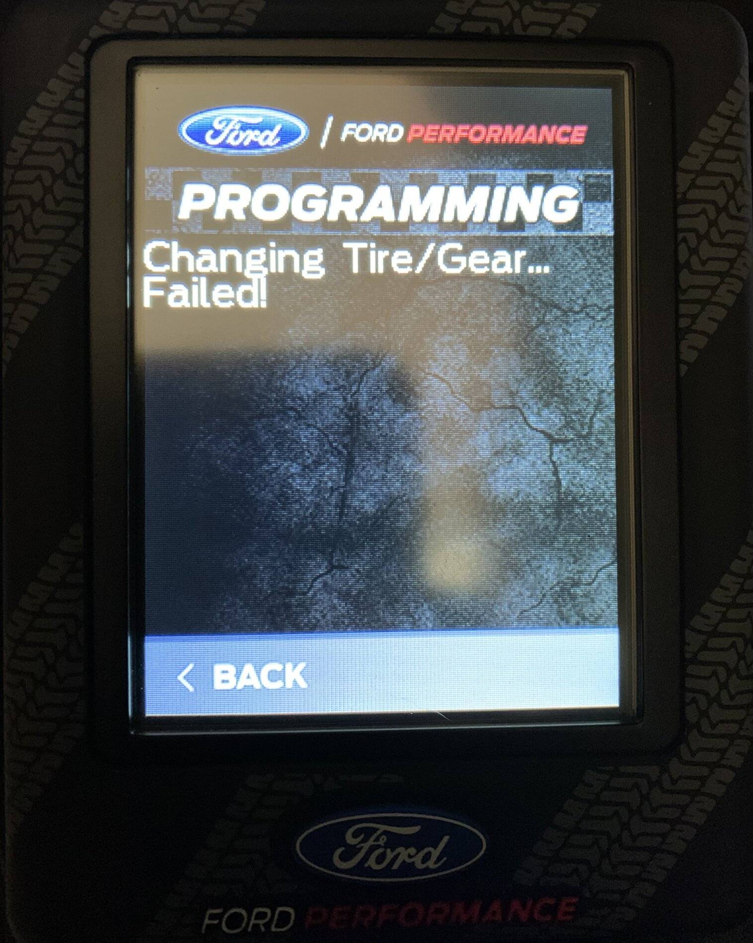

Okay, I plugged it in to see if I could change the tire size. Nope. According to tire calculator the factory size is 660 RPM. The new tires are 638 RPM. The ProCal says 681??
