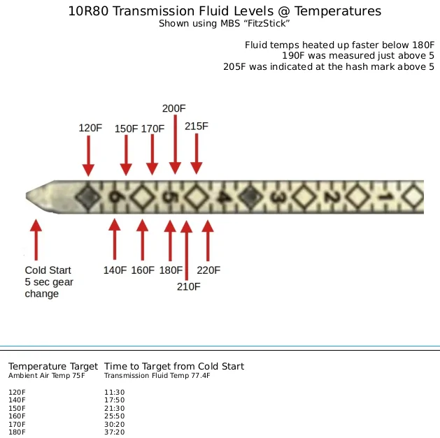

That was exactly my concern. And I did overfill the first time following the Official Ford procedure.
Honestly. Ford wasn't specific about their definitions. They did not define "cold" by supplying a temperature range that they consider "cold", or a runtime range from starting the engine.
I can tell you that it is not start the engine, run through the gears at 5 second intervals, then fill to hatch area up to 6!
If you do this you will end up a segment above the fill level, between 3 and 4, and very near the top of 3 if you fill to 6 when in the temp window of 206F-215F.
I know this because did just that.
If you start your truck and let it run from between 12 - 17 minutes, running through the gears once, from park to sport and back to park at 5 second intervals, the "lower hash mark - 6" range on the dipstick works. But the timing range is a hard and fast range. You must check the dipstick within that time frame. 12 minutes is at the lower hash mark, 17 minutes is going to be at 6.
I prefer to check it within a minute of starting the truck. I run through the gears just like above, and immediately check the fluid level. The correct level with be the fluid just touching the Fitzstick up to 1/8" up the stick. The longer you wait the higher the fluid will climb up the dipstick.
The chart below was created after i had filled the transmission to the diamond between 4 and 5 at 215F. Every point on the Fitzstick has the exact same fluid level in the transmission, just at different running times and temperatures. The engine runtime to hit those temps is in the chart below the dipstick.
Note that the runtime chart only goes to 180F. It is because I had to let the truck cool overnight and the time needed to get above 180F was becoming a bit long. The temps above 180F were taken on the way down from 235F after overshooting the 215F due to power braking the engine to raise the transmission temps. I went back to idle at 210F but transmission temps continued toclimb to 235F, then slowly dropped.
I measured at 10F increments using the Ford transmission fluid temp sensor through my xTools D8 Bi-Directional Scanner.
9,228

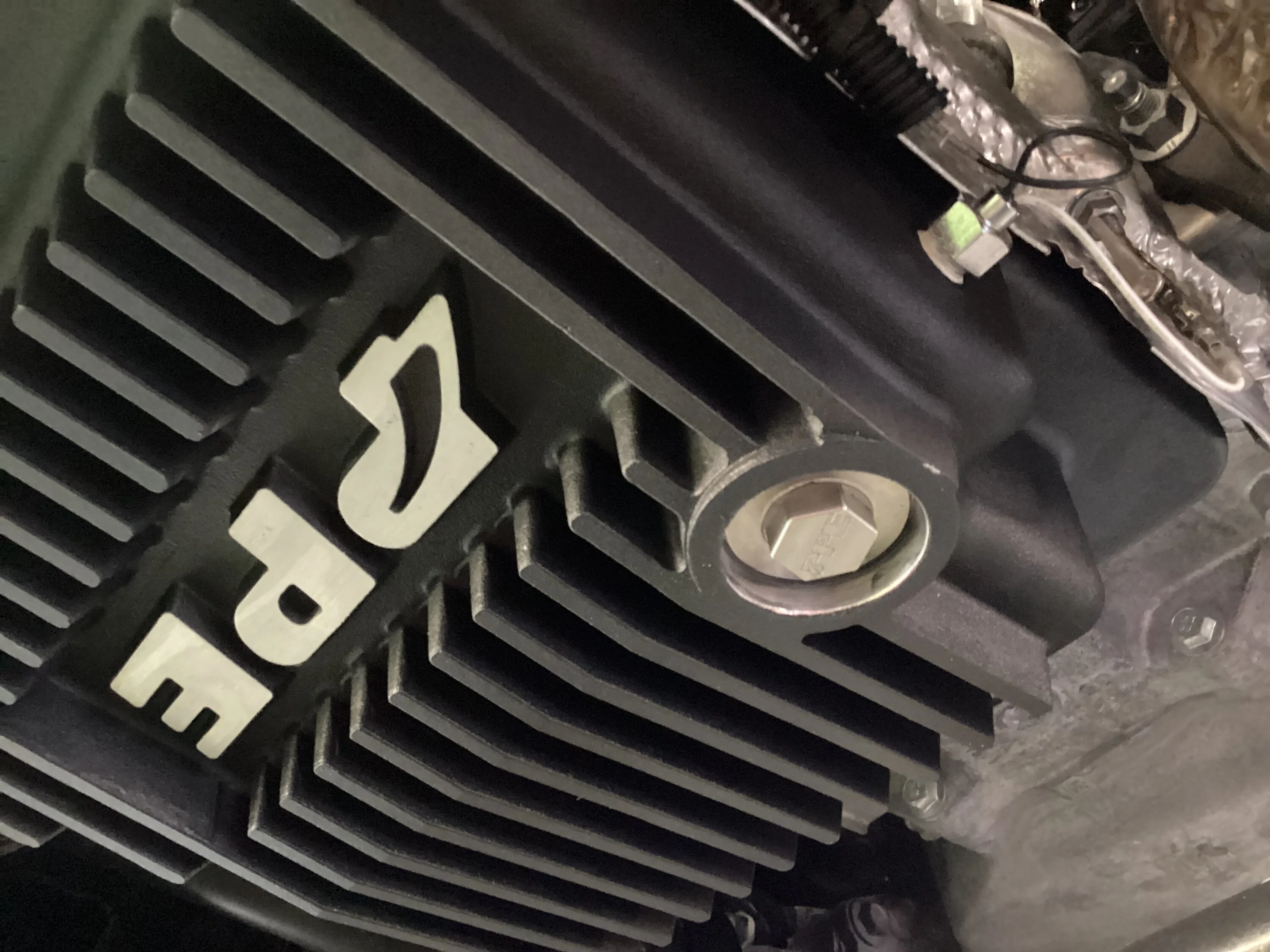

DIY.
Add the fitzstick, drain the trans, drop pan, replace filter, refill, done and you're set for an easy drain and fill next time with a better pan
Reinstalling the pan would be a great idea...before the refill...

IMO, by FAR, the hardest part of the job is making sure the fluid level is correct. This is the primary reason why the FitzStick is almost required in order to do this job. Even with it, it is still difficult to get the correct parameters to make sure it is correct. It is REALLY easy to under fill or overfill this trans - and it definitely does not like to be overfilled.
With that said, it isn't really all that difficult to do. The first time, dropping the pan can be a bit messy, but if you replace the pan with one that has a drain plug, future drain/fills will be a lot cleaner - a lot more like an oil change.
