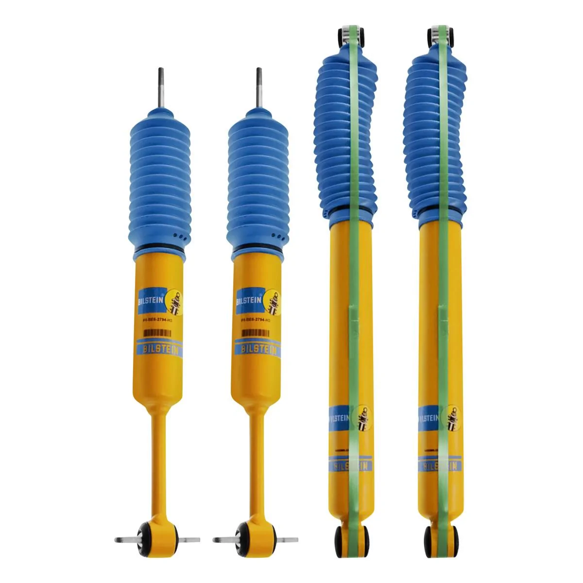

As previously noted, I paid my favorite shop to replace all four shock absorbers/struts with Bilstein 4600s, along with the requisite 4 wheel alignment. Not cheap but highly recommended. Driving to my daughter's home in the next several weeks to see how the 4600s handle the rough, unpaved roads around her area. Huge improvement on 'normal'(?) roads. $985 total out of pocket. Stock image.
Great Choice! I've had those on every truck I've owned since the '80's when I bought a new Chevy S10 4x4 that came stock with them. Yep, I've that old. LOL
They are a great shock for all around on and offroad driving. People here tend to favor the Fox stuff but I've never had any Fox product's so I don't know what I may or may not be missing. But I do know Bilstein and I'm a big fan.
